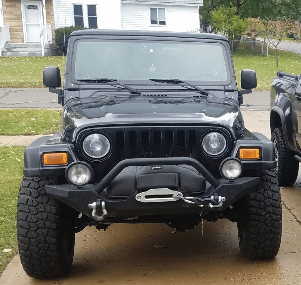

Cover, what does it hurt? It’s garaged, not 200” of rain/year. You’ll be fine. I cover mine
Probably just as dry as an umbrella would keep you dry if you jumped in a pool, I bet it does great for UV, but my steel cable soaks up the rays just fine. I bet your cover looks nice though.

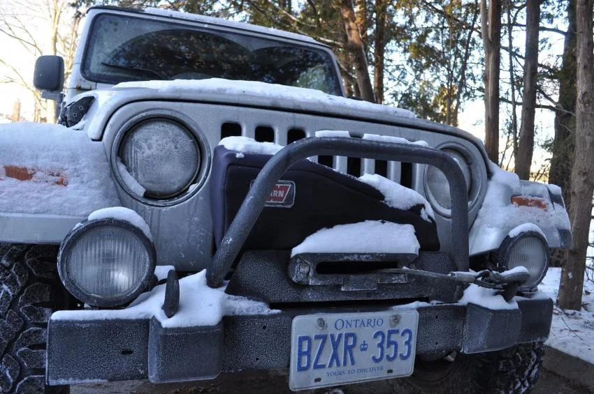

Covered in the winter and off for the rest of the year.
