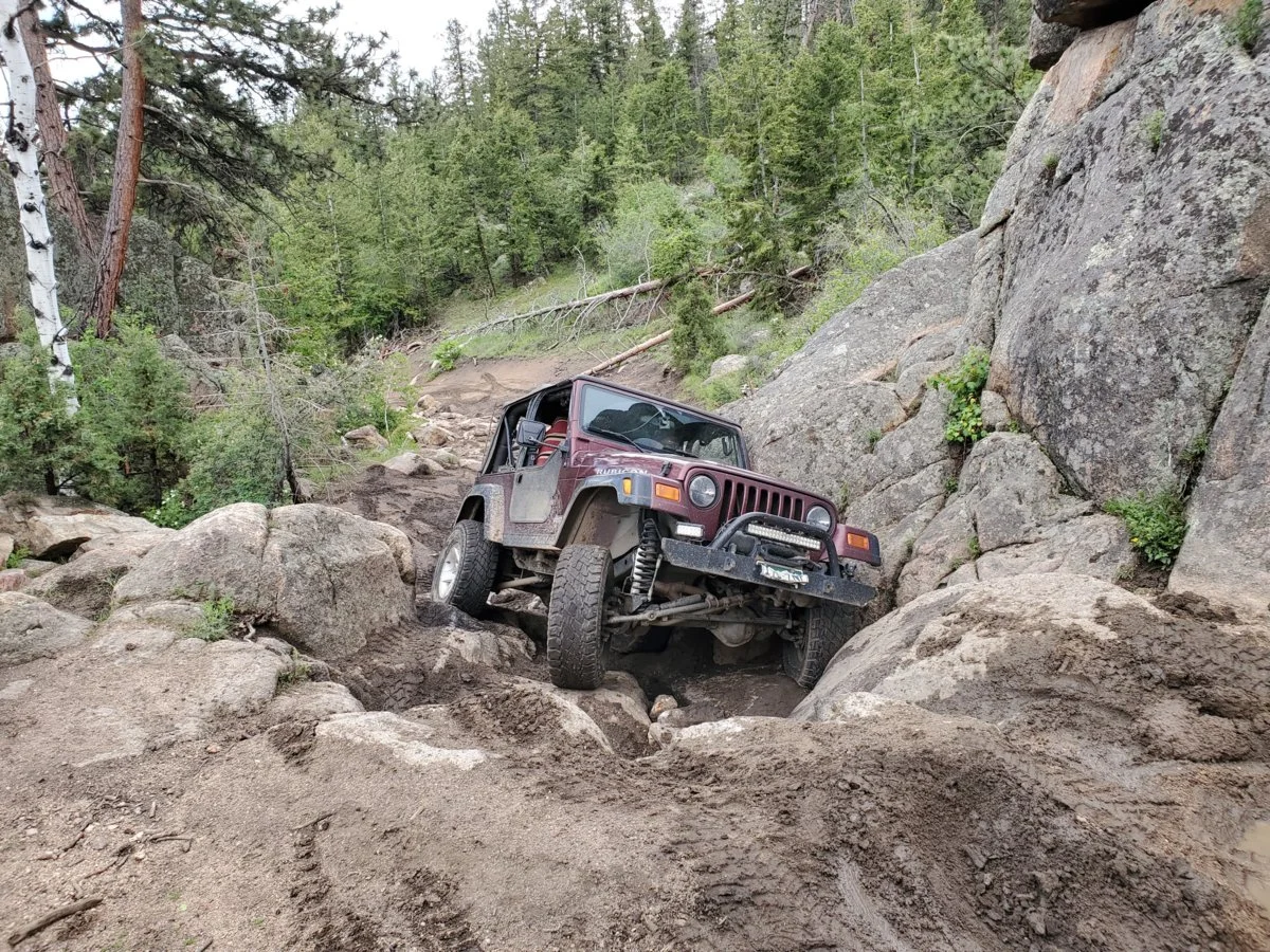

Recently, on my first outing with the new stubby bumper, I slipped somewhere in these rocks and caught the passenger fender for the first time in 6 years.
The old bumper was wider, got in the way a lot, and it protected the fenders.
I think if you are in a place where a stubby bumper is a real performance benefit, it will expose other areas that will need to follow suit.
