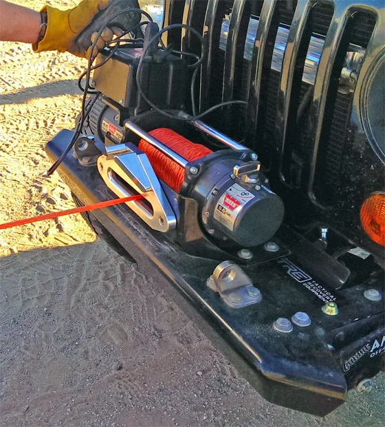

Anybody got a list of weights for these bumpers? I'm down to Savvy vs Warn stubby and would be interested in that info.
My guess is that my Body Armor bumper is heavier than both being that it's fully boxed, full length with a winch guard hoop, hitch receiver and another run of tube under that. I'd like to lighten up a bit.
Savvy's is aluminum, it'd be lighter than Warn's steel bumper. I love my Savvy front bumper.
I run Body Armor bumpers, there isn't really anything else that weighs as much. It easily weighs twice any of the bumpers mentioned on this thread. They make one with an additional hoop that protects the hood and it is even more absurdly heavy. There is probably no other bumper as heavy, at least none I've seen. The rear bumper has large sections that are made of 3/8" steel plate. The front is probably similar. You could probably shed 50lbs with any of these. Be prepared to change front springs.
Yeah, and it looks really well made. Just curious how much difference the material makes. By the time they're similarly equipped the price difference is about $100 and the Savvy will still need paint. Ten pounds isn't worth that much for me. 30 lbs might be.
That's what I figured. They look heavy as hell. I broke a mounting bolt off in the rear passenger side because some A hole had cross threaded it prior to my ownership, so I want to change that one out for peace of mind, too. And I'm just not a fan of all the stuff going on with the extra hoops and the separate, raised winch mount. The winch covers dang near the entire grill.
Getting more lift out of the springs is most of the point. I don't know who made them or what they're supposed to be but right now it sits about 2.5-2.75" over stock. I intend to revamp my suspension next year with 4" Currie springs and rs5000x shocks of appropriate length anyway.
There is more going on with the Savvy than just a weight savings.
Reactions: Jerry Bransford
I'm all ears. Or eyes, as it were.
Start by counting the frame attachment points. Savvy connects to the old sway bar mounting holes. This allows the deck to be larger which adds a lot of strength to the frame by becoming a large gusset. The winch itself can be moved further back on the deck, which looks nice. And the underside of the bumper is braced against the crossmember tube adding a tremendous amount of rigidity to the bumper.
Whatever is going on at Savvy I don't care, UCF makes the same thing for $100 less and Matt actually answers your questions and ships his products.
Is UCF the same as what I just described?
-edit-
I just looked. They are not the same bumper. Not at all.
Good to hear that Matt answers your questions and ships his products. That doesn't change what his less expensive bumper is.
-edit-
You're right, it is quite different. Well under 20lbs so there isn't much there. The do look a bit alike.
The stubby bumper in my pic earlier in this thread looks very much like a MotoBilt stubby. But after a great amount of effort it is about as similar as Savvy is to UCF. Most of what makes it different is not readily seen.
