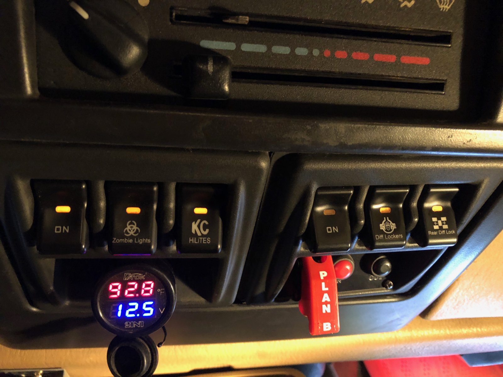

I have my winch wired in my dash. I do have a toggle that I have to click on, and two push buttons for in and out. My aux battery is wired straight to the winch with no interruptions.
You can see it here it is the "Plan B" switch and the two buttons next to it are the in and out:
I did the same.
@FadeToGray 12voltguy sells great in cab switches.
