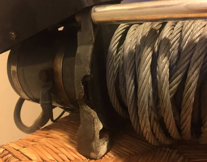

I thought the price was good too. Also, @Jerry Bransford , I found this M8000 for $200, it's 100% working but has some damage. What do you think of this damage?
The good news is you can get a replacement for that busted side plate from Warn. Whether you want to have to tear the winch down to replace it is up to you. I think I'd offer $100 and make a big deal out of the required repair and if he was firm on $200 keep looking.
Edit: We didn't get lucky... I have a brand-new spare side plate for my previous Warn winch (the one that was on my stolen Jeep) but it's the right side plate, not the left side that you need. I would have given it to you for free. Dang it. :(
Thanks for the advice.
