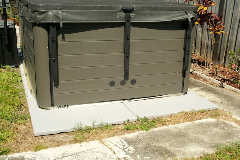

Tried to use my winch to move an empty swim spa. Like my wife said, "Epic FAIL"!
Line to spa. Combination of a tow strap, a tree saver, and a Harbor Freight tyedown strap (!!) employed around the thing.
Strap low against the bottom structure.

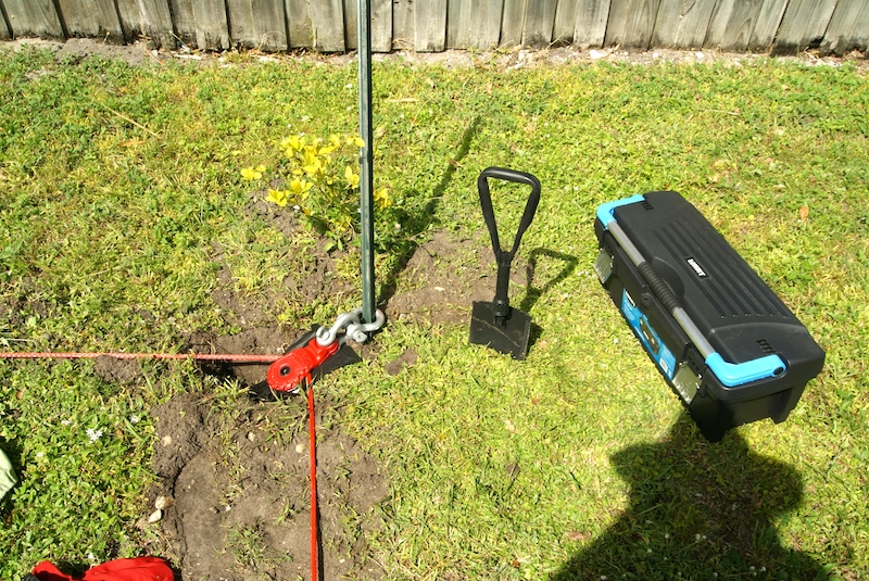

This fence post was my undoing...

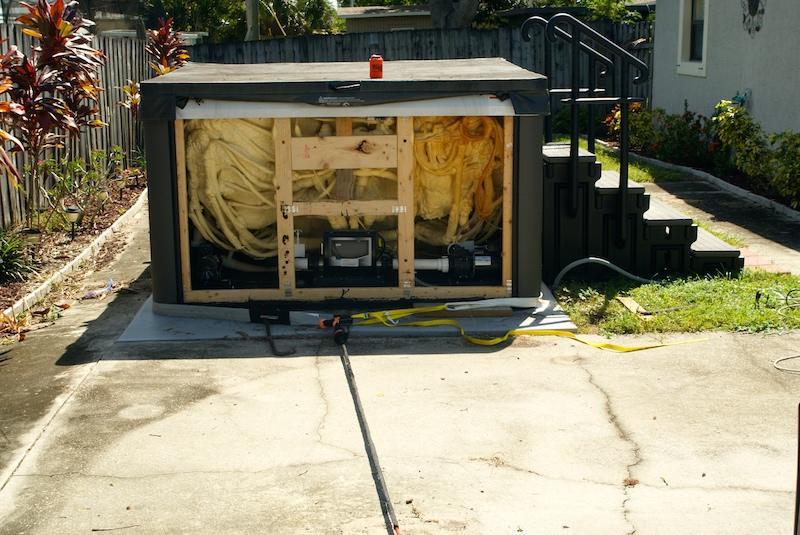

Line to Jeep
Line to spa...

Try #3! All it did was bend the shit out of the fencepost...
Even though this failed, it was a good learning experience as I used EVERYTHING in my recovery kit. The tow strap, the tree saver, two soft shackles, two clevises, my snatch block, my TRE Coozie, and even my e-tool to dig around the fence post to remove it from the ground.
This should have worked famously, it didn't because the fence post wasn't even CLOSE to strong enough. I'm guesstimating the spa weights in the 500 to 600 lb range empty. 3 guys put it in where it is, they used rollers to roll it across the lawn, and once it was on the plastic substrate, they slid it around like it weighed nothing. I figured I could move it by hand the same way, but not even my burly son-in-law and I could get it to budge - hence the winching attempt. Its like it has glued itself to the plastic panels its sitting on.

1) I'm certainly open to critique of anything I may have been doing wrong, unsafely, or sub-optimally. Yes, that is a Harbor Freight tye-down you see as I didn't have quite the length with the tow strap and tree saver combined (coupled with a soft shackle). I wasn't able to stress test the lashup fully due to the bending fence post!
2) Son in law and I are going to try something completely different tomorrow - but what could I have used as an anchor at the snatch block that would have held up to the strain?

As soon as I saw the 'fence post' I knew what would happen, those will just not stand the stress. And you're not pulling 500lbs (the weight of the tub) you're pulling against the friction created by the 500lbs pushing the bottom of the tub down onto the surface it is sitting on.
I can't speak to what the bottom looks like (is it smooth? wood? are there any lips?) but even if it is all smooth the concrete is rough and time will have sort of glued them together a bit.

Good points. The bottom of the spa is wood framing, and its sitting on plastic pads that are QUITE slick. Don't know why its glued like it is. I sure wish I had a tree to use as an anchor - but I gots nothin'!
Son in law came up with tomorrow's idea: We're going to screw some additional wood onto the open end's framing (we're worried about overstressing the wood frame of the thing), use a hydraulic jack to jack it up enough to get rollers under it, then push the sumbitch by hand.

T posts are made from butter you can bend them by hand.

If you have more of the T posts, set two next to each other with about 18" exposed. Move back 3 feet and set another one. Tie a strong line off to the top of the pair down to ground level on the next one. It should be exactly opposite the bending force, so about a 45 degree angle to the pair of lines going through the snatch block. Repeat that with one more post and that should give you enough of an anchor to do what you need.
Thanx for this. I was wondering what I could do if I had more posts. I don't at the moment, but another pair would be easy and cheap enough to come up with. I'll see if son-in-law's "jack and roll" plan works tomorrow, but I'll hold this in reserve.
