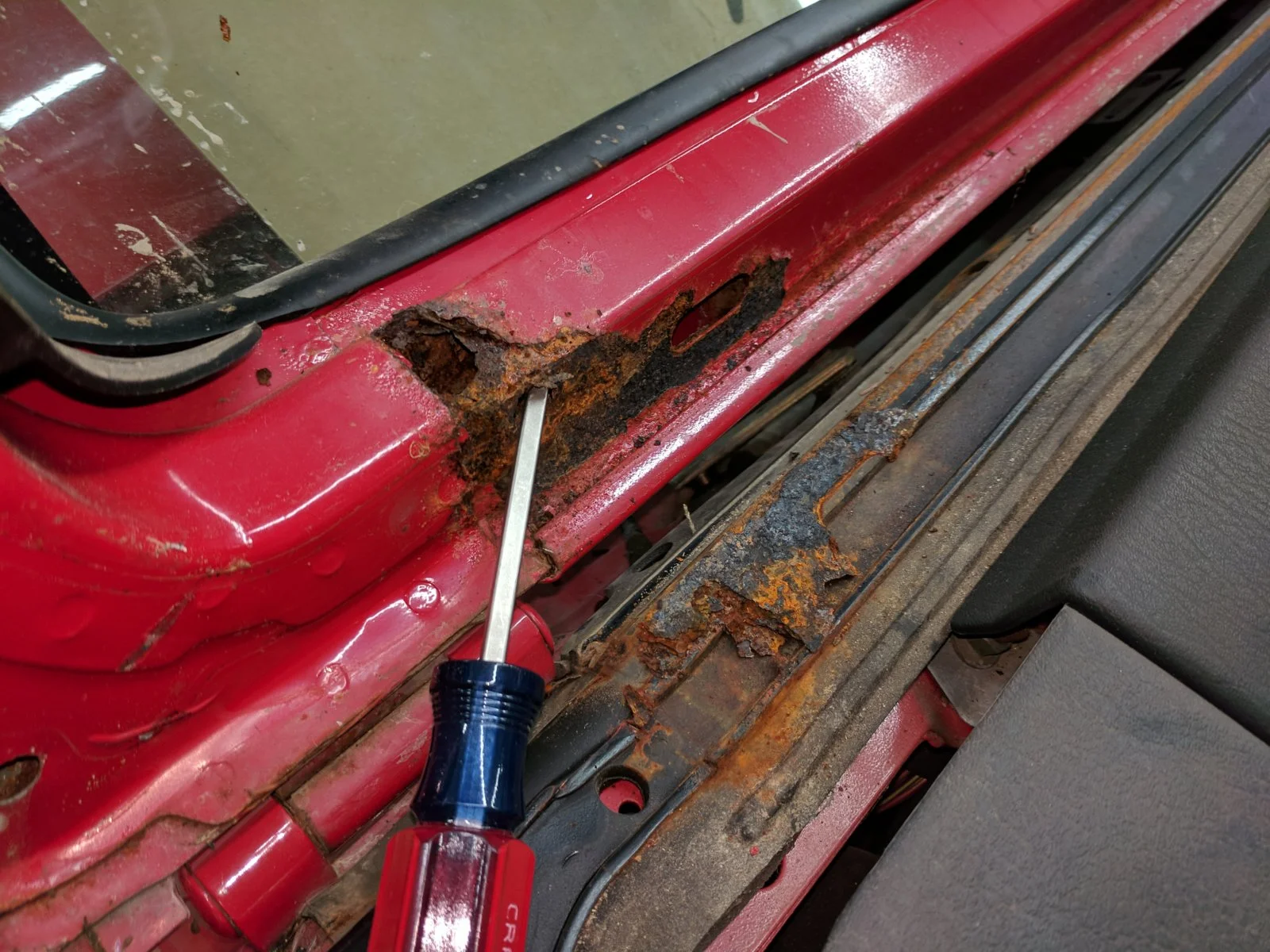

I folded the windshield down to expose a rust problem that I kinda knew I'd find.
Has anyone had success with the repair kits or should I bite the bullet and buy a new frame?

How much can you find a new frame for? That would be the determining factor for me. It a new frame is cheap enough, it’s more cost effective to just buy a new frame. I am of course counting time as labor, and therefore of some value.

Is that area very visible? Will a repair be an eyesore? Do the windshield frames rot out from the inside just like the frames do on TJ’s? If you don’t foresee any more problems with that windshield frame in the future, it’d seem like cutting out that section of the windshield frame and welding / using seam sealer to put a new piece of steel in would be a good enough repair that wouldn’t take a lot of time or money to do.
$585 for a clean red OEM frame on eBay. $79 for the repair kit + time + paint.
That's what the repair kit looks to be. It did rust from the inside out. The other side is rusted but not as bad. There's no place for the water to drain since the seal holds it in.

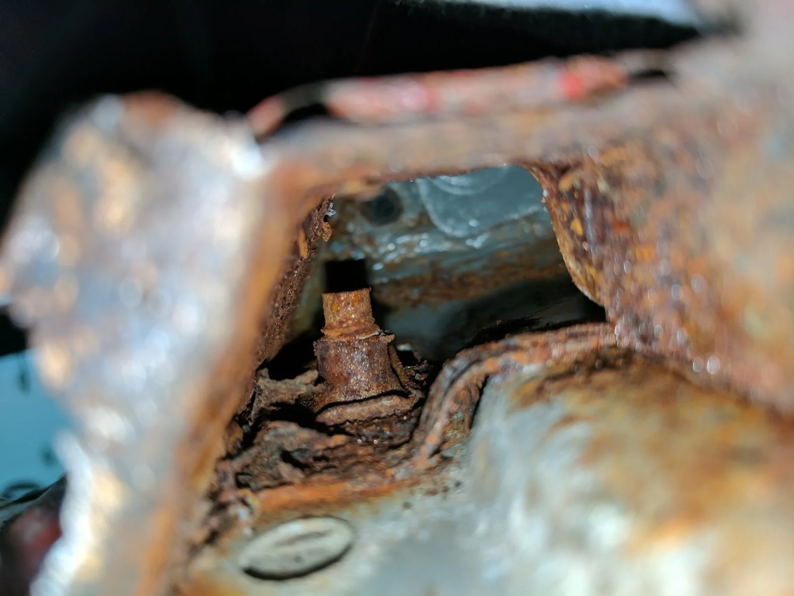

Are there rust inside the corners of the frame? The area that that new piece doesn't replace?
That might be the determining factor for me. I don't know what the rest of that frame looks like inside of it.
That's a good point. What I can see looks fairly clean at least nothing a little sanding and paint couldn't fix. I'd have to cut it open to be sure.
That's where I would start. Cut it open and go from there. If there's rust all over the inside, that would be the tipping point for me to just buy a new windshield frame.

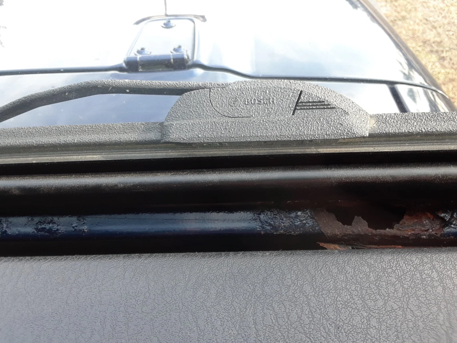

KCsTJ
TJ student
@KCsTJ here is a thread for you to follow.
Thanks @b0xcar , yes I am following closely because I found this little surprise after I bought my 05 Sport. It was very well hidden.
It was painted over. I found it while wiping off some dust after wheeling.
My finger went right thru.... ugh
Apparently a bad seal, and for a long time no doubt. :-/

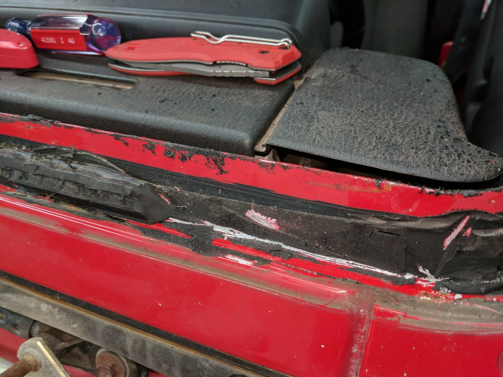

A friend who used to repair glass stopped over and helped me remove the glass. Unfortunately, we had to use a knife to cut through the urethane which also scratched the paint around the window. With the window out I can see that there's no way the water entered around the glass. I haven't figured out yet how the water entered the frame.

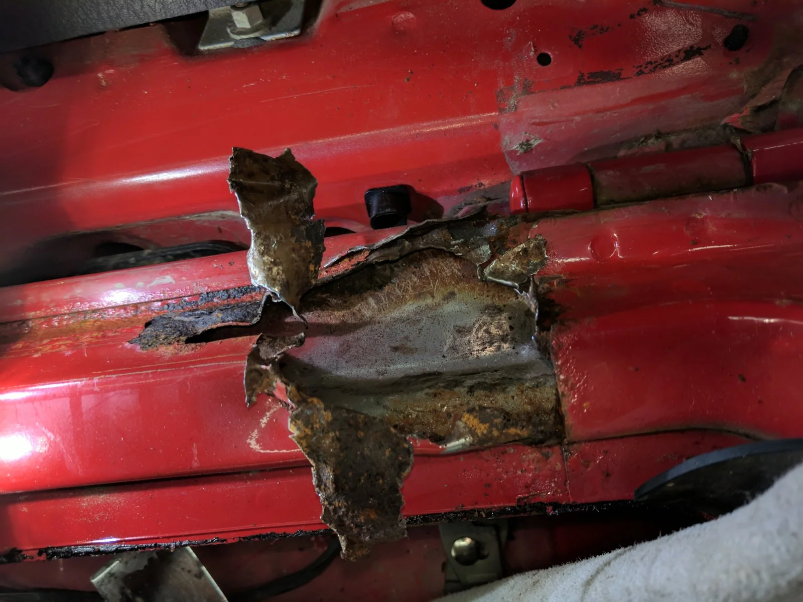

I opened it up and the metal is decent except for this one spot.
Here's a picture into the corner:
Yes, there is rust. However I don't see the need to replace the entire frame just yet and pay a lot for the part. I'm going to clean it up and bandaid the windshield frame together to buy more time and keep my eye open for a new one. To make things even easier on me I'll probably just paint it right on the Jeep too.
I might take a look at metal brakes so I can bend up my own repair piece.
