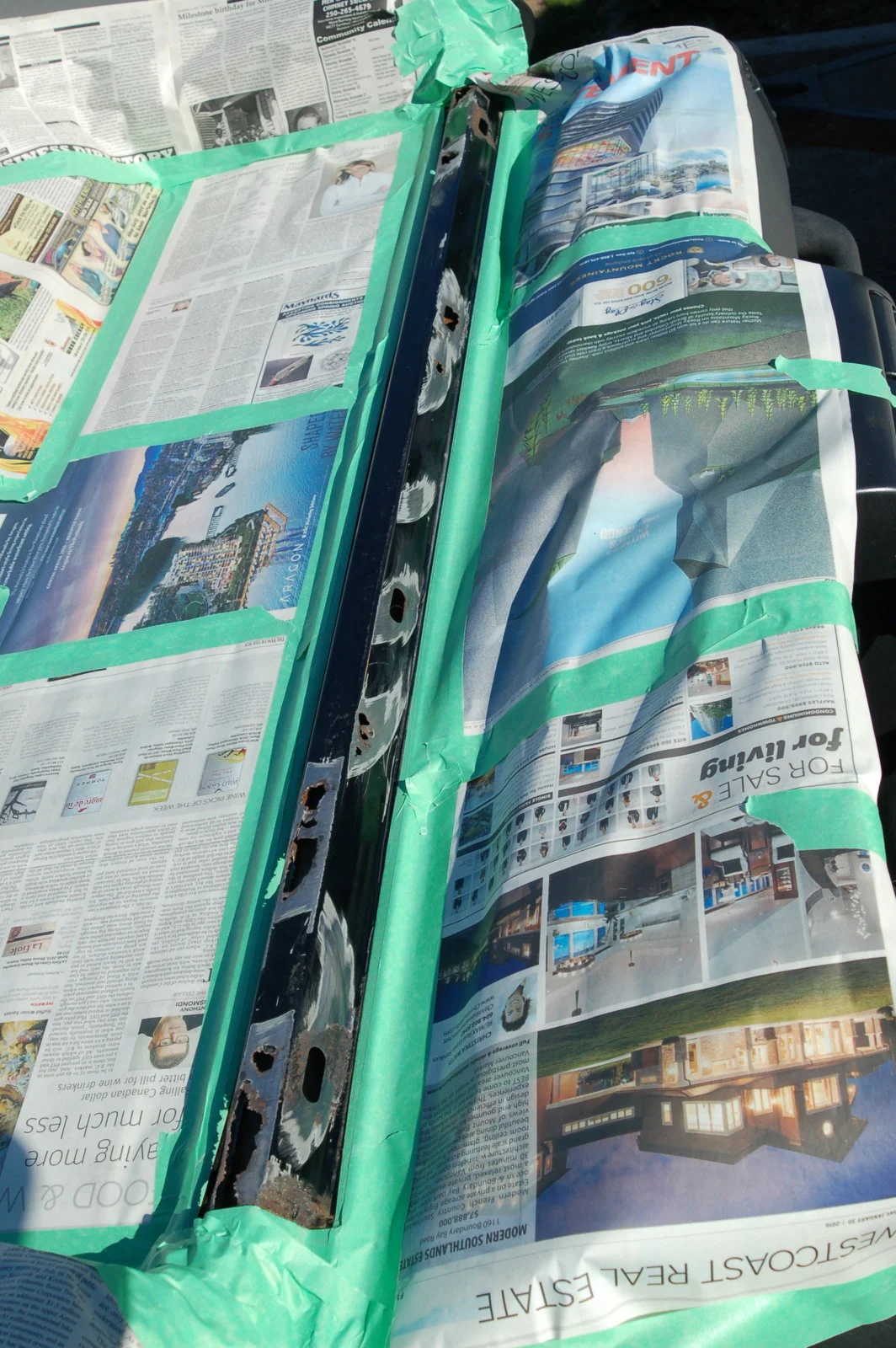

I have the same issue, I cleaned it up, painted it 2 years ago. It looks awful when you flip the windshield but i doubt I'll spend any money on it as long as it remains structurally sound.
I'm thinking it is the location, right by the defroster vent which causes the problem by adding heat, a catalyst, to a damp, hidden area.
2 years later mine looks rusty again.

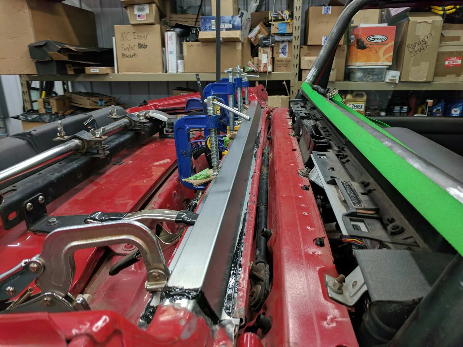

$585 for a clean red OEM frame on eBay. $79 for the repair kit + time + paint.
To come around nearly full circle on this repair, the cost to replace the glass is $379.77. So my total cost to date on the windshield is $460. I hope my repair holds up to make it worth it. I've been looking for a red windshield with good glass ever since the one I mentioned on eBay and none have turned up.
So the price point is close for sure. $125 in difference.
Yup. Had I known, I would have happily bought a clean frame for only $125 more and minimal work. Live and learn.
If you have the skill, tools, and glues to replace the glass, I'm sure you could do it cheaper, but I don't and I don't want to try and DIY it and have the glass fall out when I hit the first bump.
