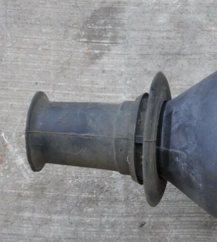

Looking for one of these. I know that a lot of folks have done the Windstar Air intake conversion on their TJs. I am doing one now but am missing this part. Anyone have one laying around?

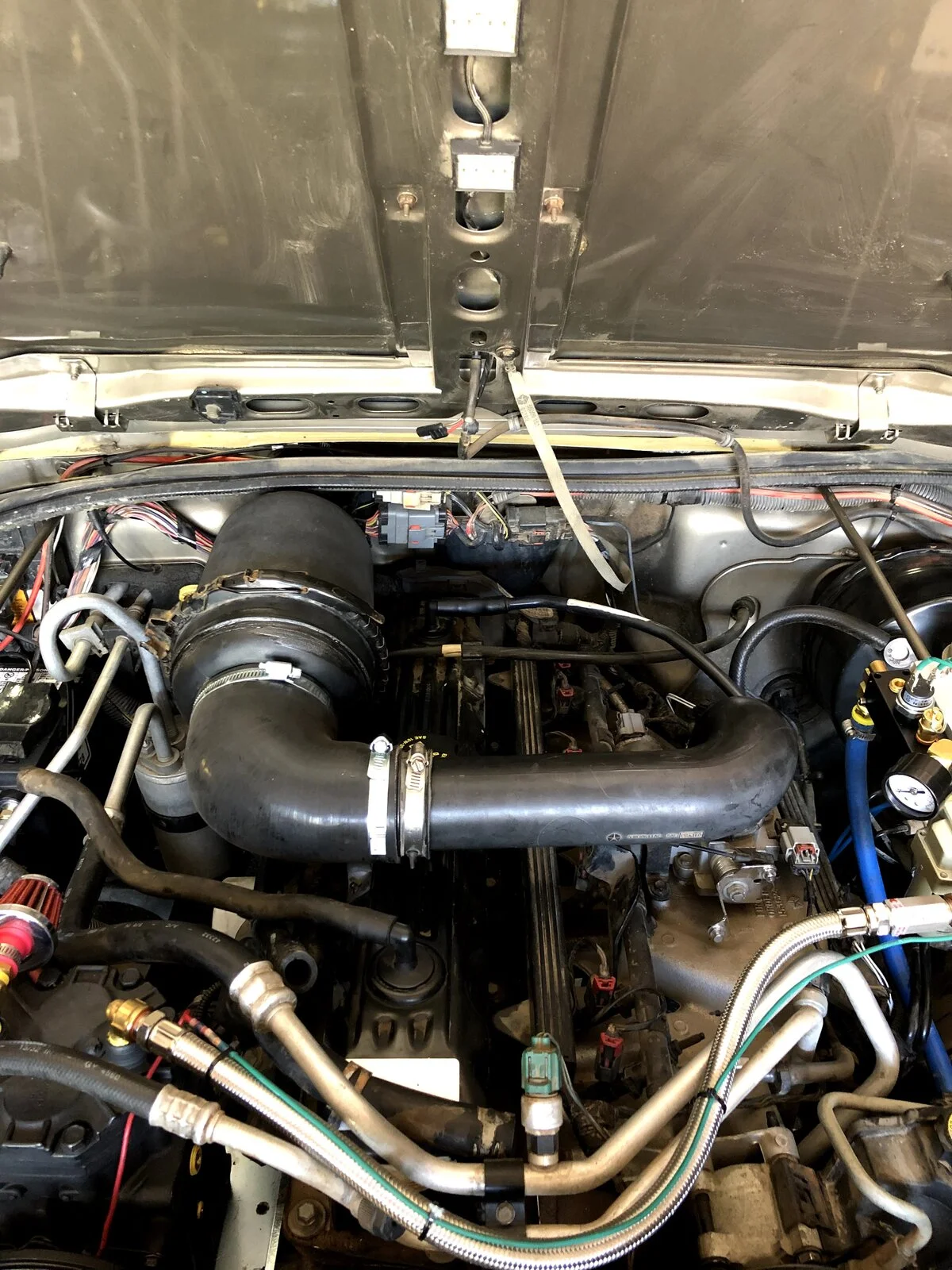

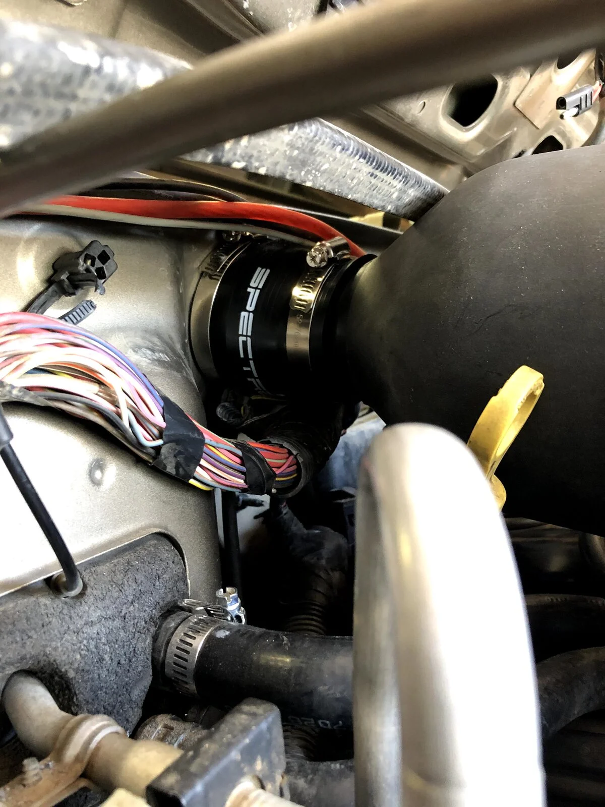

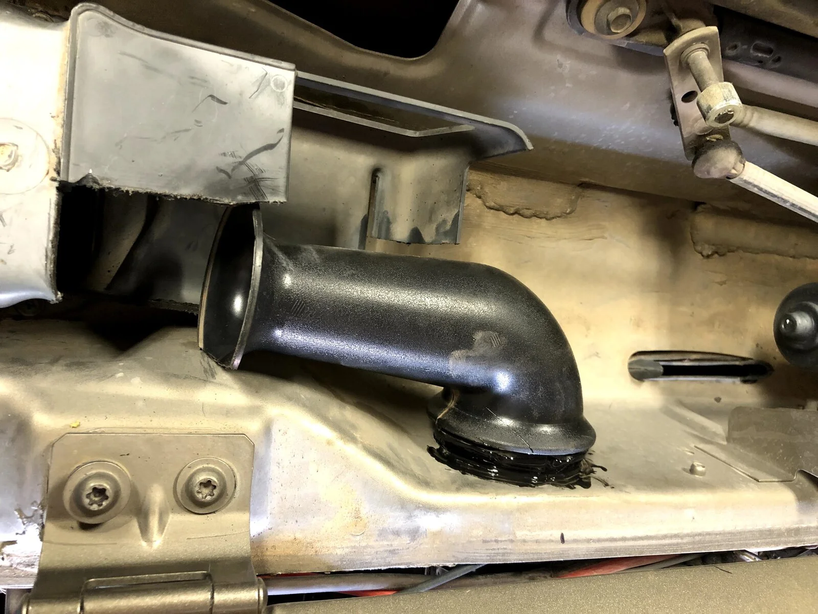

Yep. I still cut the 3" hole in the cowl but instead of using the Windstar horn, I removed the stock horn from the TJ, cut it down and adapted it to the Windstar Air Cleaner using a 3" to 2.5" rubber adapter. I then used from JB Weld plastic weld to further secure the horn to the cowl. Not necessary but helped give it a more solid anchor.
