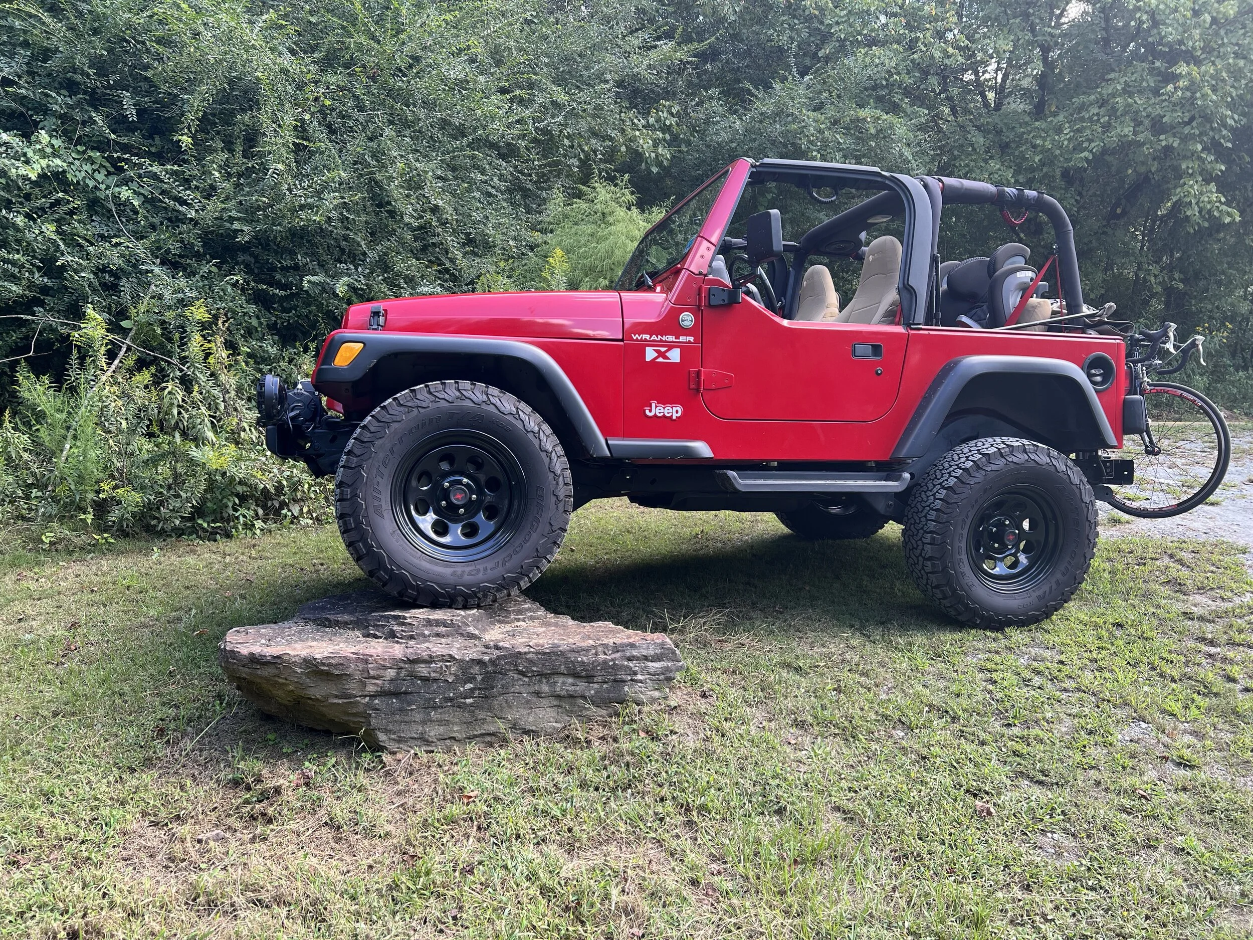

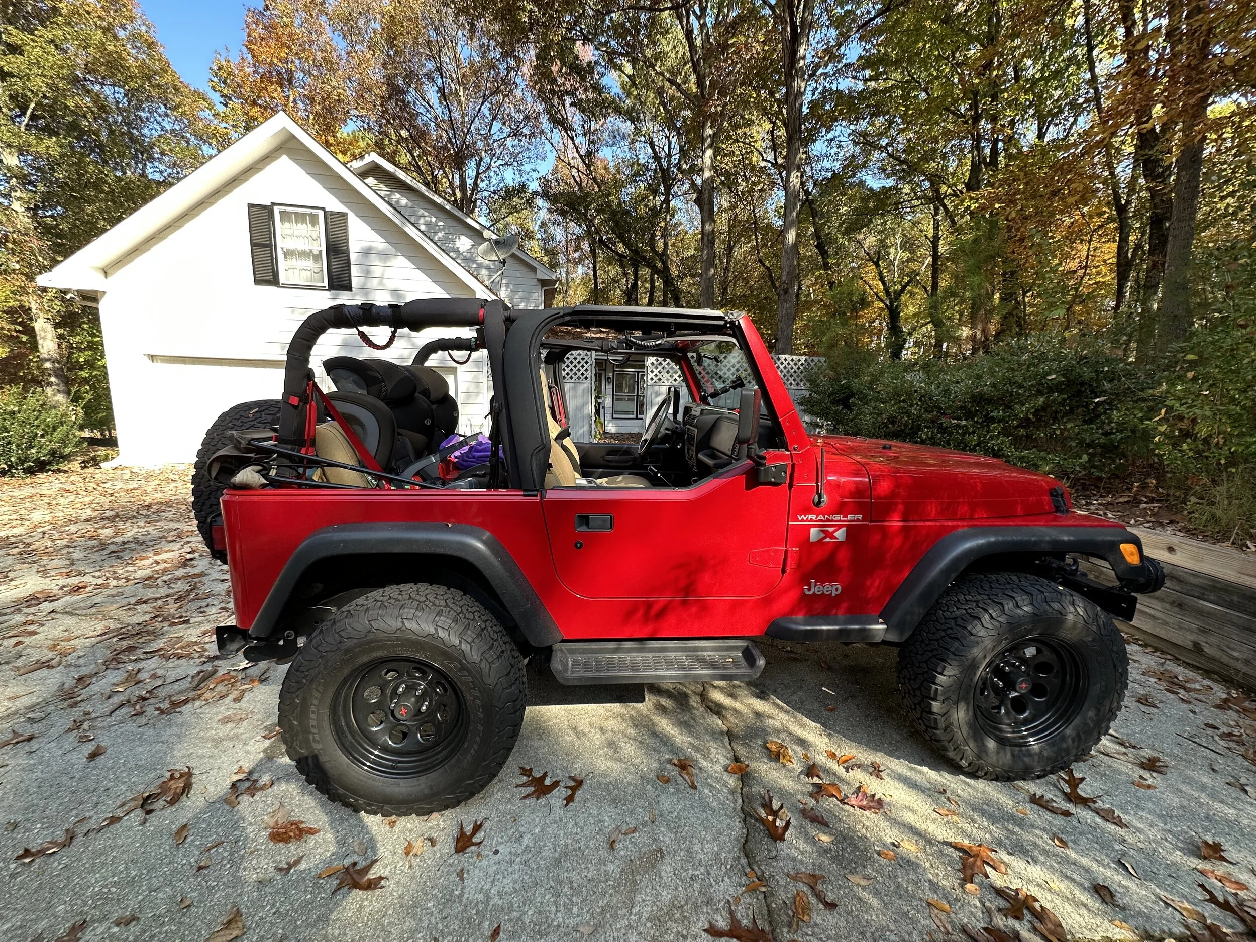

Winter project: 2" (2" rear 3" front?) lift

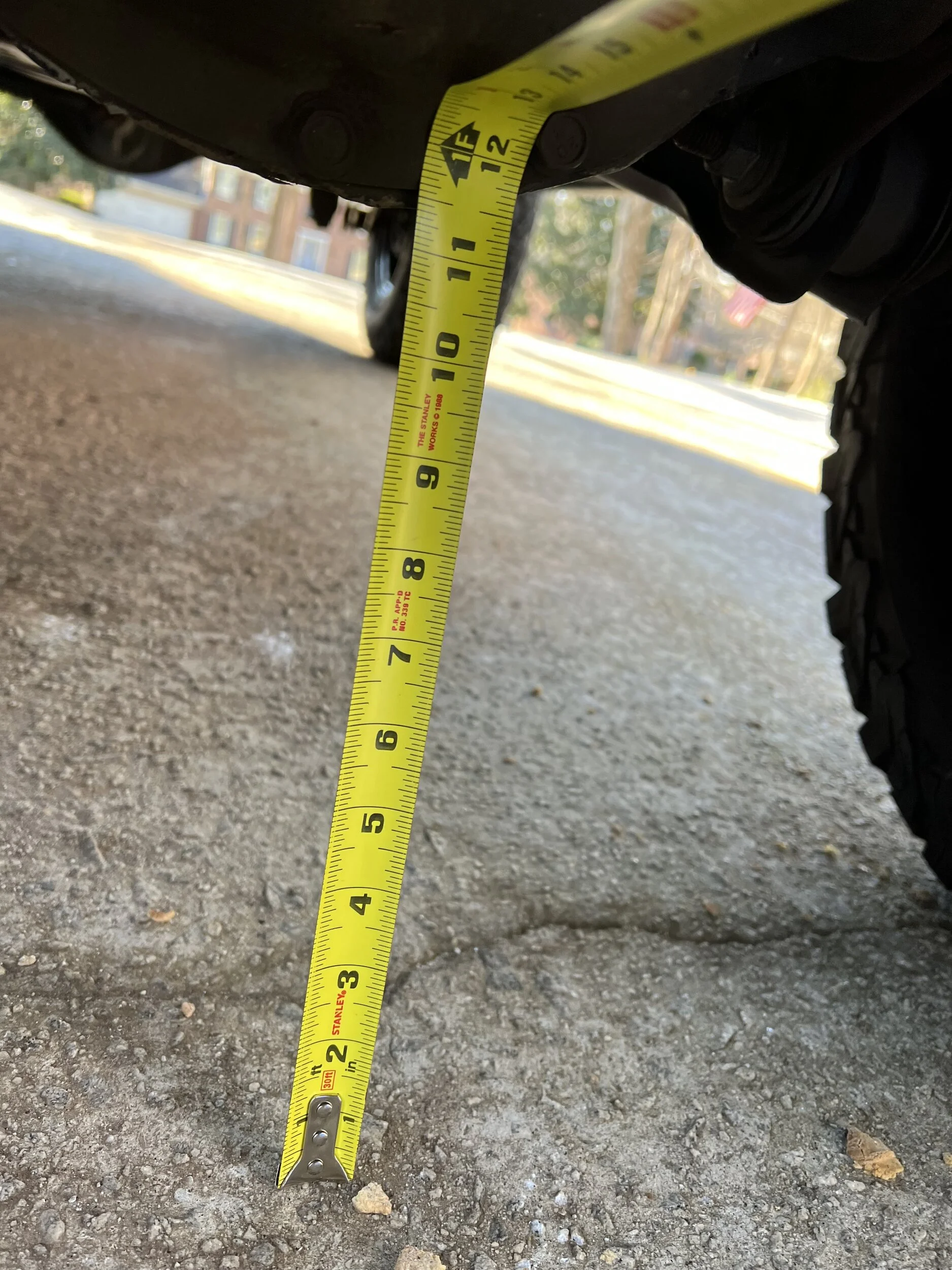

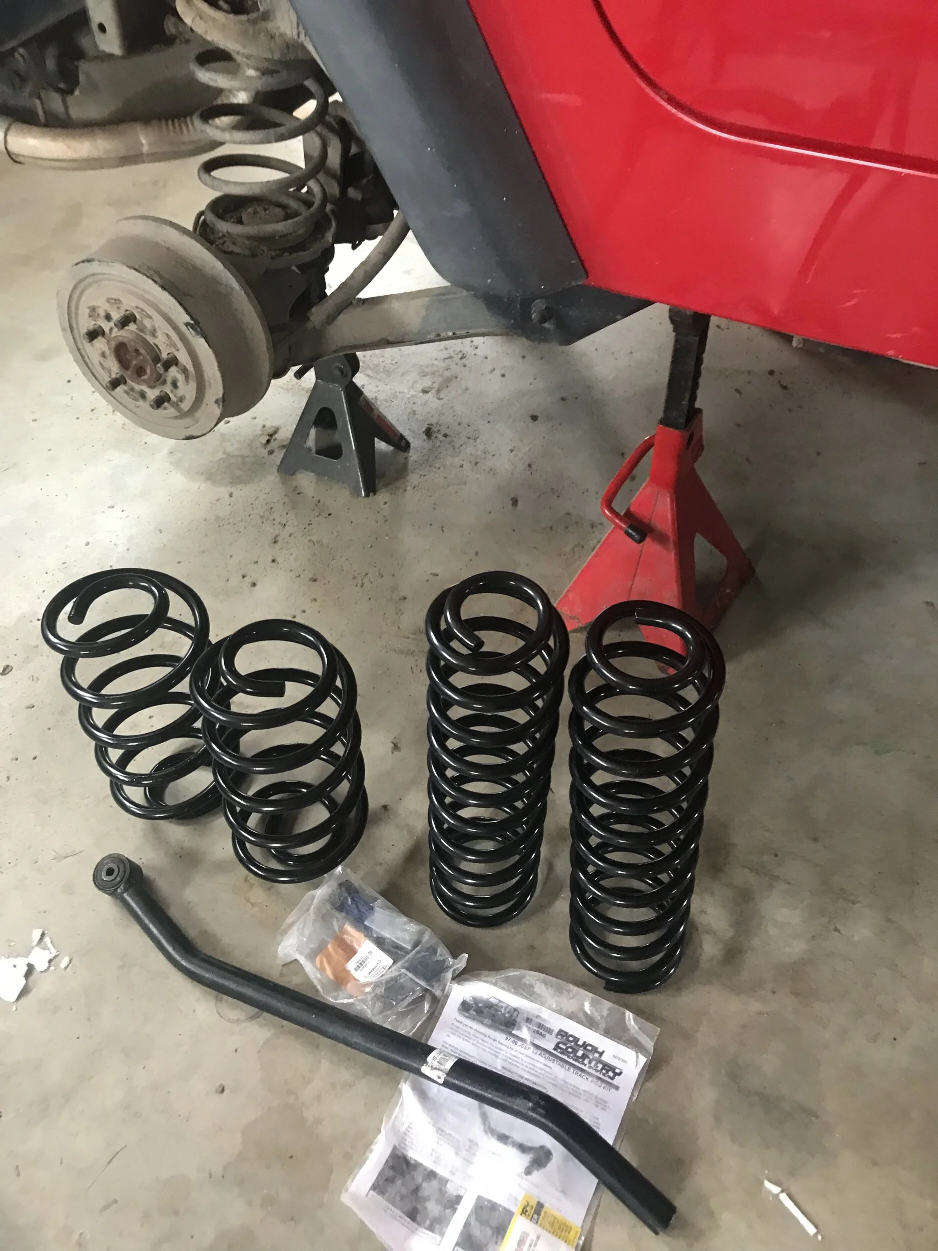

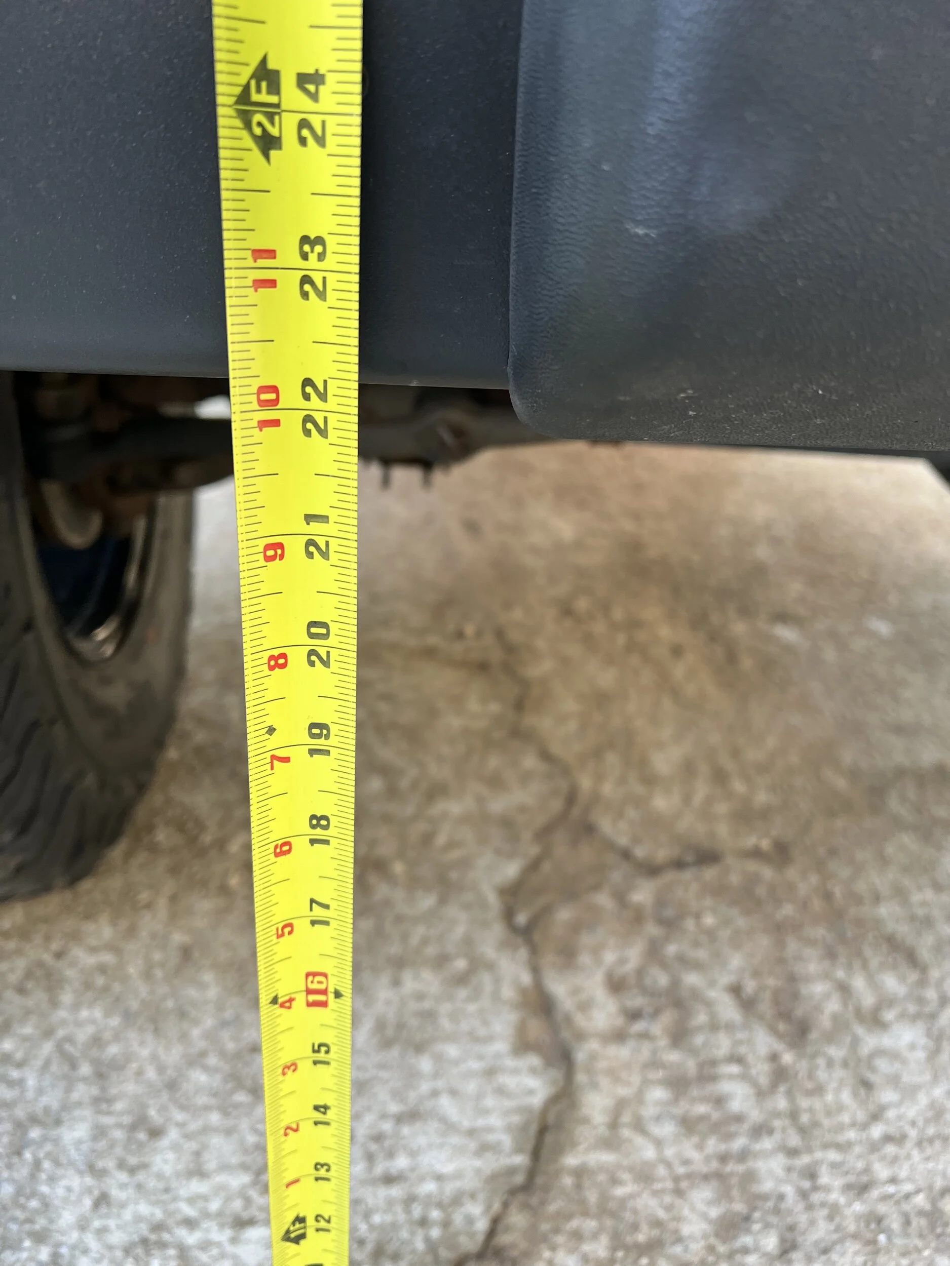

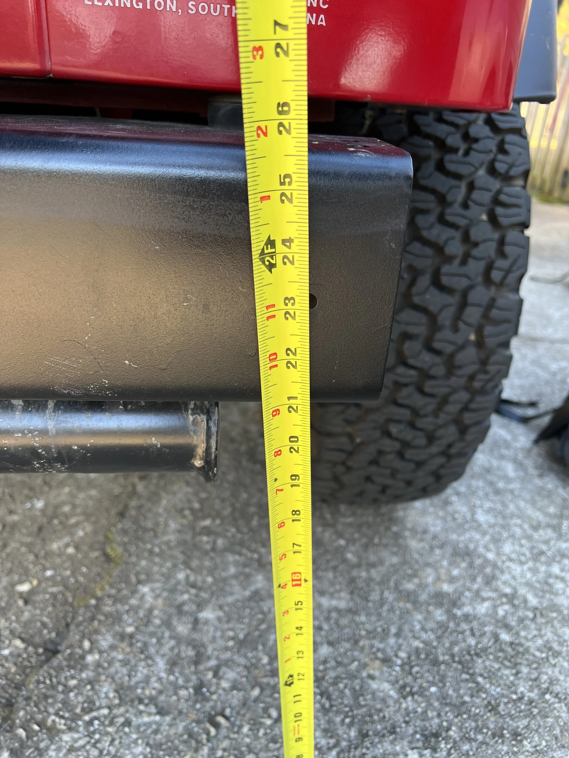

While I'm waiting for the shocks I'll work on installing my adjustable track bar in the front. When I had the springs on the rear axle was maybe a 1/4" off and the front was about 3/4" off. I'll set the new track bar 3/8' sorter or longer(I'll have to figure that out).

Today I broke the old track bar loose and was going to install the adjustable one when I remembered reading somewhere that the Rough Country paint isn't the greatest, much like Rancho shocks. I'll do the painting while I wait for the shocks and jounce bumpers I ordered this morning to show up.
