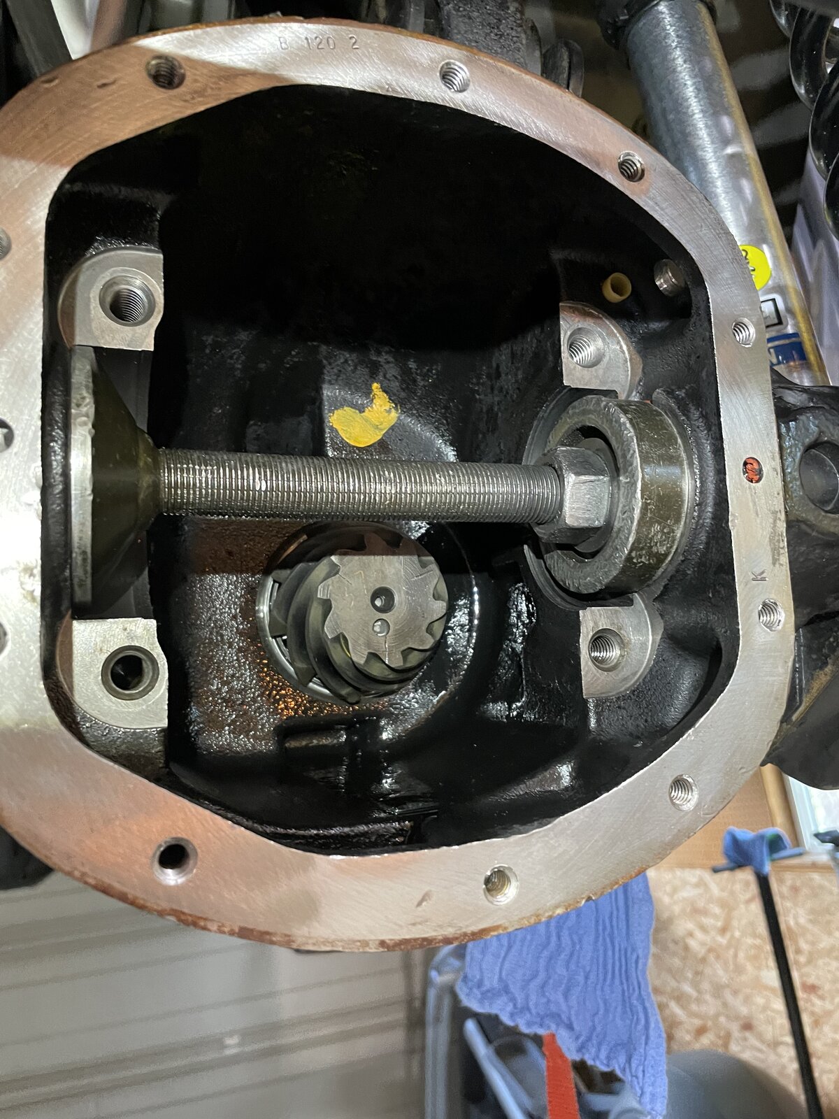

Today, I finished the Dana 30 front e-locker install. After finalizing the carrier bear shim stack with setup bearings detailed above, the new Timken bearings were pressed on the carrier over the final shim stacks. Next, the housing was prepared by drilling a 15/32” hole in a thin area near the breather vent:

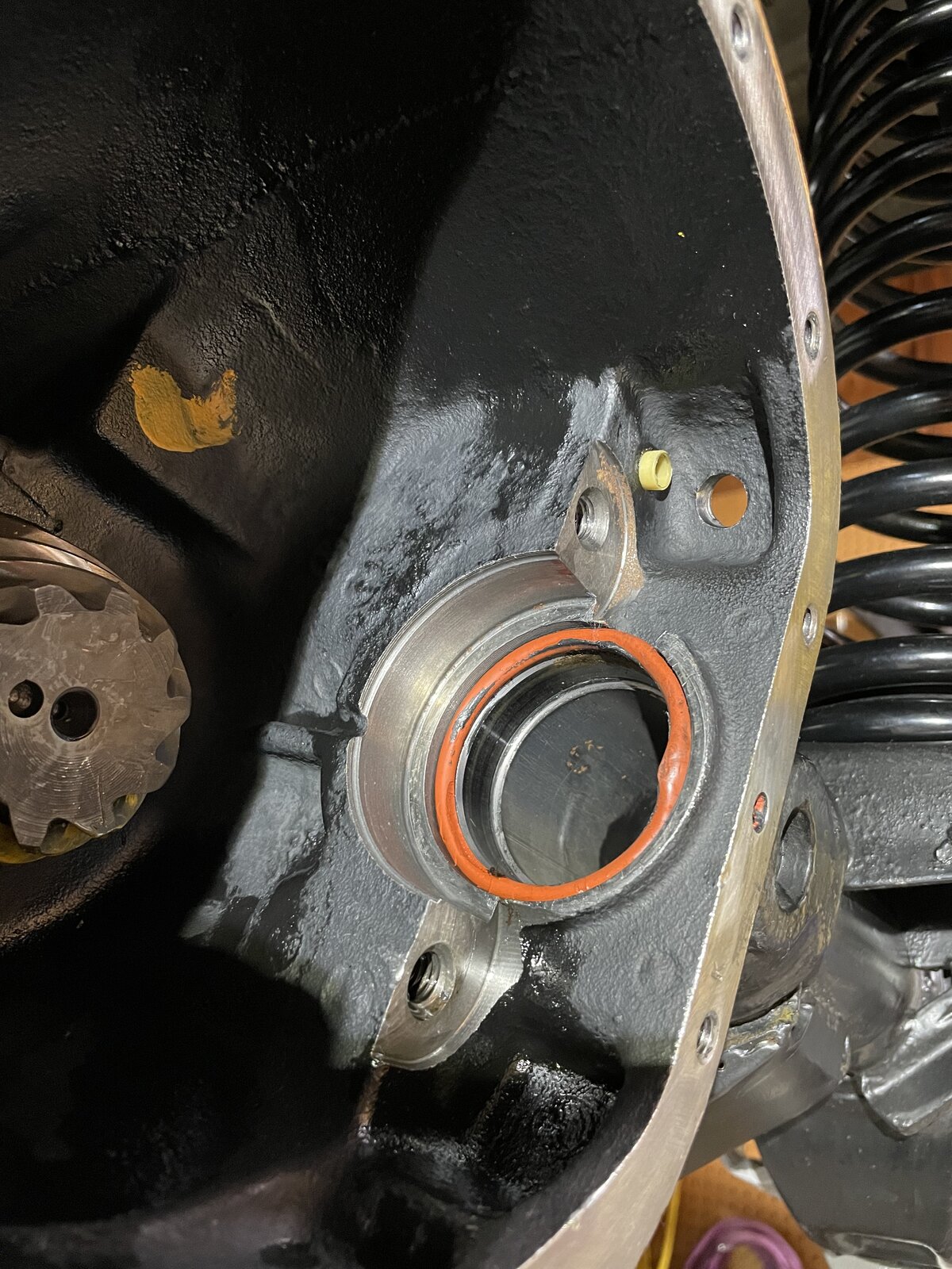

The metal shavings were carefully removed, the housing was cleaned w/ brake cleaner and dried with compressed air. Then new tube seals (National part no. 710068) were pressed in:

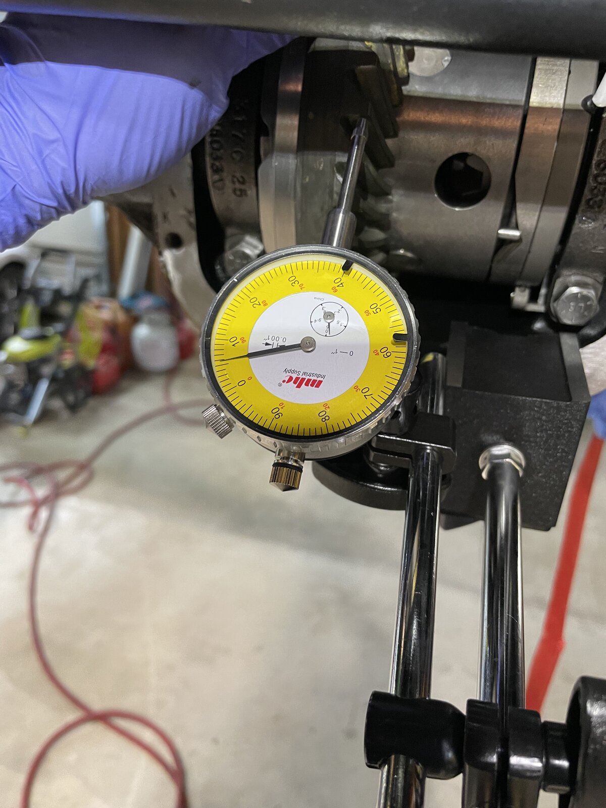

Once the carrier was back in place, the cap screws were torqued to 60 ft.lbs. and lash was re-checked. Still at 0.006”✅

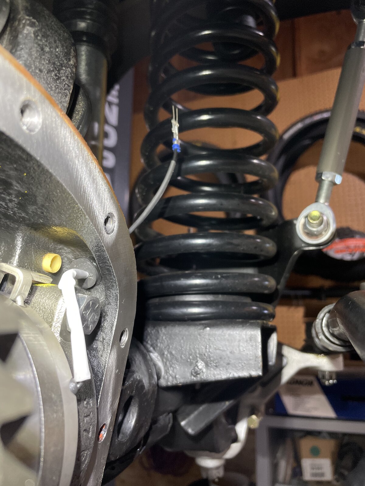

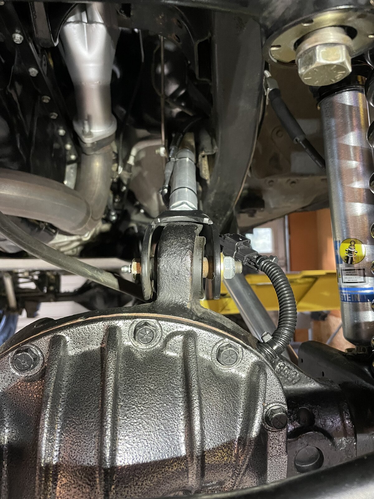

The e-locker wires were now run out of the housing via the new hole. The rubber grommet fit nicely and was also sealed with black RTV:

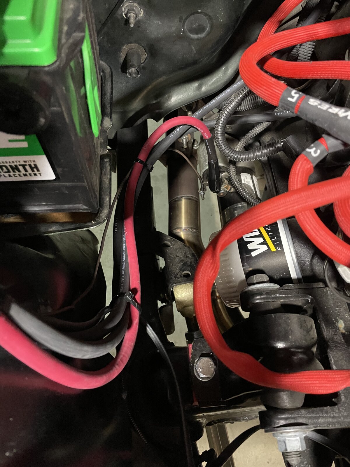

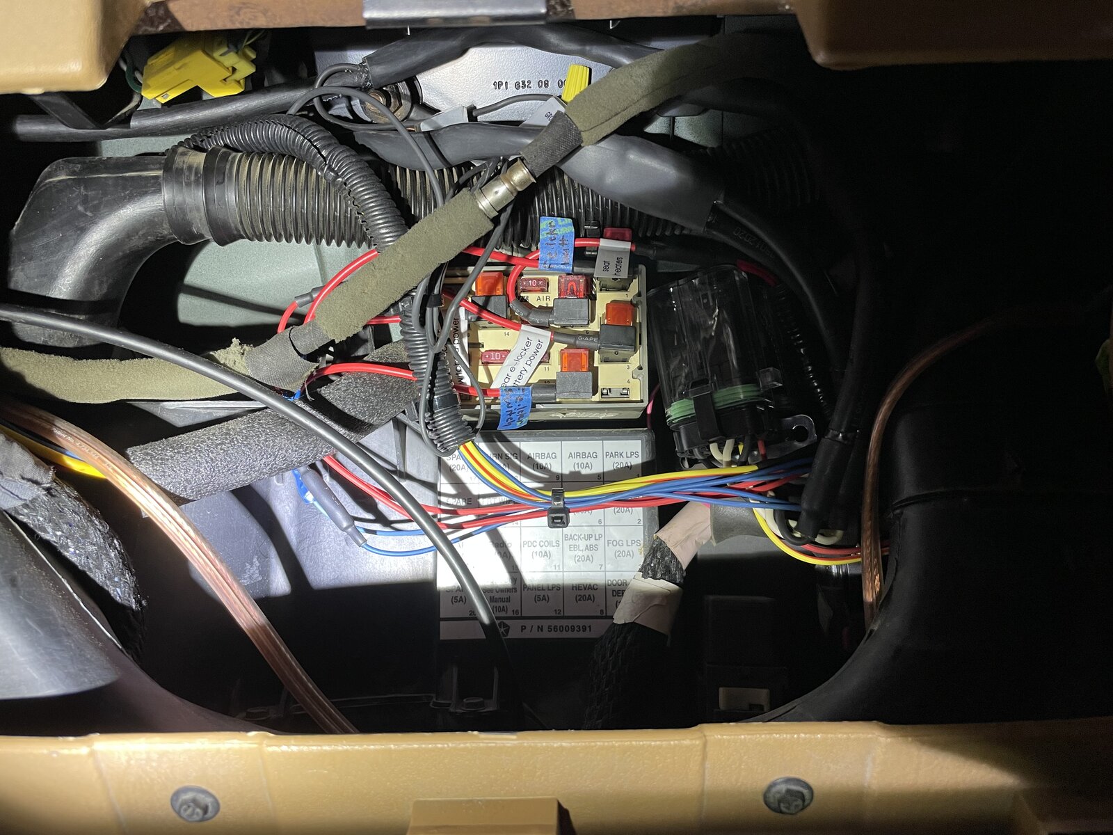

The 4340 chromoly 27 spline shafts went back in, the brakes and wheels went back on and the differential cover and LubeLocker were replaced followed by 1.3 qts of Valvoline 80W90. Now I started the e-locker electrical hook up. This went pretty quick, having done it for the rear not too long ago. I began at the axle and went up the UCA towards the frame:
At the firewall, the excess was looped and zip-tied with the rear wires. Then it went through to behind the dash using the same factory grommet as the rear:

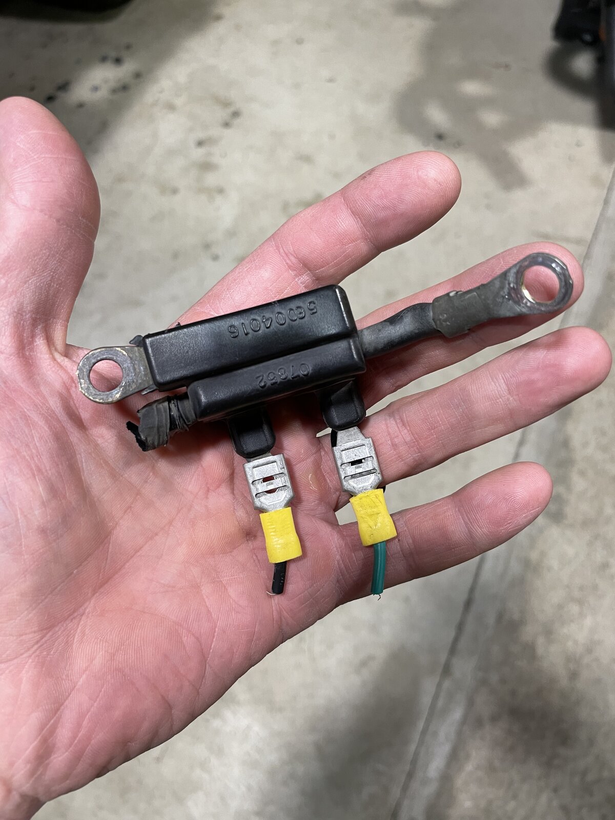

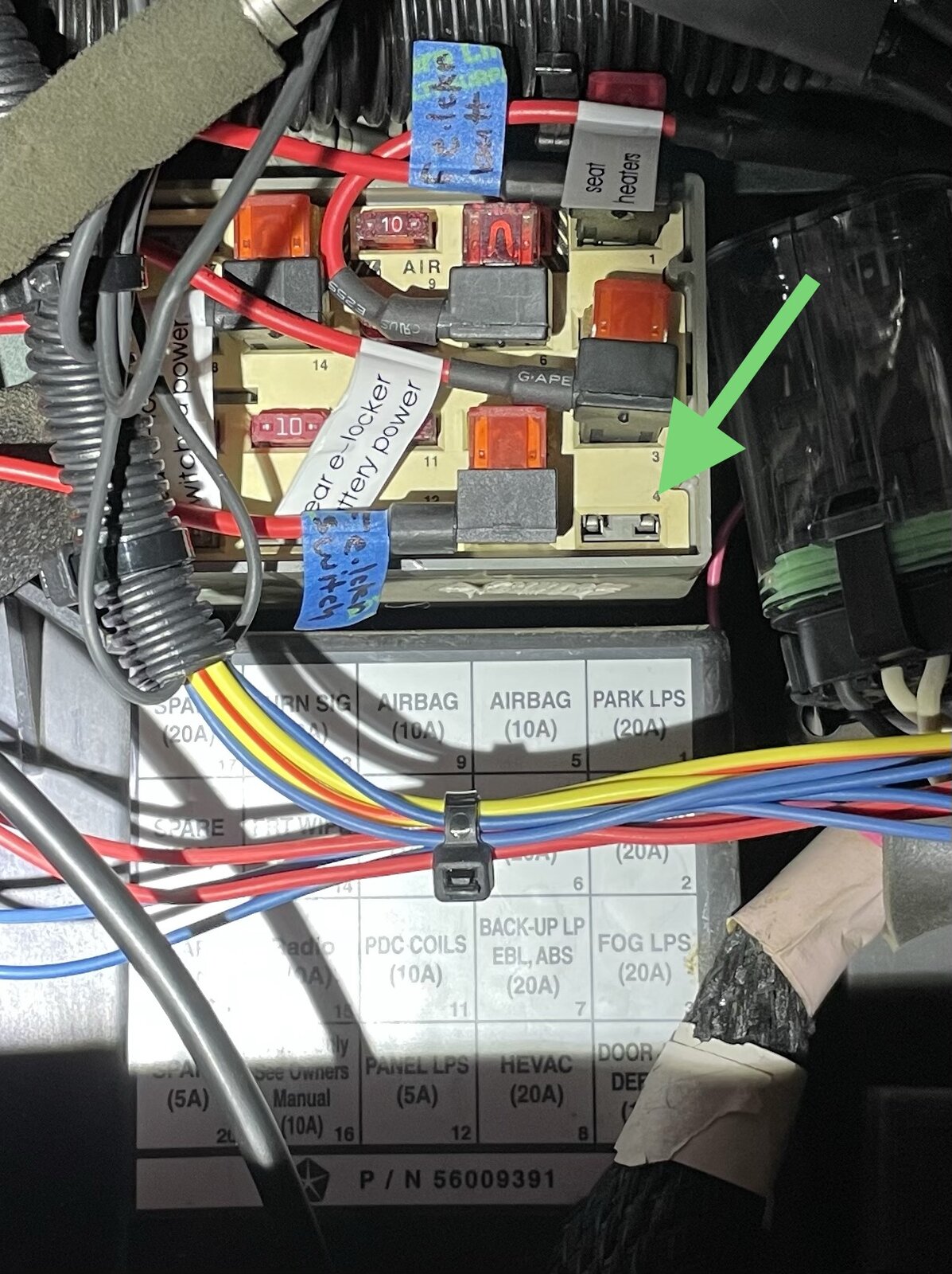

Now here’s an issue: Tap a fuses are great for one or two things (like when I did my seat heaters). But this is getting out of hand! However, it’s temporary. I’ve ordered a 7 circuit block from Painless Wiring (yet another idea I got from reading @Wildman ’s build thread). That block will have room to get all of this out of the factory box and for some other planned accessories. For now though, it sure looks like stereotypical Jeep wiring🙄
It all works however. The rig is fully locked😀

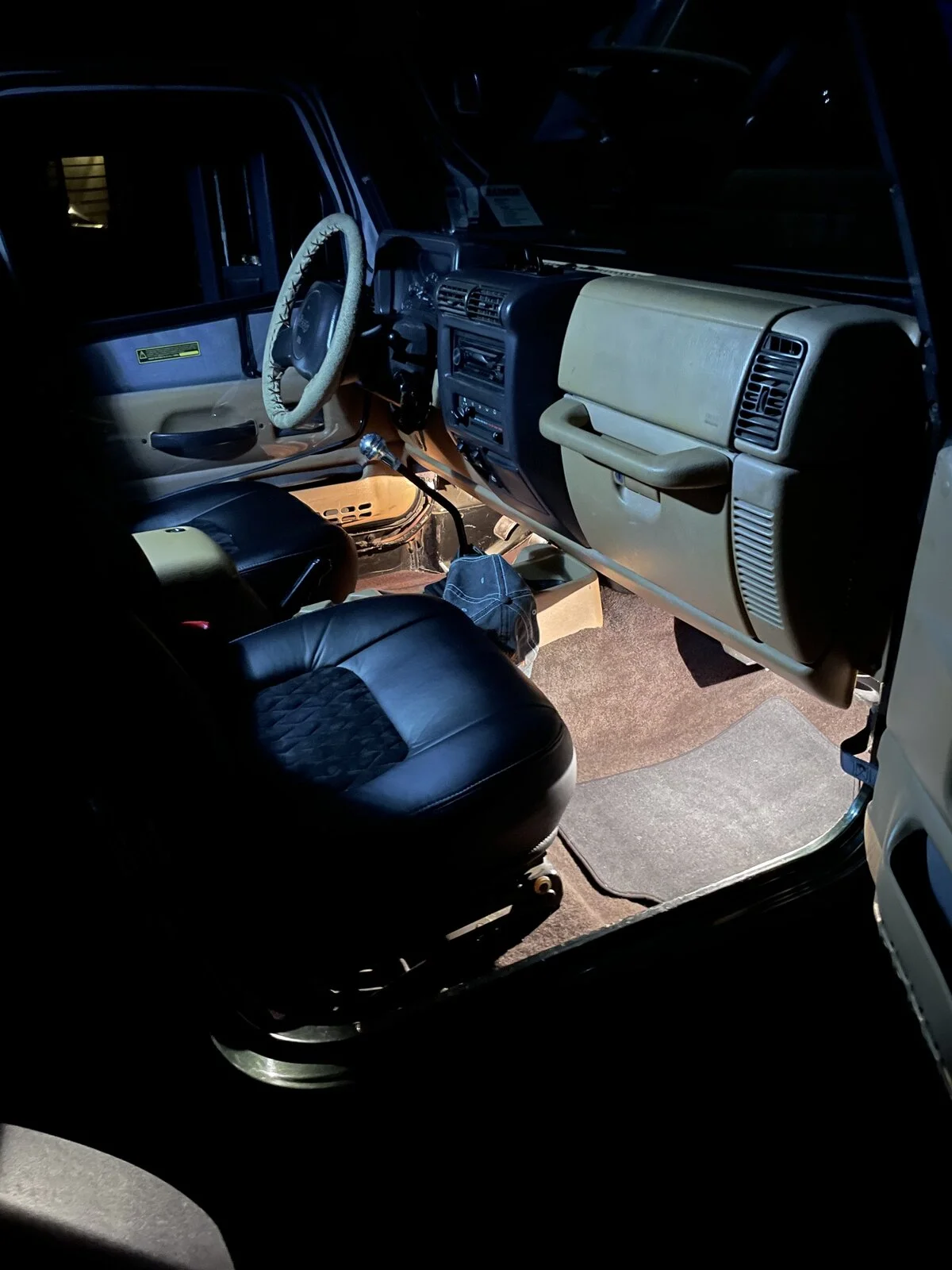

As an aside, while I was rooting around the fuse box trying find acceptable locations (sort of) for all these tap-a-fuses, I discovered position 4 which didn’t have a fuse is for the interior lights to come on when you open a door.
It’s purpose is to allow defeating the lights always being on when running no doors. I never knew. Now I have a lighted interior when I open a door at night. Bonus!
