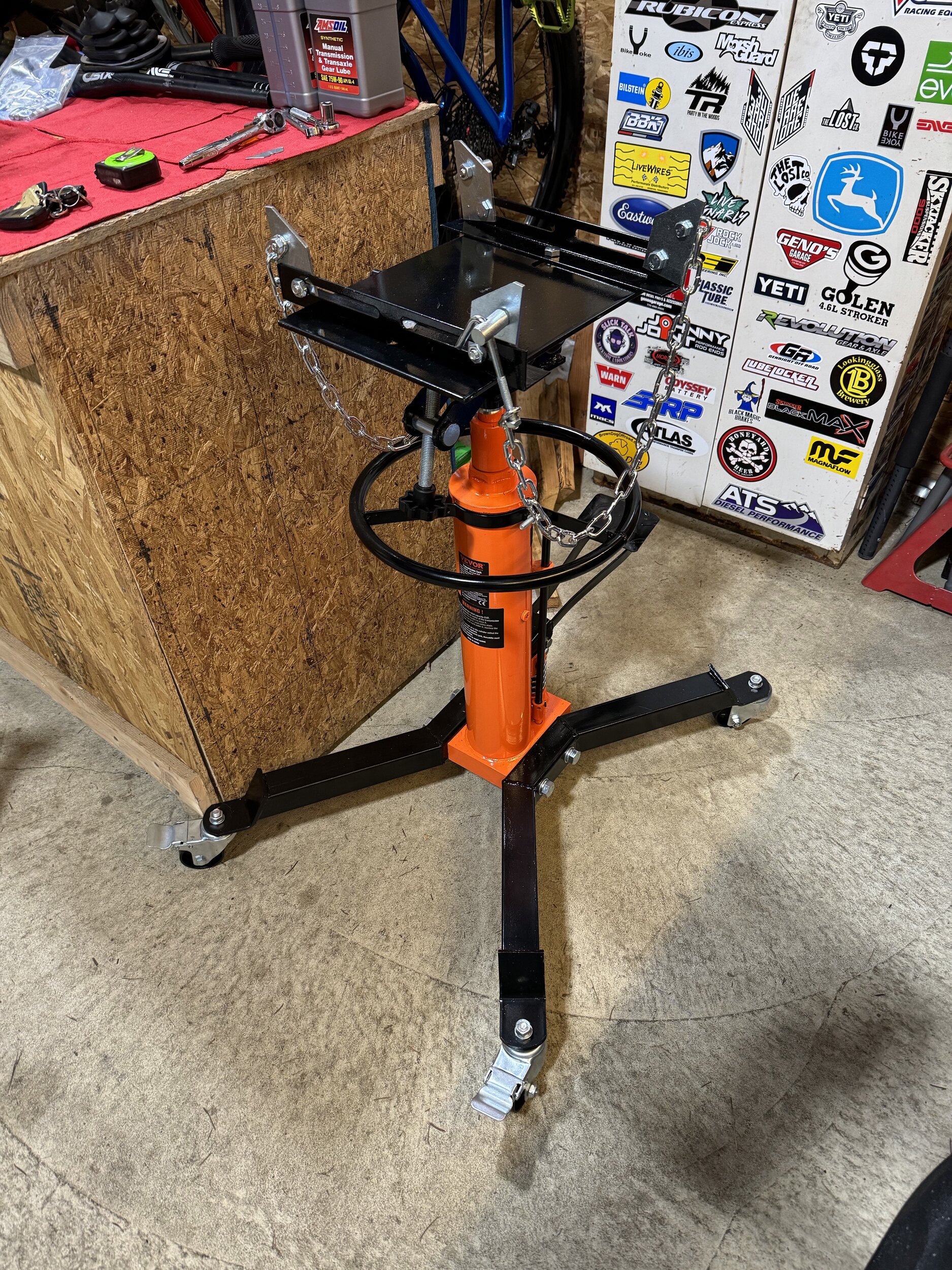

So, today I pulled the Jeep into the garage to begin the above. I realized relatively recently that I need a transmission jack to install the Atlas. There are many options, but as I will be using my lift, I got this one:
It will elevate the tray to 68.5”.

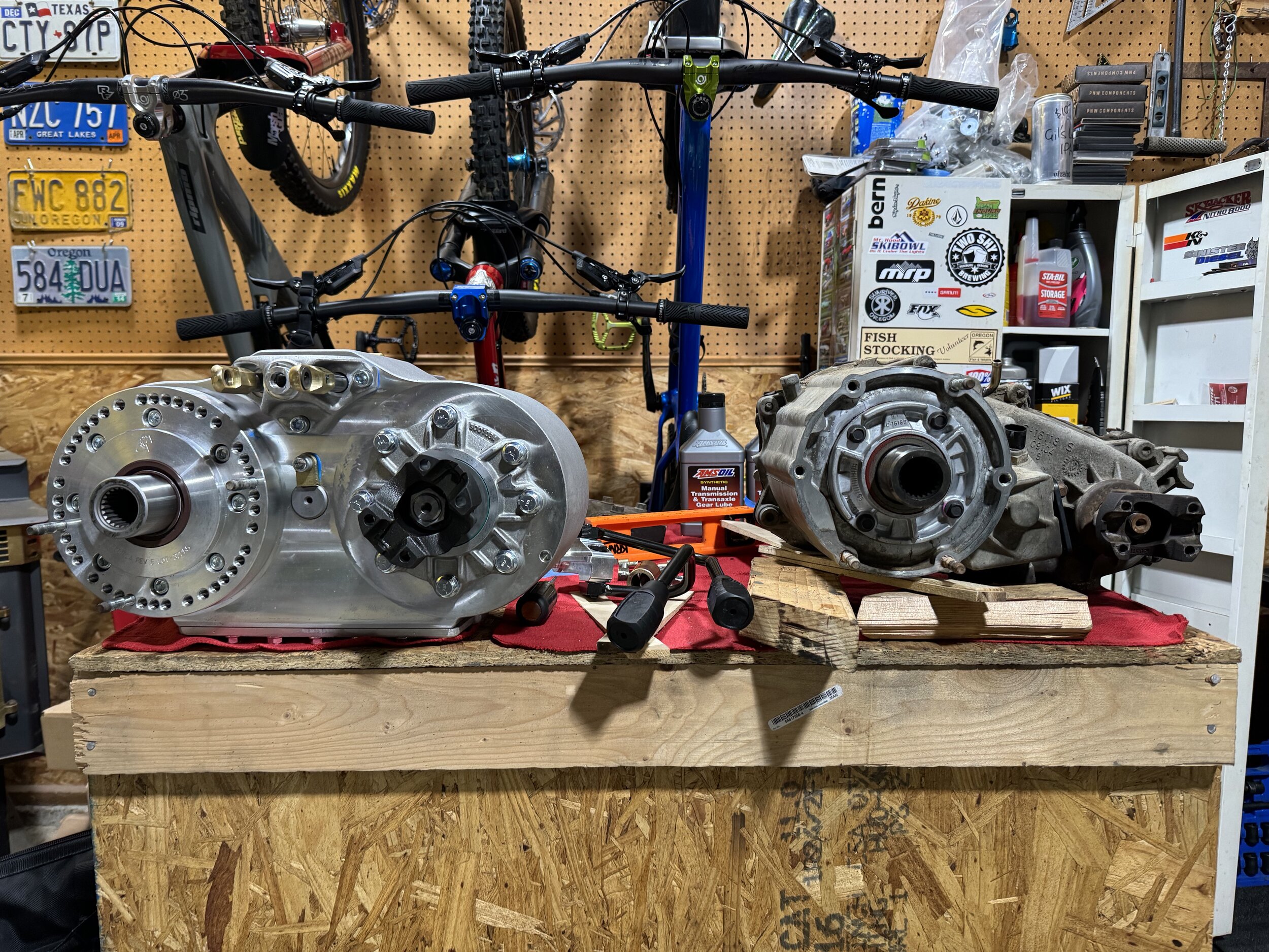

Next, I pulled the T-case out of its box and inventoried the parts (AA says do this with in 7 days of receipt-missed that by a few months but all seems present.

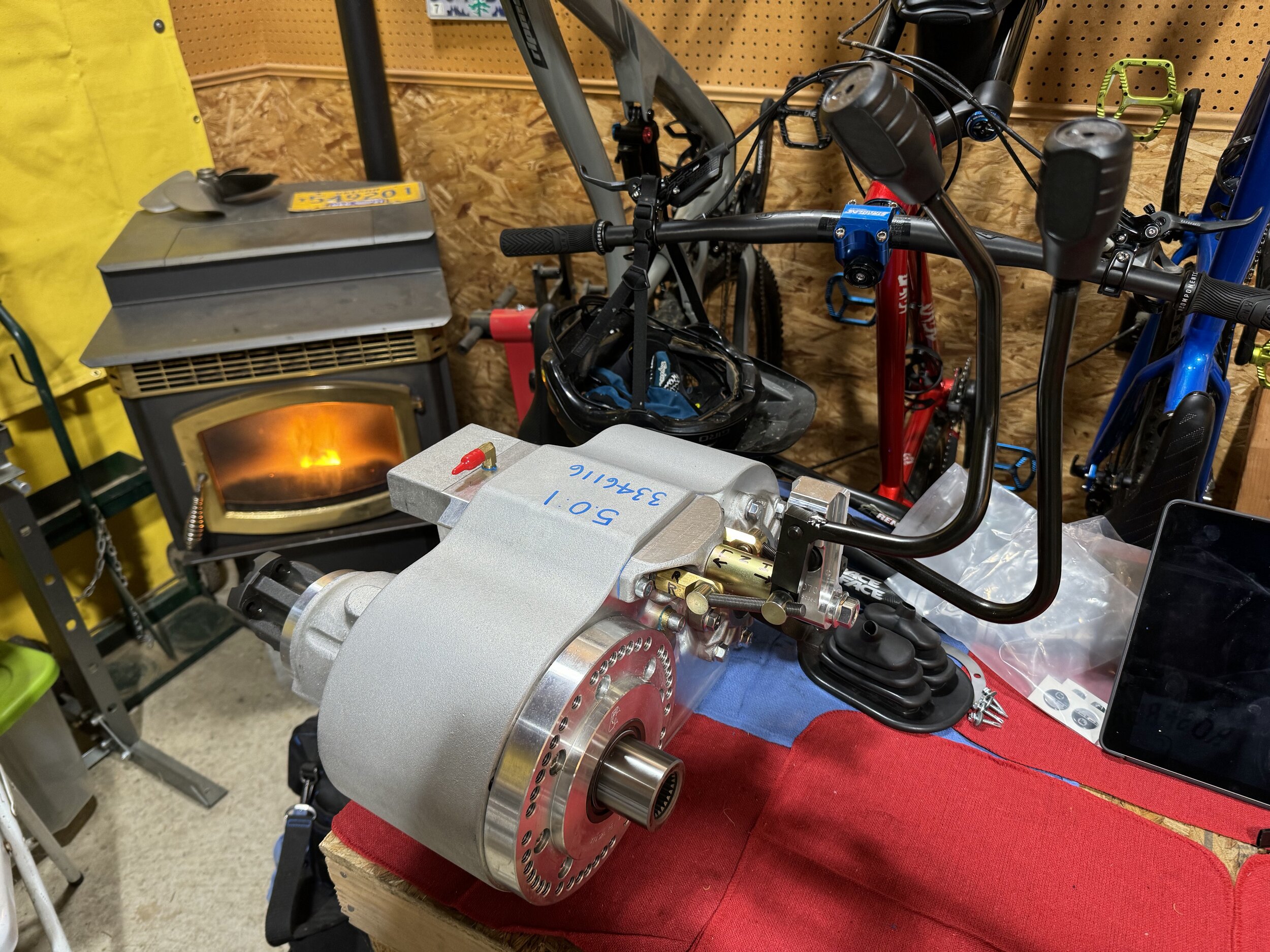

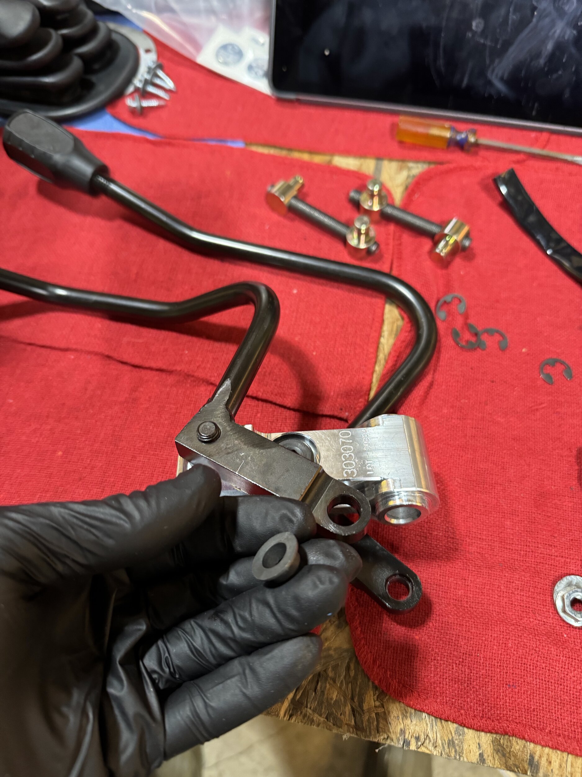

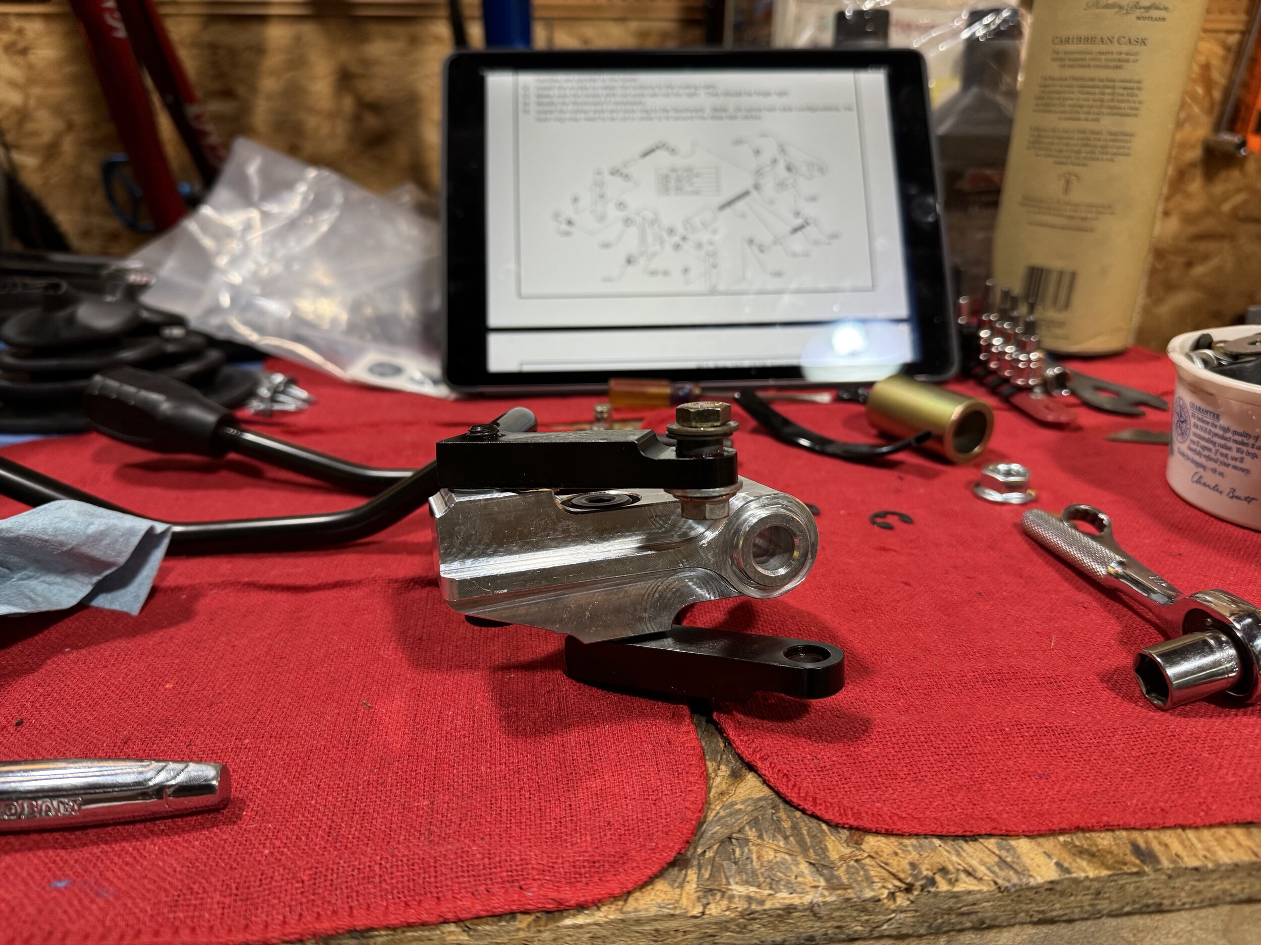

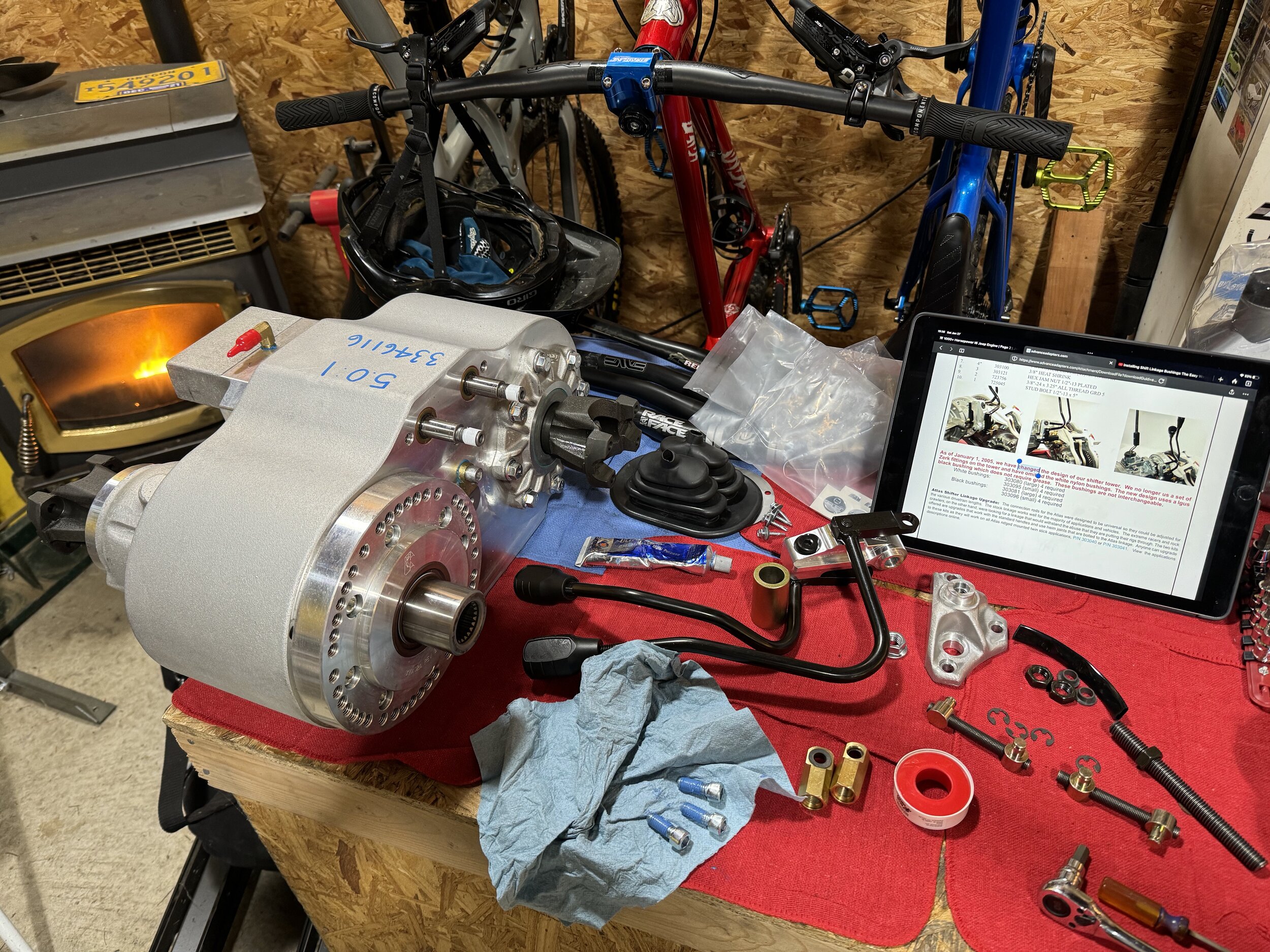

After some reading, I decided to test assemble the shifter first to make sure I understand how it all works. It comes with bushings that press into the linkage (probably Derlin?). I used a bolt, nut and some washers with a little grease. That went fine.
Here’s the assembly:
I verified it shifts well. Tomorrow, I will start to pull the 231. (edit: levers are on backwards which I didn't figure out until actual install:rolleyes:)

I have the Savvy cable shifter on my 231 which has been convenient as the the drivetrain-tub relationship has moved around, but I prefer the feel of a mechanical linkage. This one is nice in that its a direct connection to the gear box. Hopefully, its feels as nice in real life as it does on the bench and is reliable🤞

It all new to me. Like I noted, the direct linkage works well on the bench. AA says you probably need to clearance the hole in the tub and then there’s the console to line up with and I don’t know how much the drive train flexes around so we’ll see…

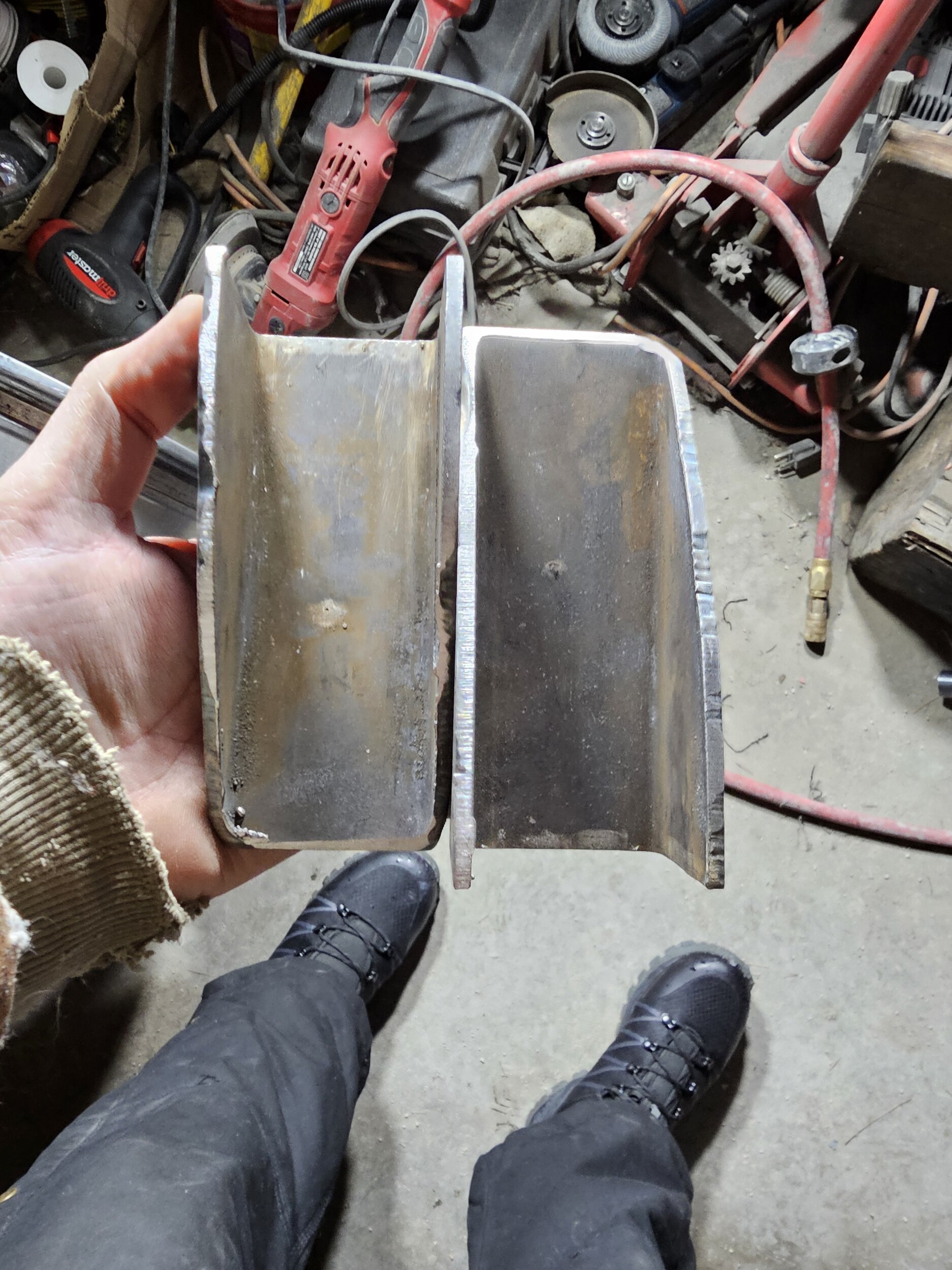

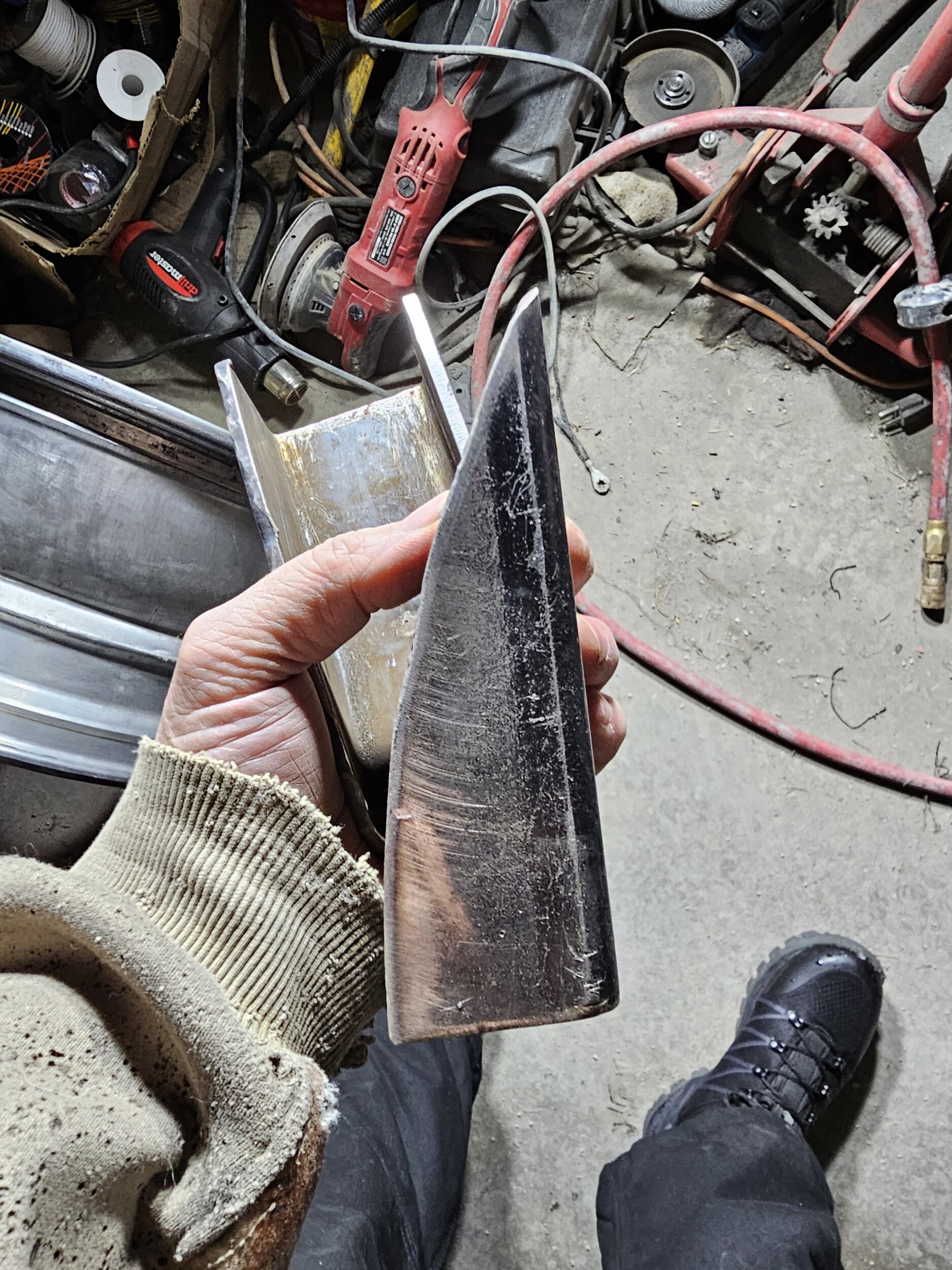

Had to download these pictures since I'm not at home.
The first shifter was the rods.
The second was the black one.
You can see neither are as refined as the AA shifter. Which was part of why I wanted cable shifters.

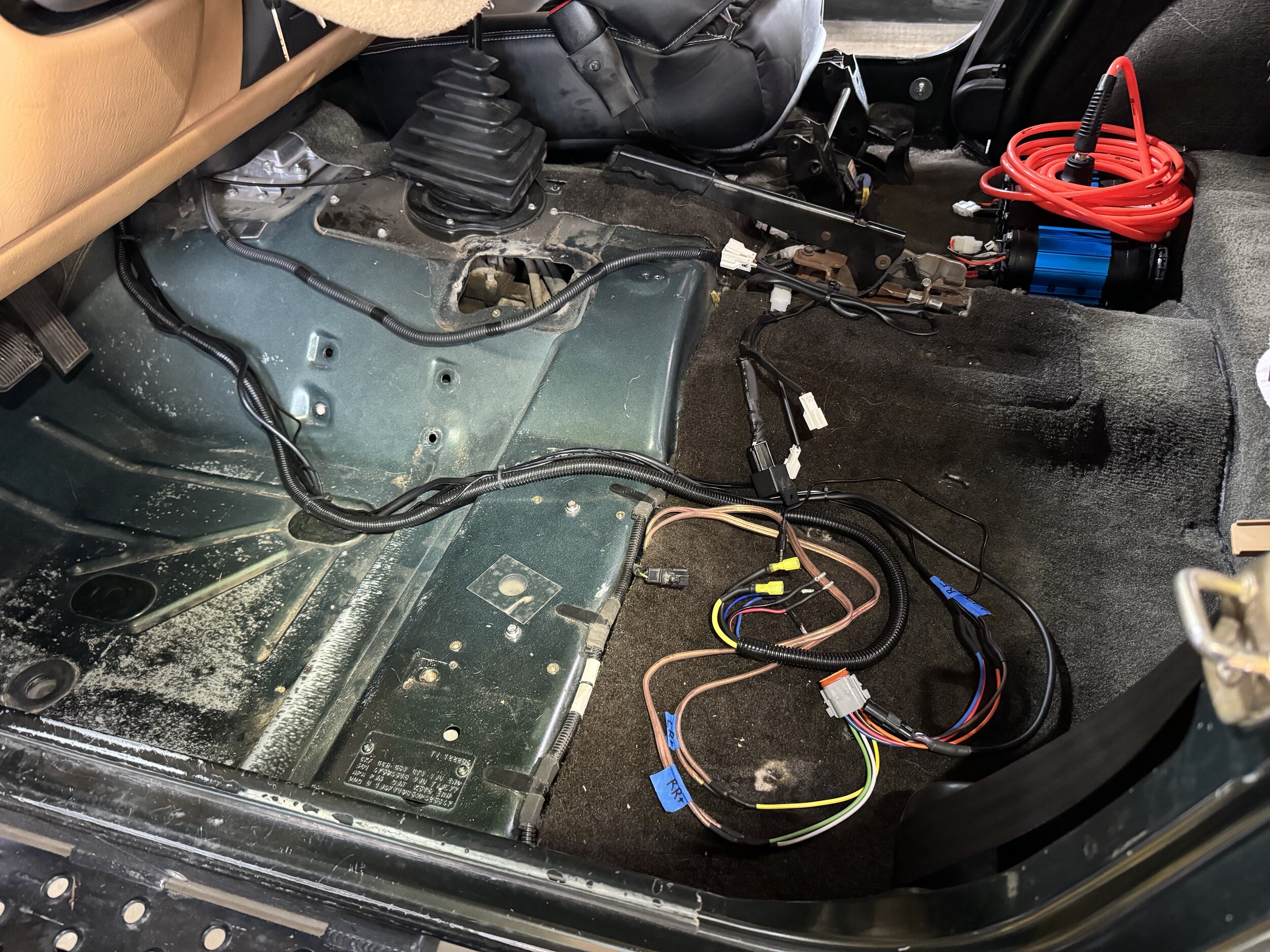

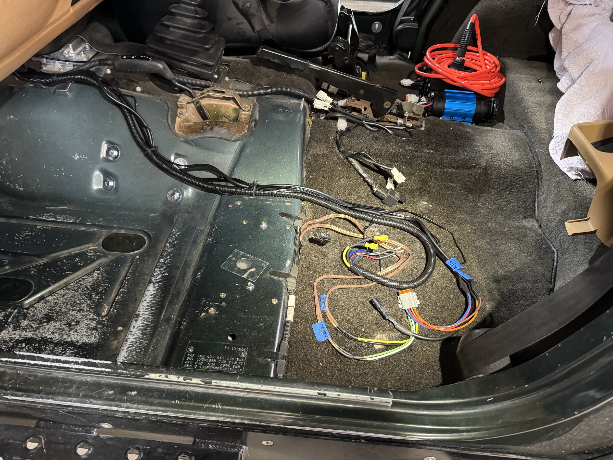

Today I got up, had coffee, went for a run and pulled the NP 231. It went well. First I pulled the driver’s seat and console. Lots of wiring there (heated seats, ARB on board air and sound system). I haven’t posted about the sound system yet because I’m still tweaking it. I did find out that some speaker noise which follows engine RPM went away when the Bluetooth amp and powered sub are unscrewed from the tub. So I’ll need to isolate that when it goes back together.
Then the stock T-case shifter came out and the Savvy cable shifter was disconnected from the tub. I had good access to the 4WD switch plug, T-case breather tube and one of the top trans to T-case bolts so those were taken off. No idea what the red arrow is pointing to? Looks like some sort of magnetic or Hall effect thingy?

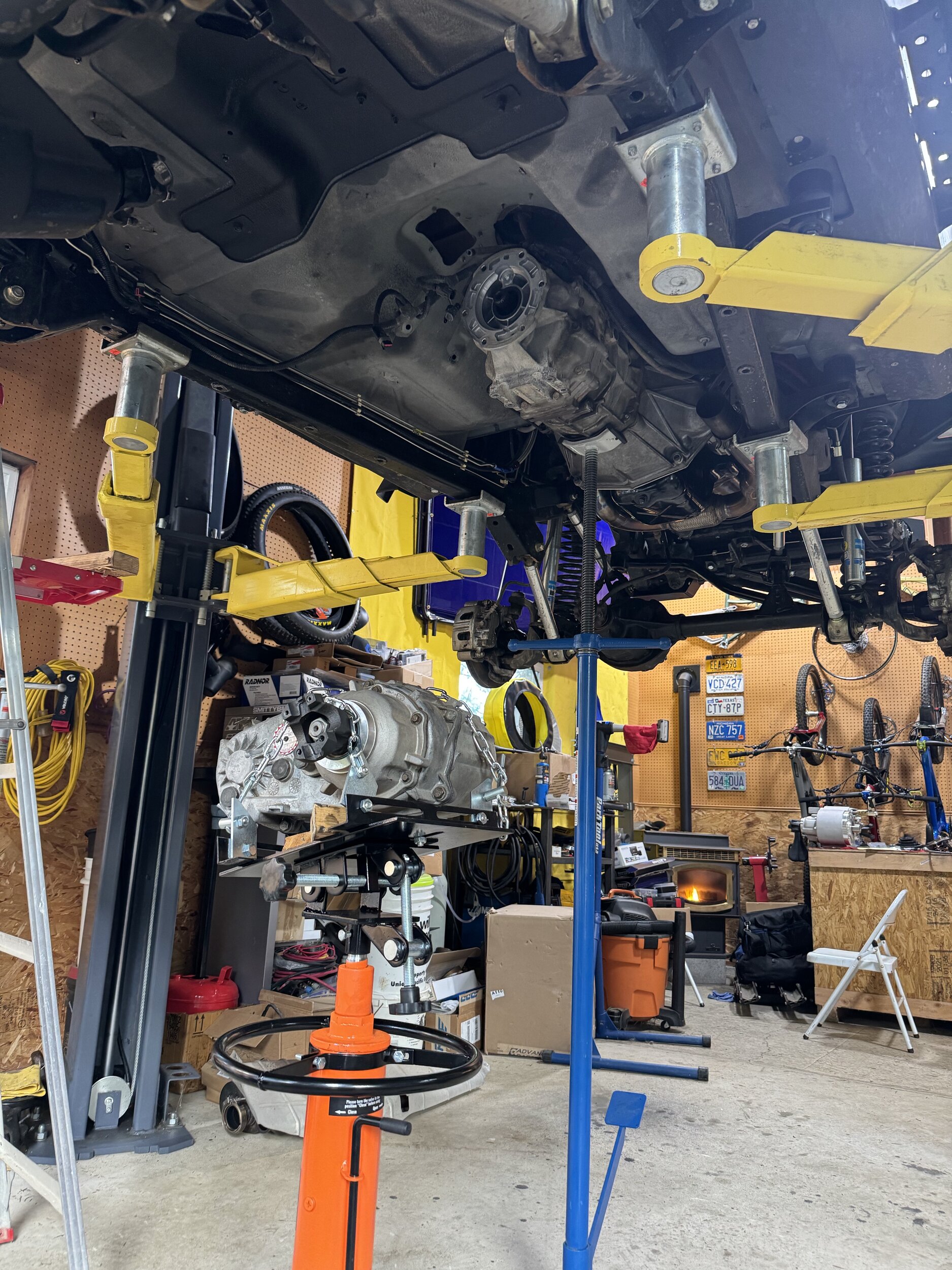

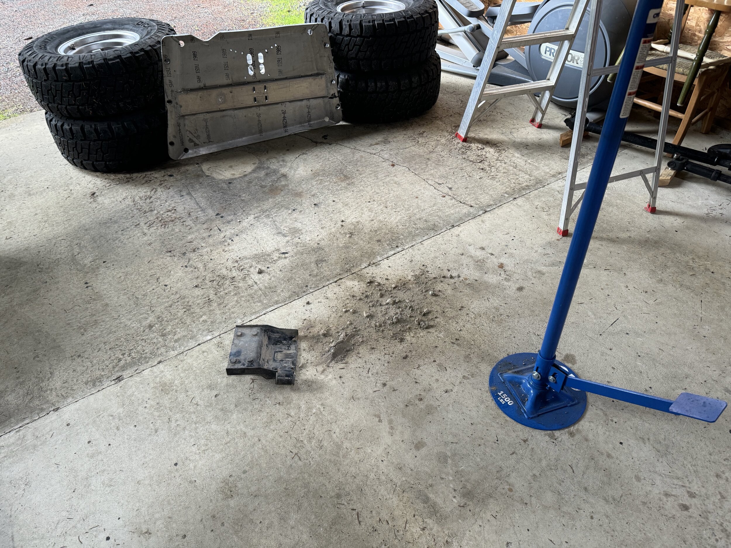

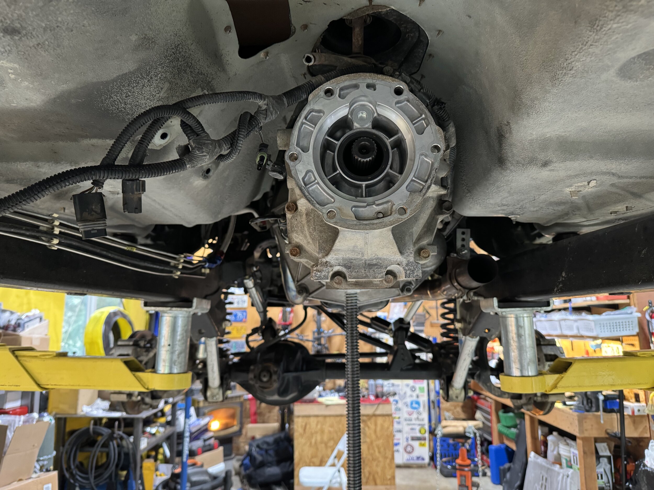

Done inside for now, the Jeep went up in the air. Wheels off, transmission supported with a poke jack, T-case skid off, drive shafts off, and I removed the exhaust from the crossover to the tail pipe so the heat shield could be removed for access to the upper passenger side trans to T-case bolt. The transmission mount and plate came off as well as the plate needs to be modified for this install. I found a bunch of dirt on top of that plate. There was a lot of this under the Jeep when I got it from the PO almost 5 years ago. This may be the last of it. Mud sucks.
Now, the transmission jack came in and other 5 trans to T-case bolts were removed and the AX15 and NP 231 were separated.

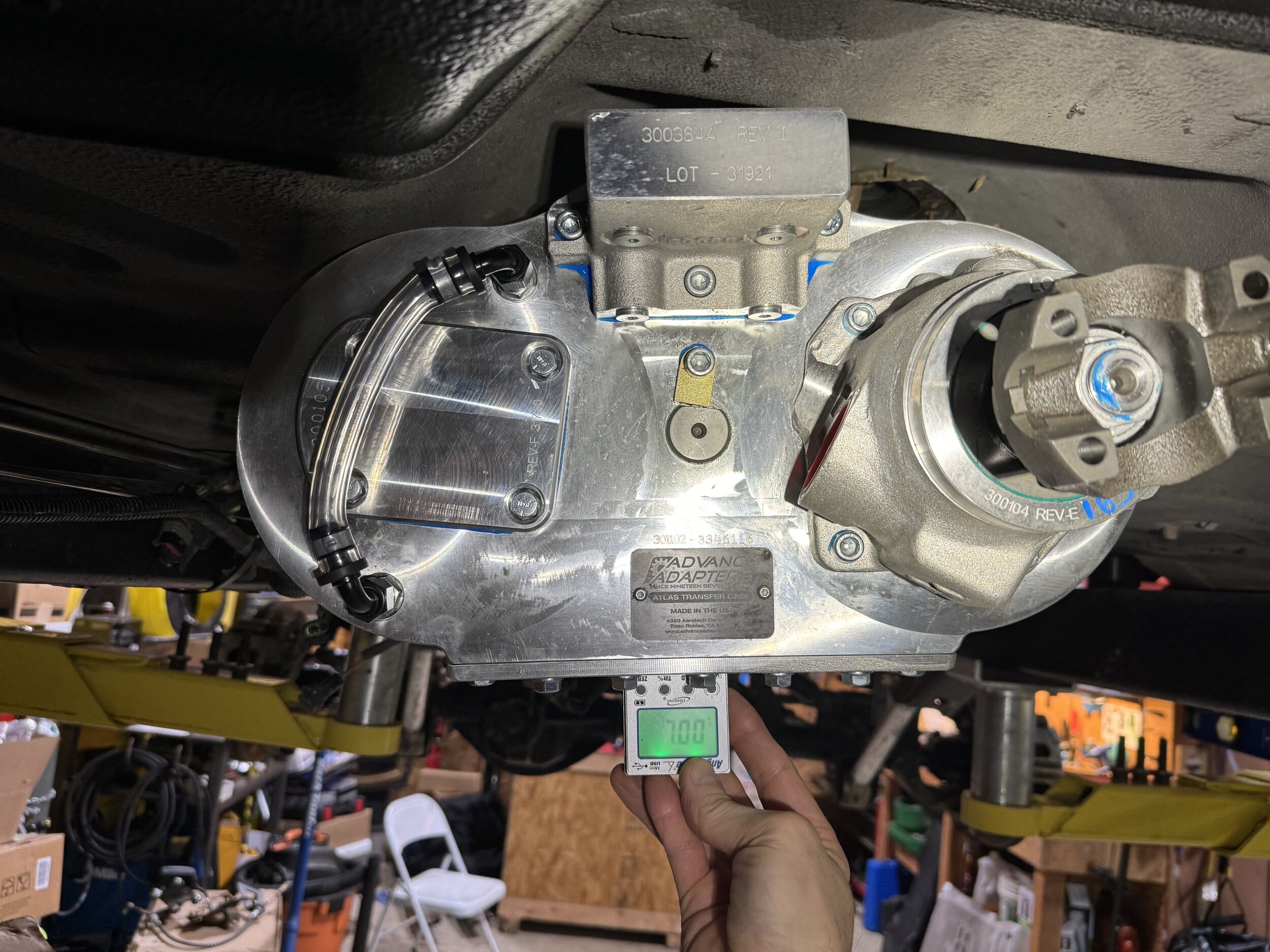

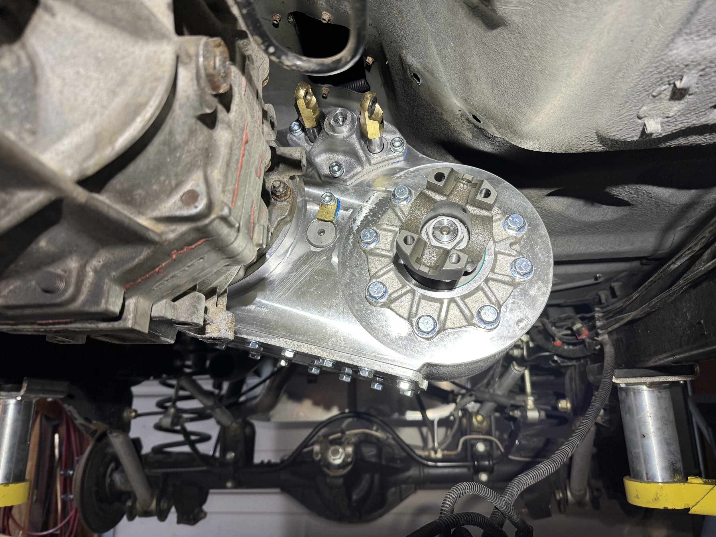

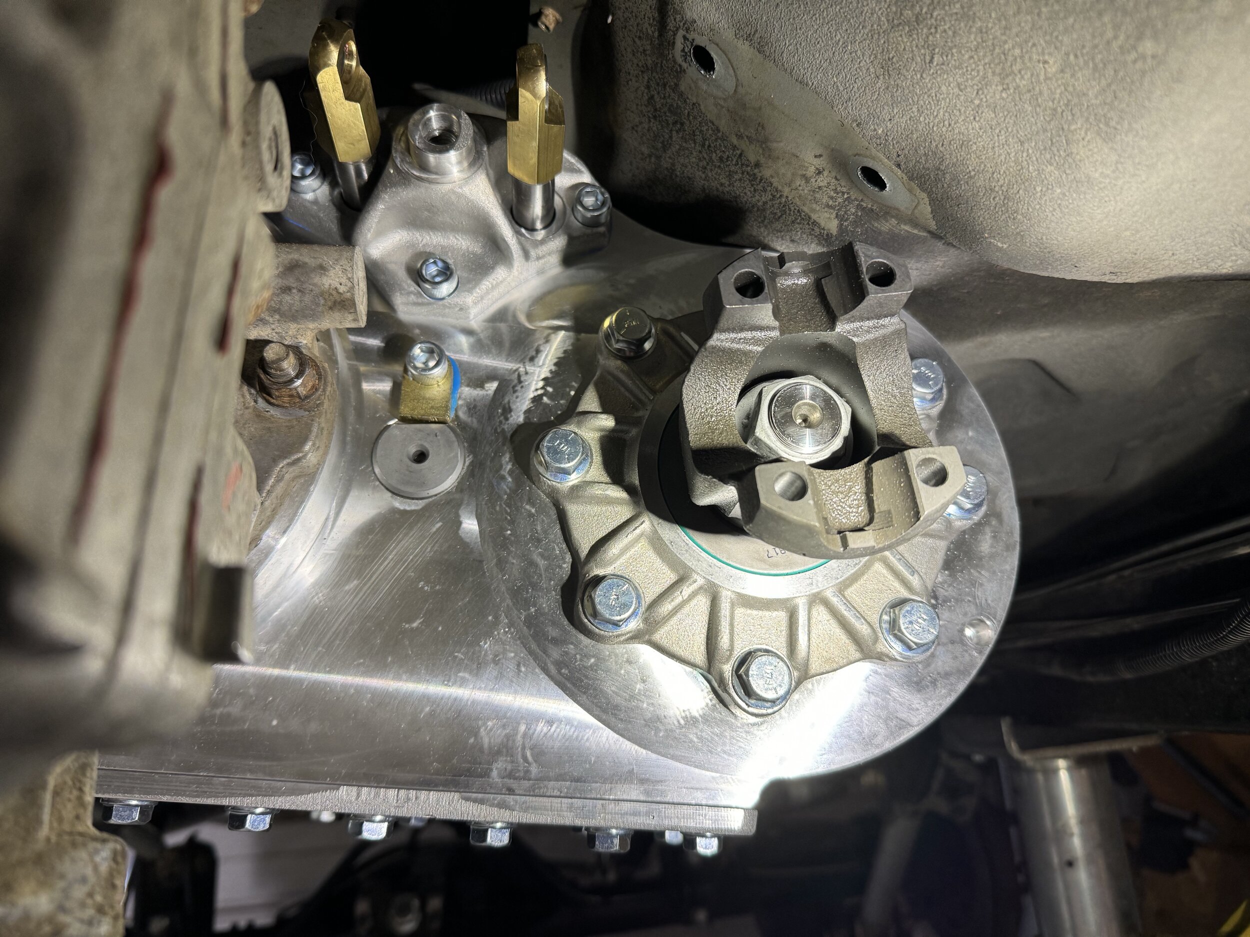

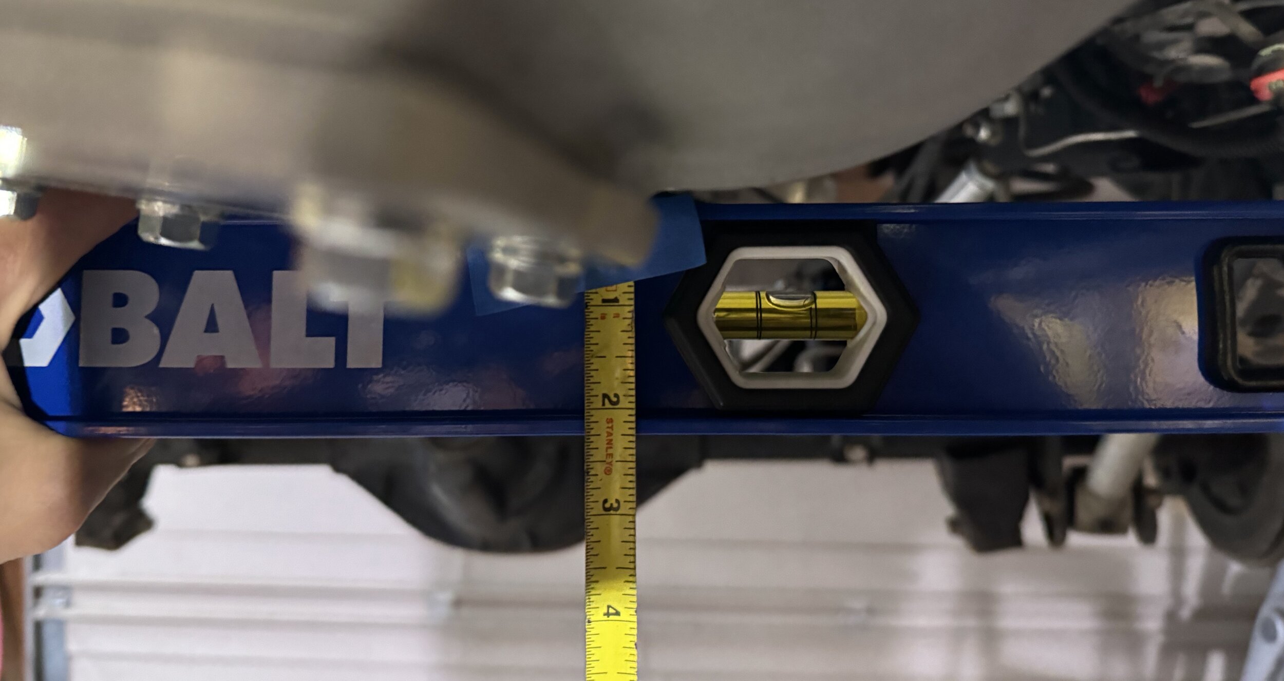

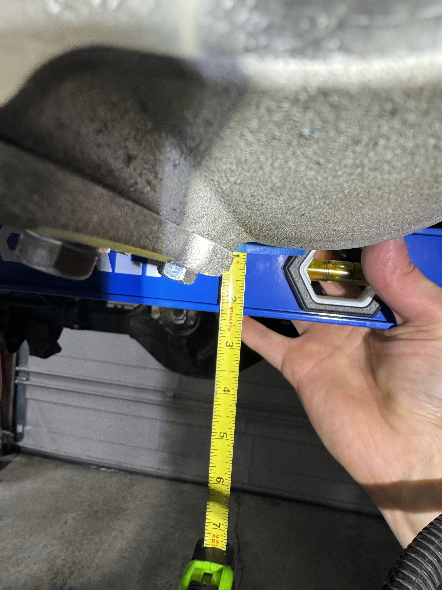

I began work on the Atlas install this evening. This Atlas is much larger than the NP231 top to bottom, especially on the front output (driver) side.

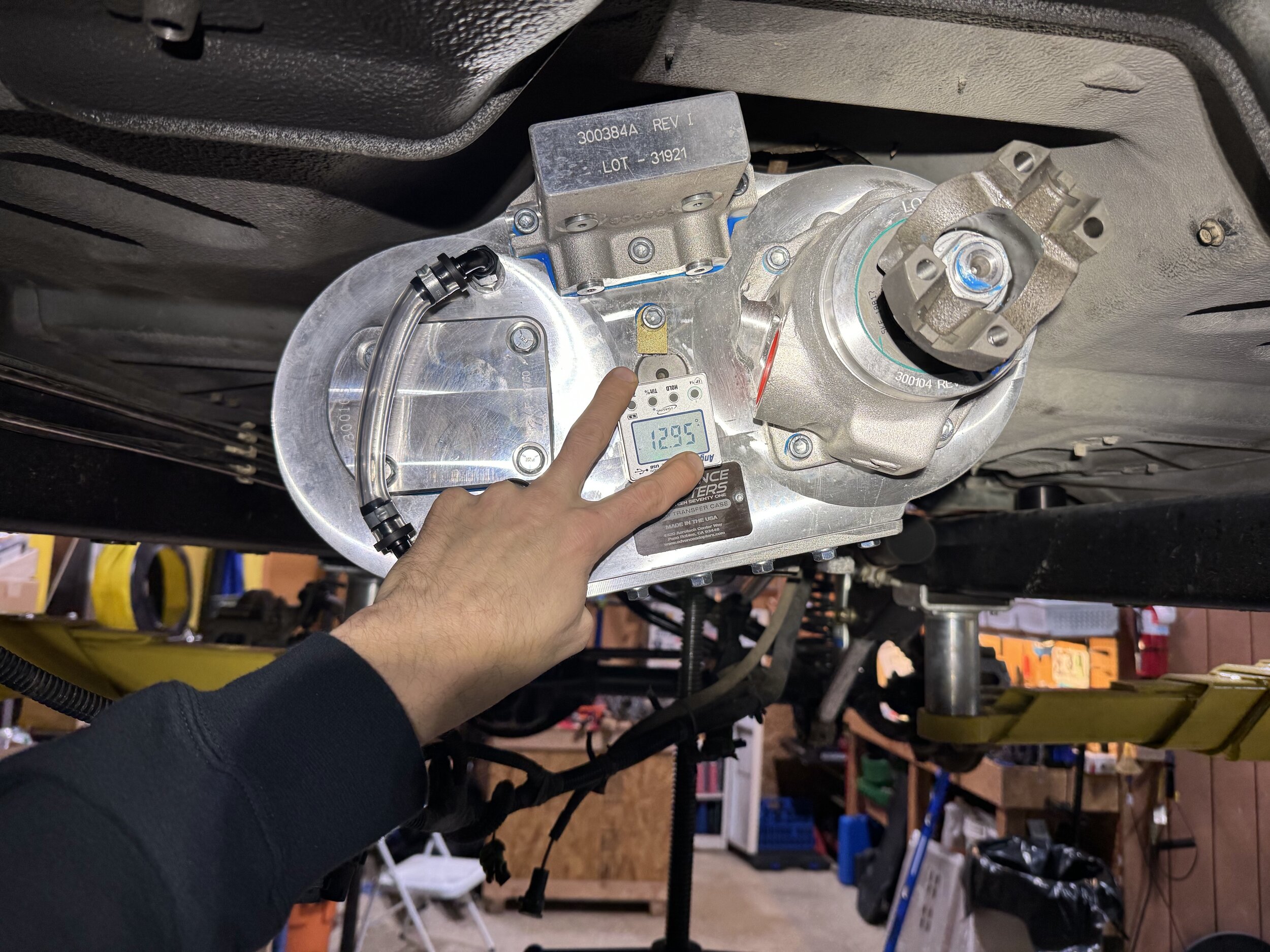

Despite this, I’m hoping to exploit the new 1.25” body lift to increase the amount of tummy tuck from 2.5” below the frame to roughly 1.5”. The Atlas has multiple options for clocking. The position of the stock 231 is 13 degrees down on the drivers (front output) side so I started with that. The height of the pole jack supporting the AX15 is at the height the trans sits when using the stock trans mount on the UCF ultra high clearance skid.
This gave plenty of room on top.

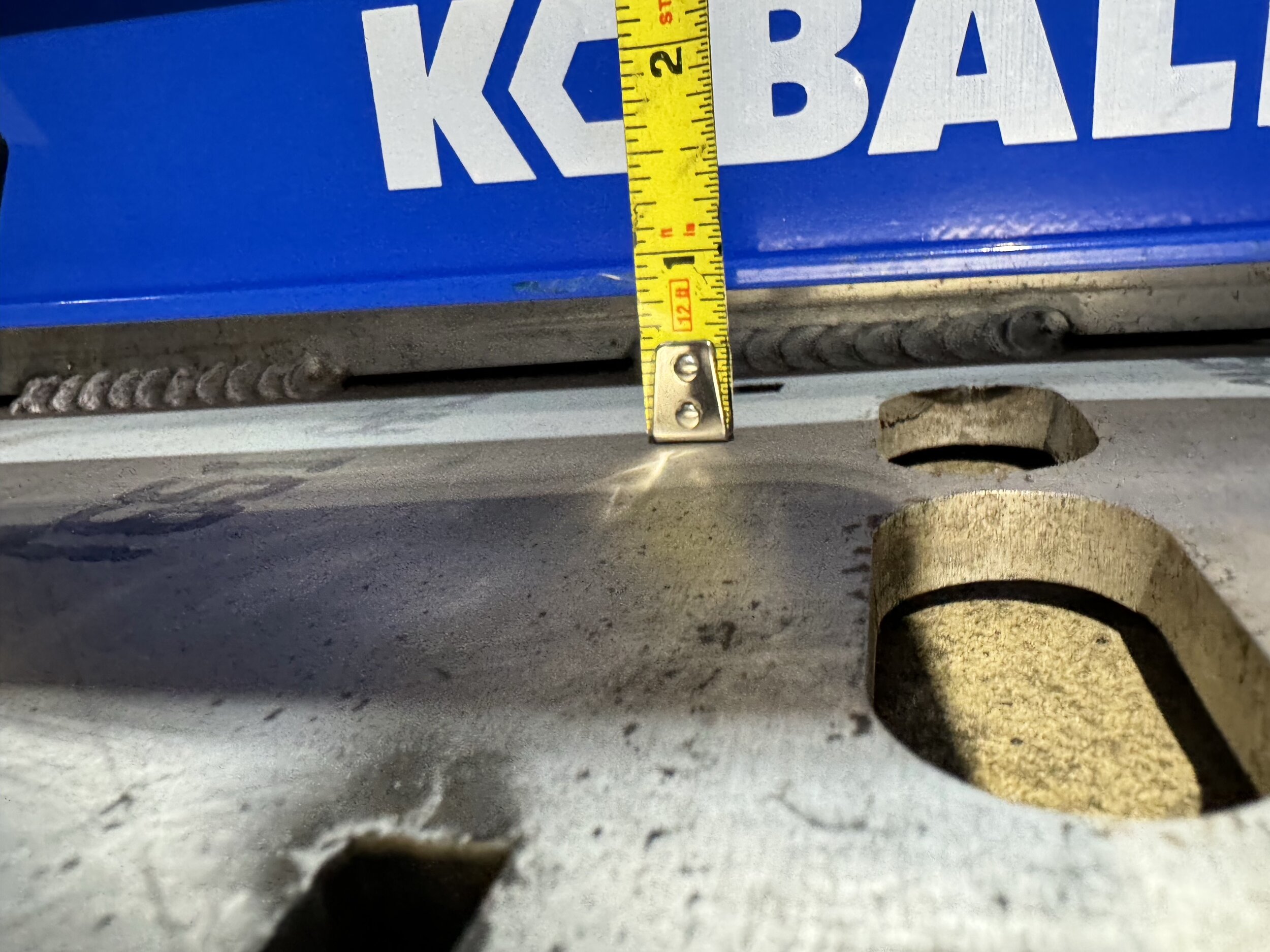

But that Atlas at 13 degrees also hung down too far to use the UCF ultra high clearance skid. That skid is about 1.25-1.5” below frame belly height (outside) but less than 1” on the inside.

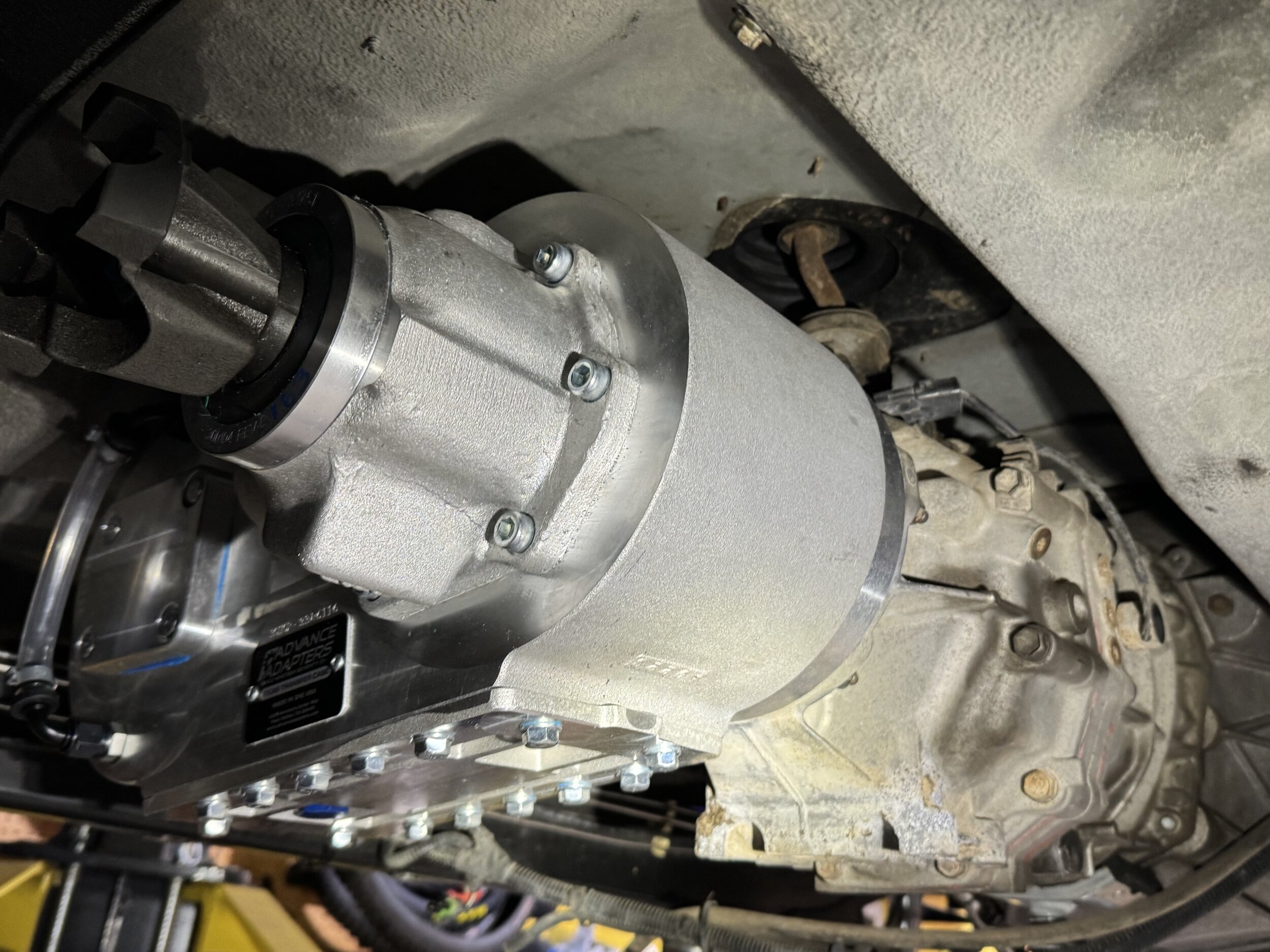

So next I tried 7 degrees.
I liked this better. It will require some tub clearancing but should also allow the higher T-case skid.
Either way the transmission mount plate will need modification and I think I’ve decided to make a custom crossmember rather than have the transmission rest on whatever skid I use.
I‘ve got some work to do…
