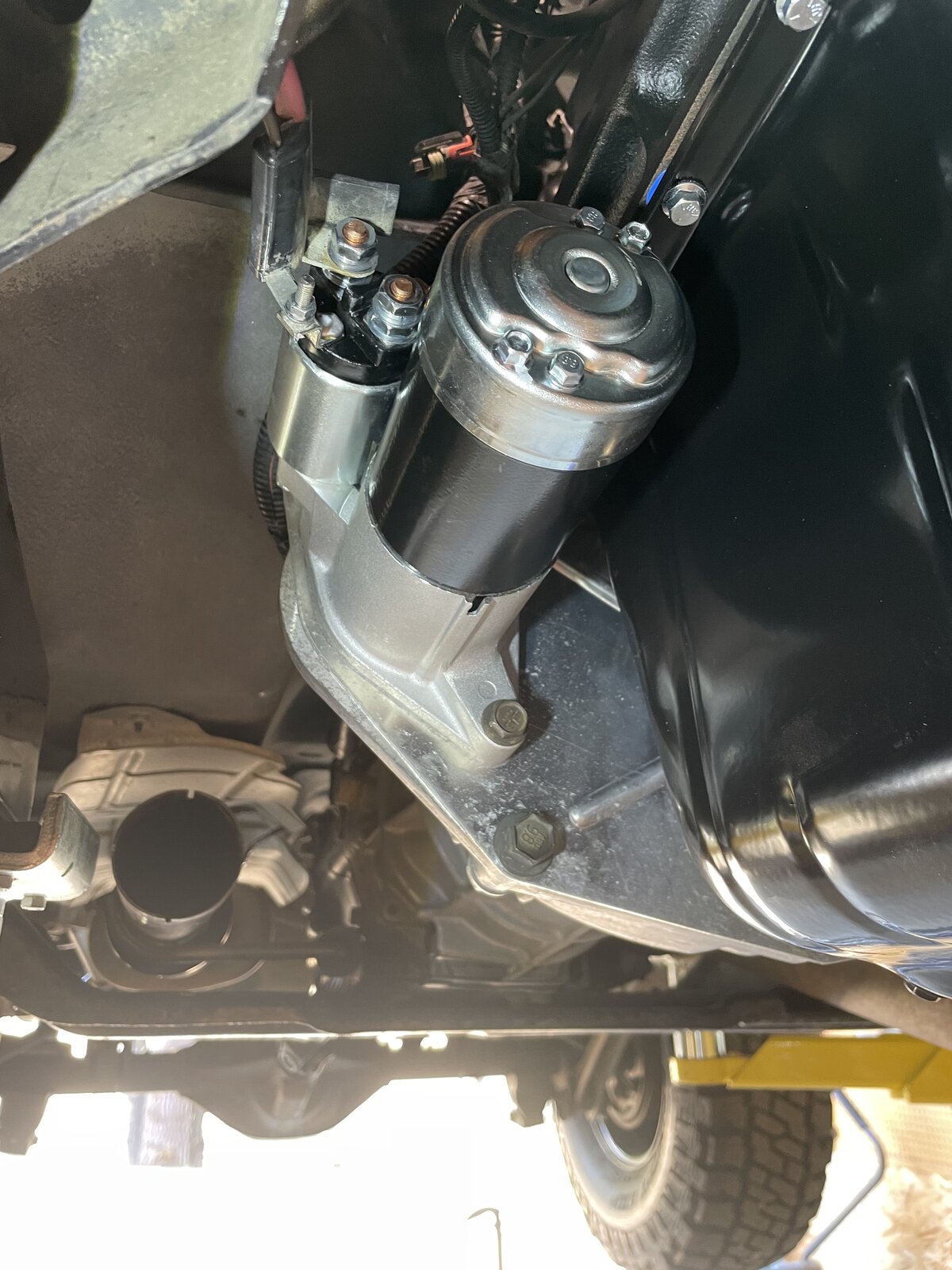

This is a new starter from NAPA (I couldn’t find an OEM Mitsubishi unit).

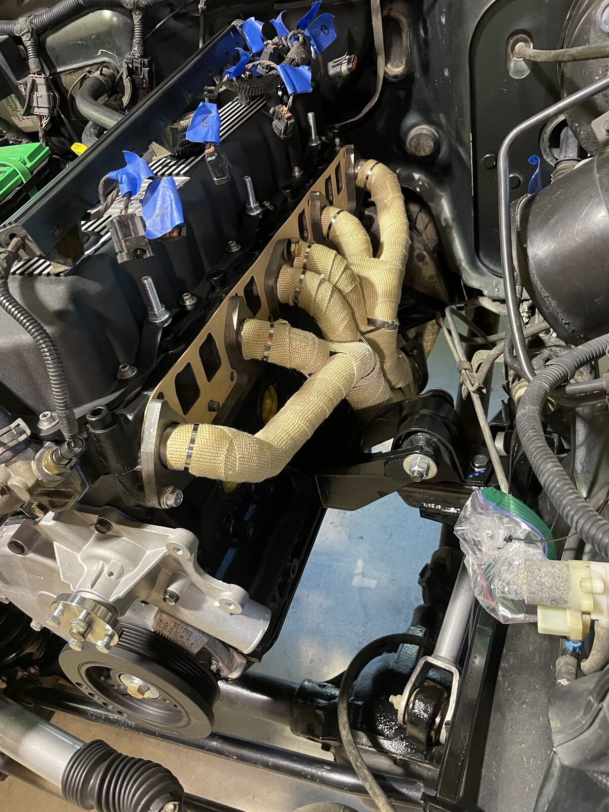

I put heat wrap on the new stainless JBA header (part of my multi-pronged attack on cooling which includes a hi output water pump, fuel rail/injector heat shielding and exhaust heat wrap near the motor). It seems more than a few people have under hood heat issues with TJs. I figured increasing the power output 50% can only make that worse.

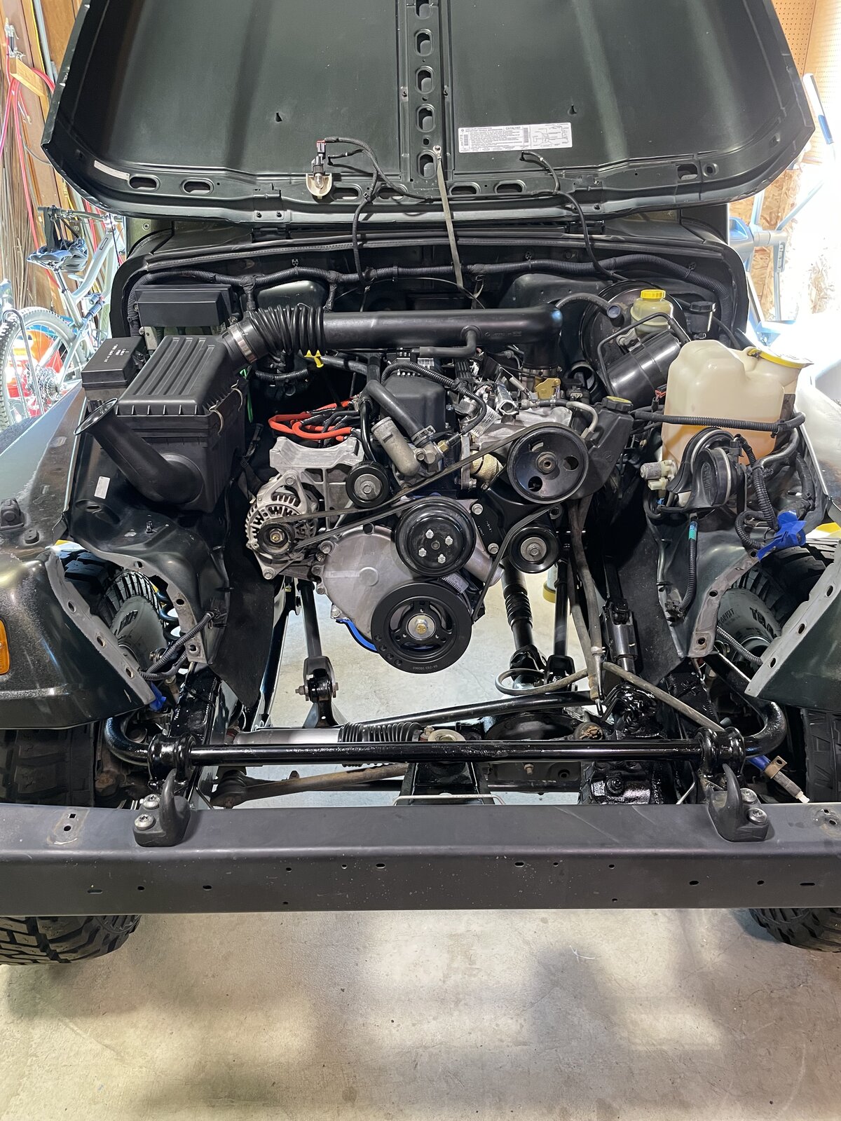

Airbox hooked back up, power steering re-mounted and belt on:

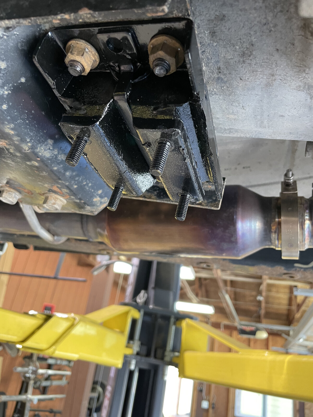

5. Finally, since the T-case skid was off, I took the chance to replaced the transmission mount
and spray a little rustoleum on the frame rails in that area until I can do a better clean up.
