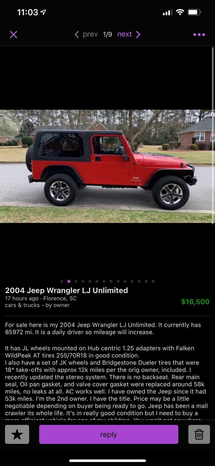

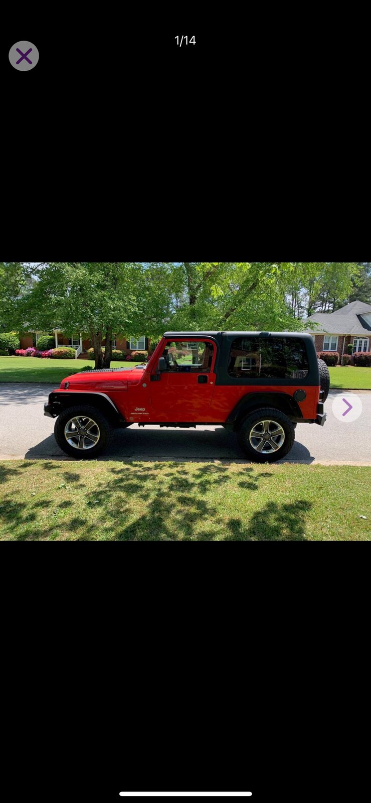

I had been passively looking at 3rd gen 4runners, diesel trucks, sequoias and wranglers for 18 months. I randomly opened Craigslist and found this listing. Previous owner knew his stuff, he walked me through maintenance history and was about 2 hours from my house. Bingo.
Here was the listing.
I asked for 1500 off if PO got to keep audio equipment, backseat and uncertainty around CEL being on. He agreed.

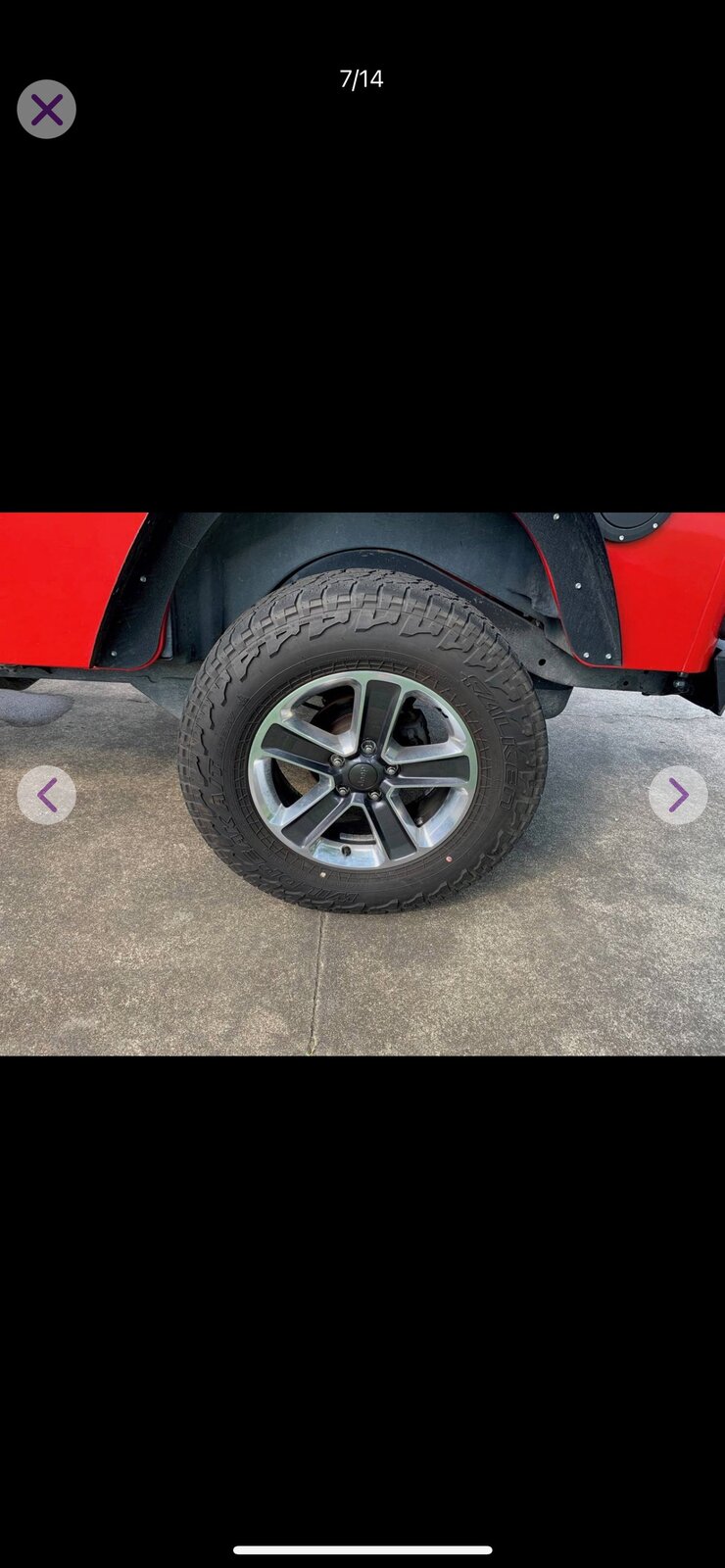

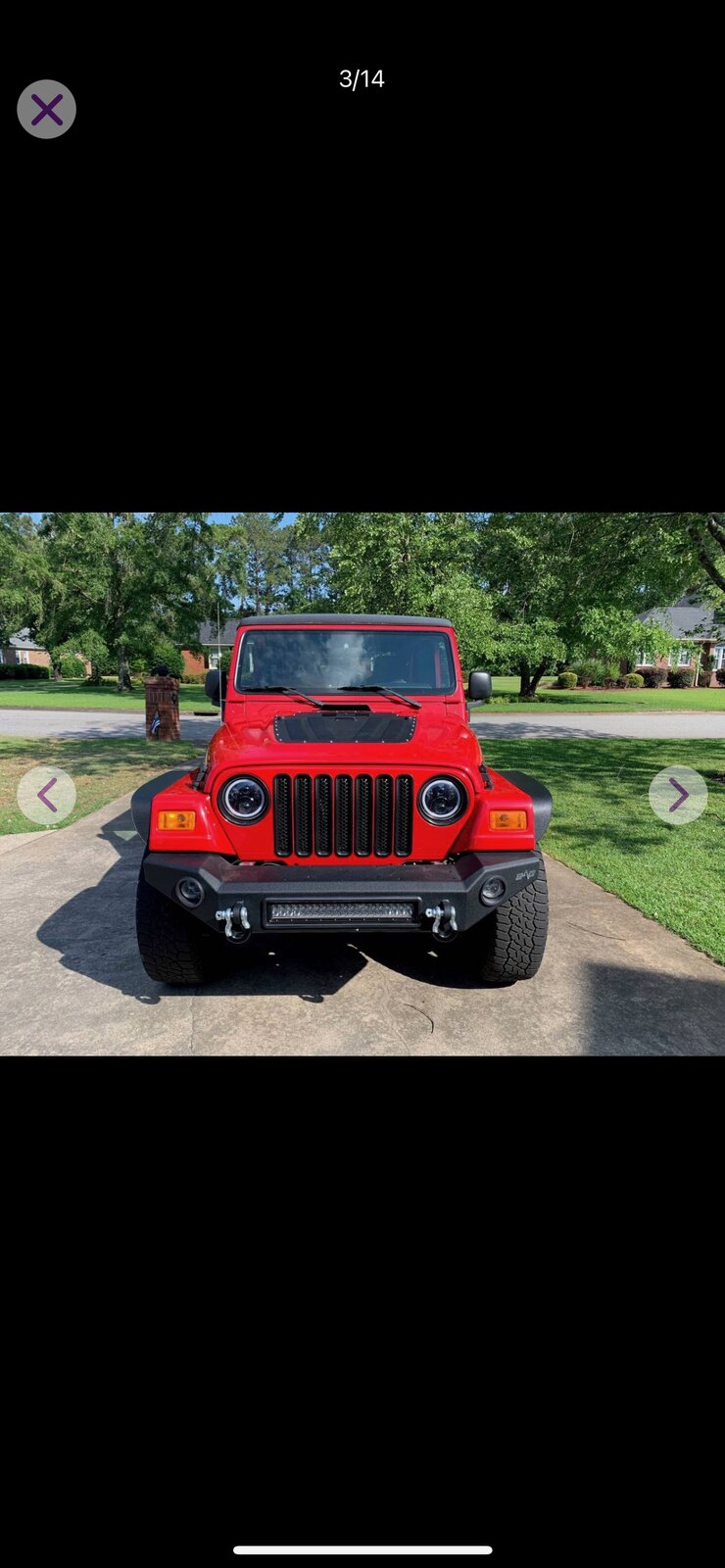

It has 2" pucks and 32" ATs on it. Cold air intake, JL wheels with adapters and an aftermarket exhaust of some kind.
Sadly, Its a big of a dog with the 3.73s. Not the mods I'd have done but at least it wasnt 20" rims and an angry grill!

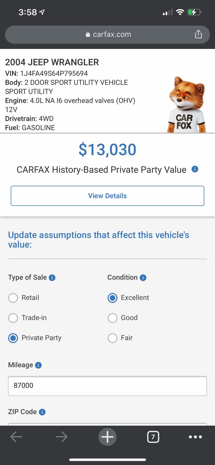

Carfax said "value" was 13k. Ok. If anyone can find me a near perfect condition LJ with 86k miles for 13k I will also buy that one 🤣

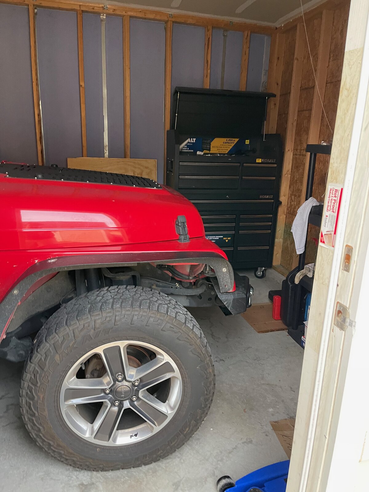

Jeep as it sat day 1. Dog loves to hang out. Garages are tiny in downtown Charlotte.
We are moving after wedding in April. 2 car is a requirement for the next house.

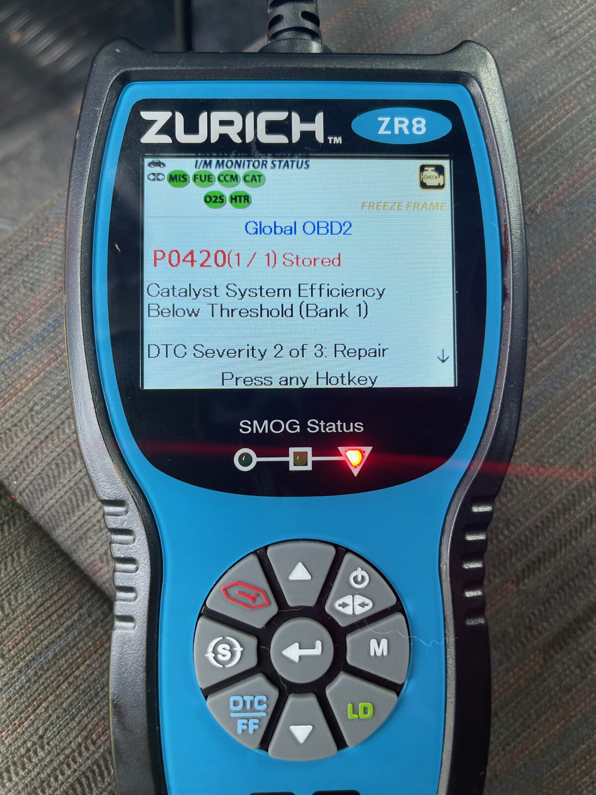

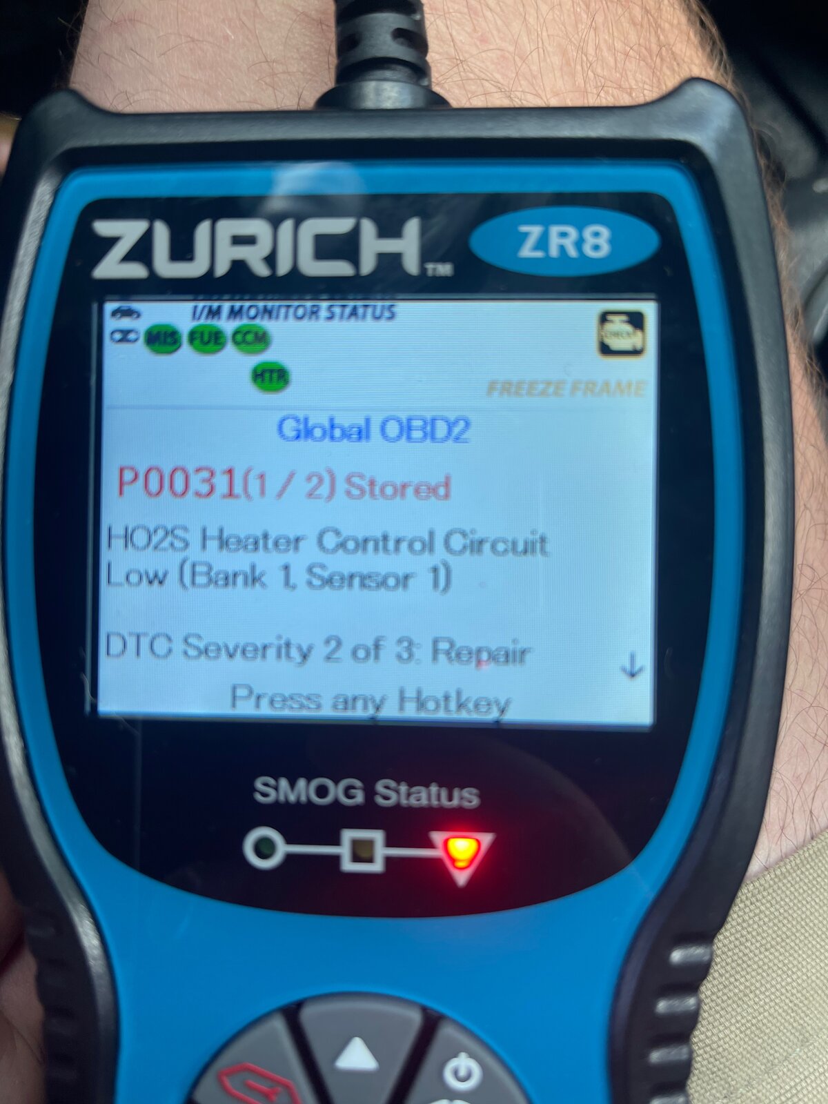

P0031 - H02S - Heater Control Circuit Low - Bank 1, Sensor 1 was present. There was also a Bank 1, Sensor 2 code as well, but I dont have a picture of that one.
Ordered all new O2 Sensors (NTK) and hoped. I didn't need all new ones but wanted to be sure of condition.
Fast forward a week and that didn't fix the issue.

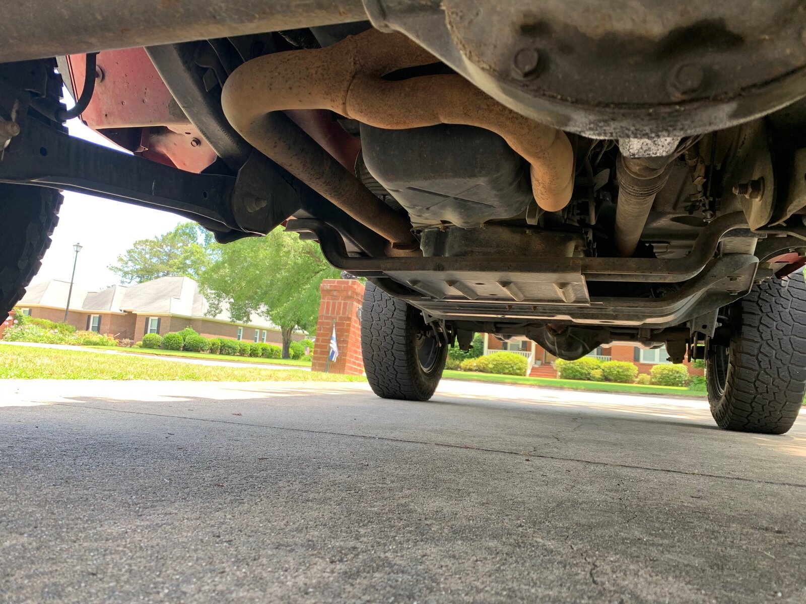

Fast forward another week and I had new catalytic converter from amazon installed ($350, not the $1500 it costs now) and the CEL was off.
Its been 7+ months and it hasn't come back so I am checking that box as complete.

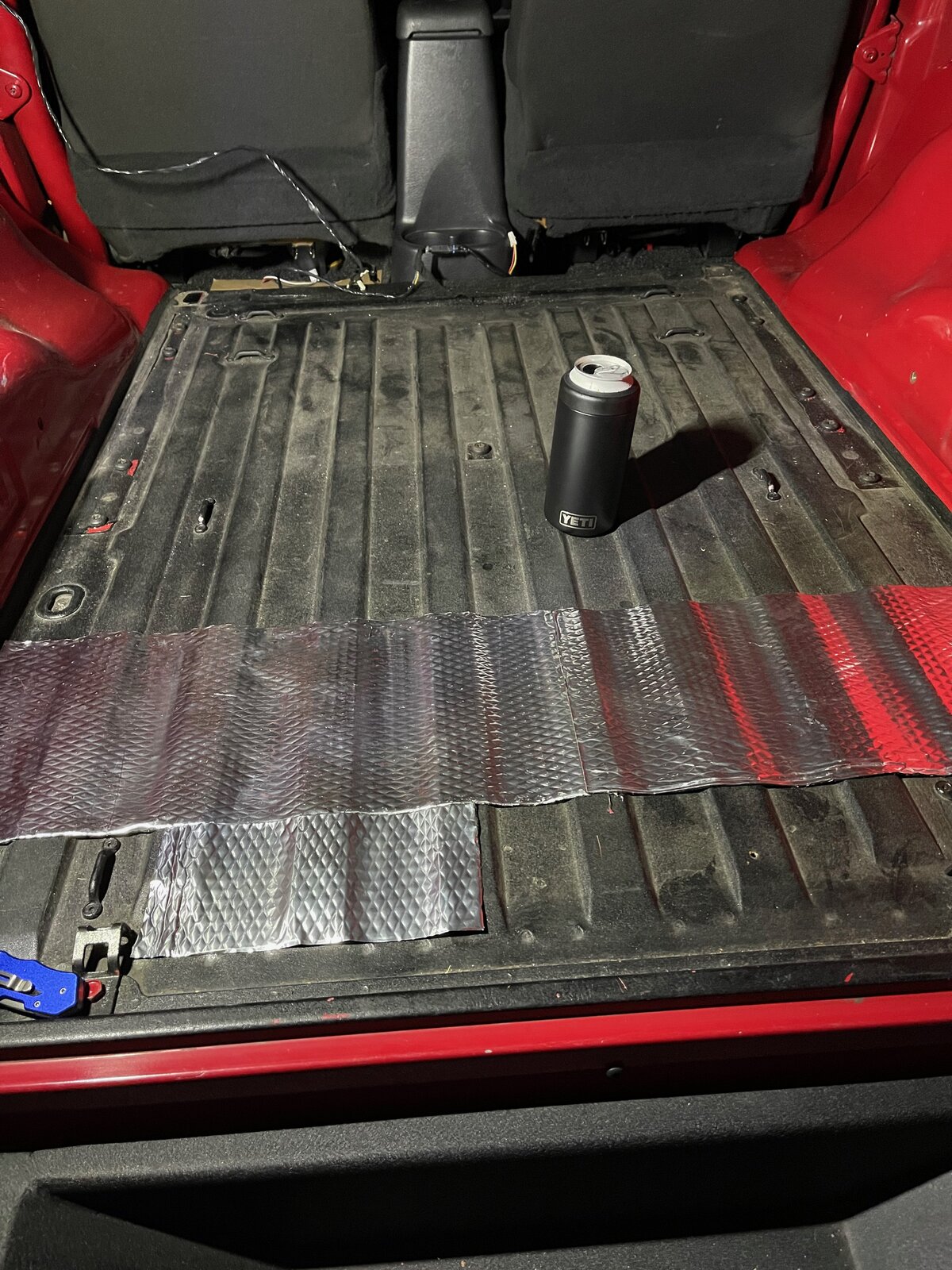

  • Sound deadened interior - anything I could do to make ride quieter.

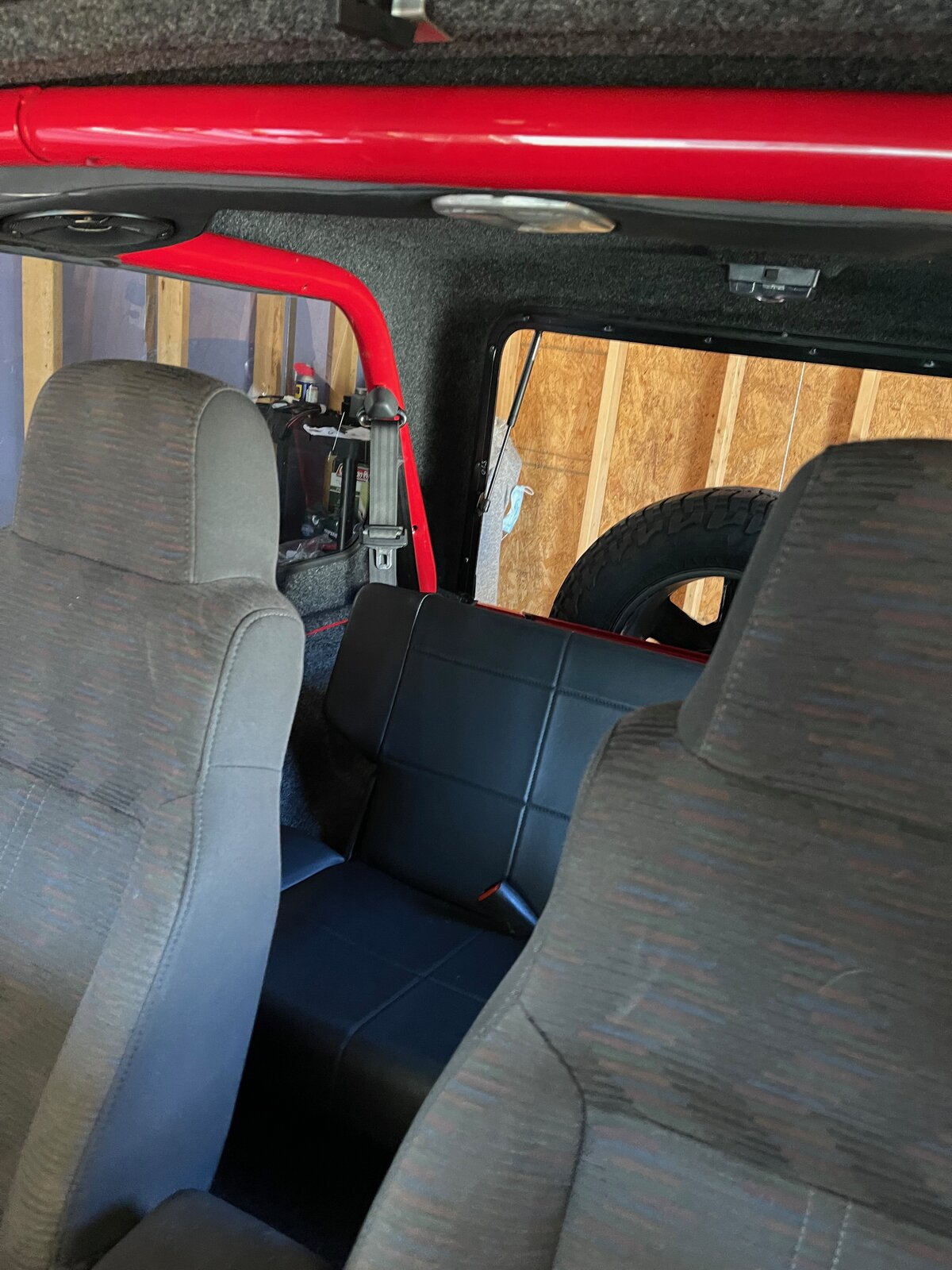

  • Installed backseat/rear seatbelts - Beach trip planned and we needed the seats

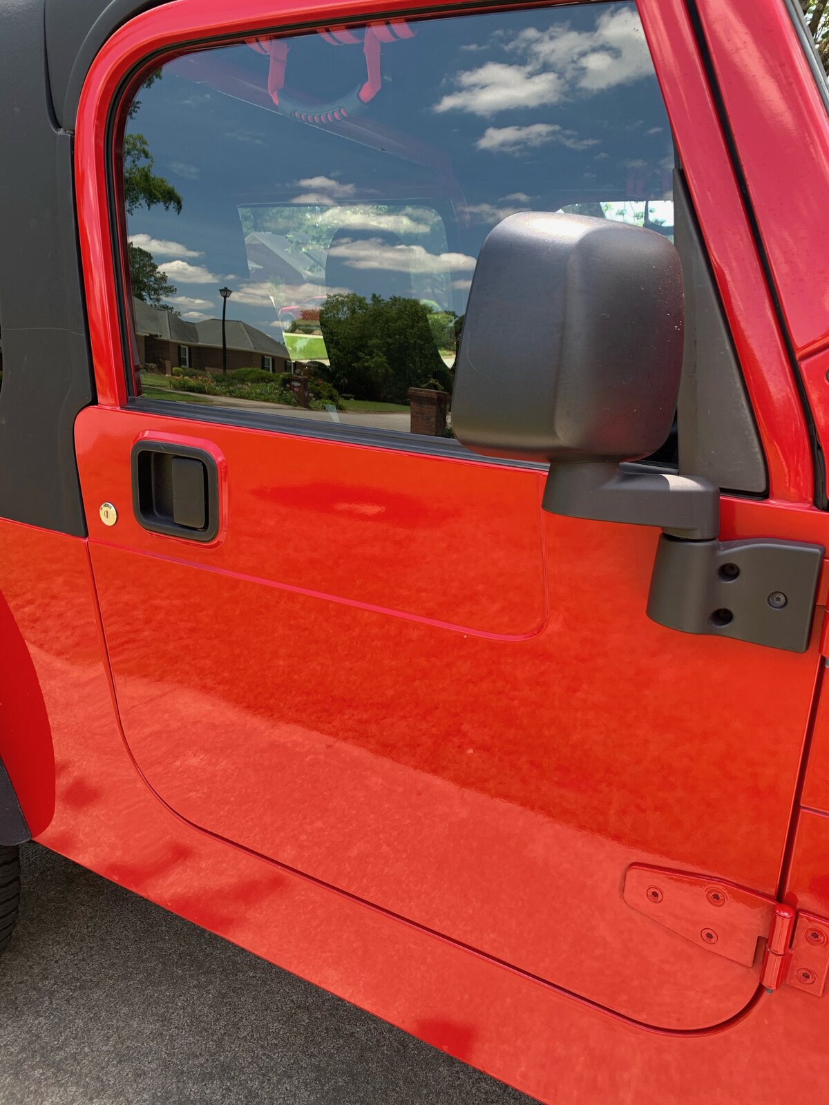

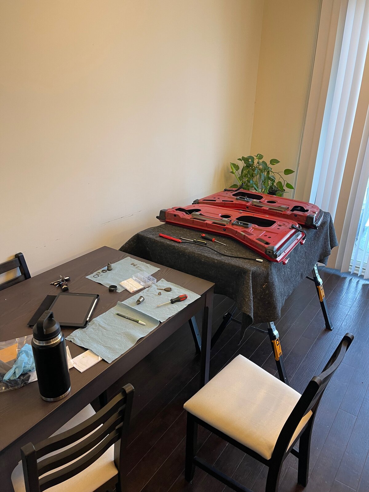

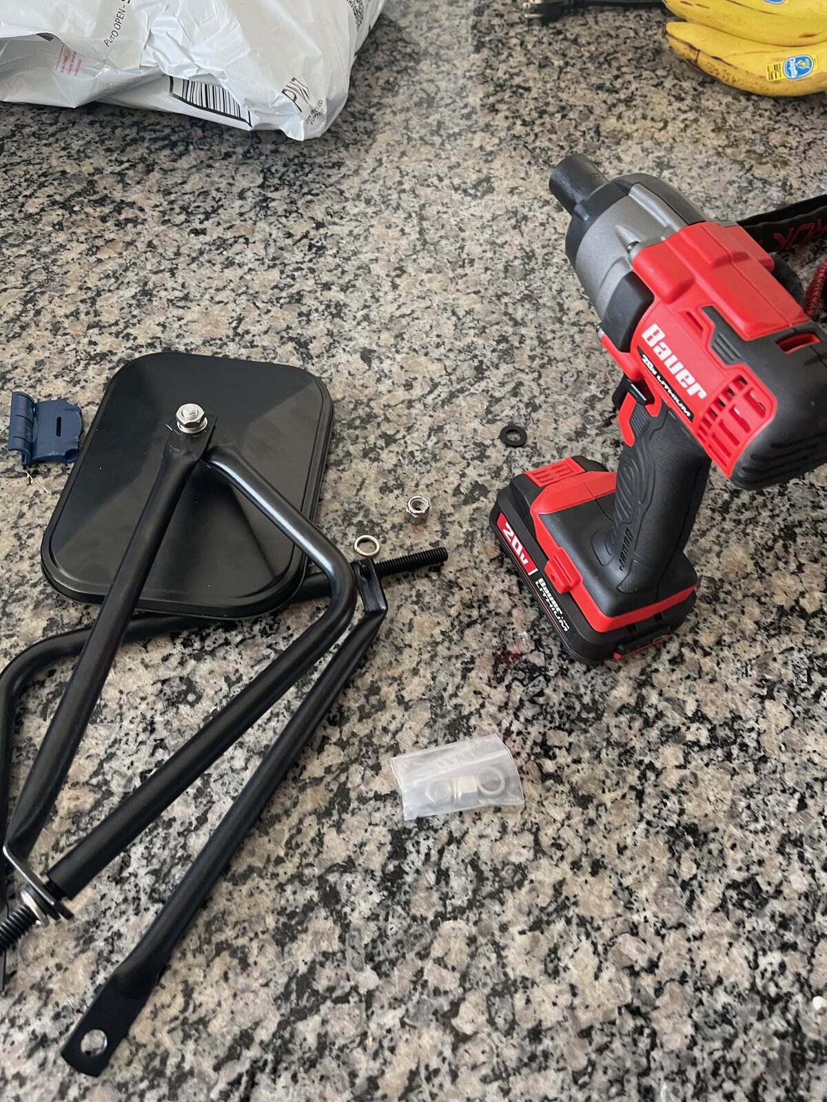

  • Moved mirrors from doors to body - NC requires mirrors and I didnt yet know about the "doorless" mirrors. This seemed logical at the time.

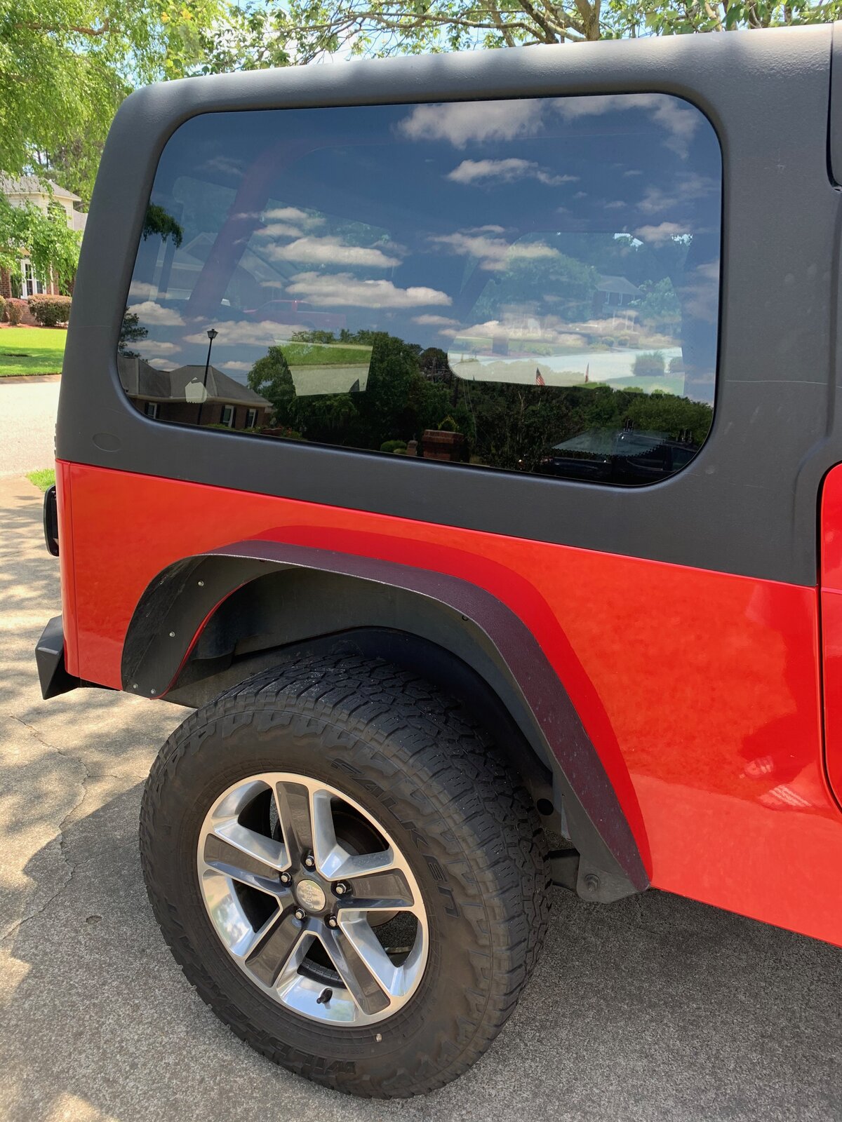

  • New rear window seal - previous one was leaking pretty bad.

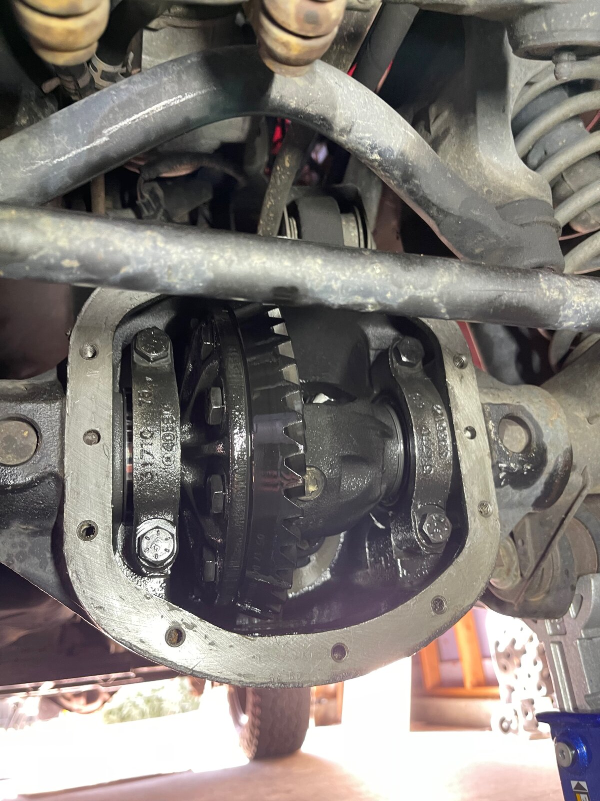

  • Diff fluid change - wanted to be sure of condition

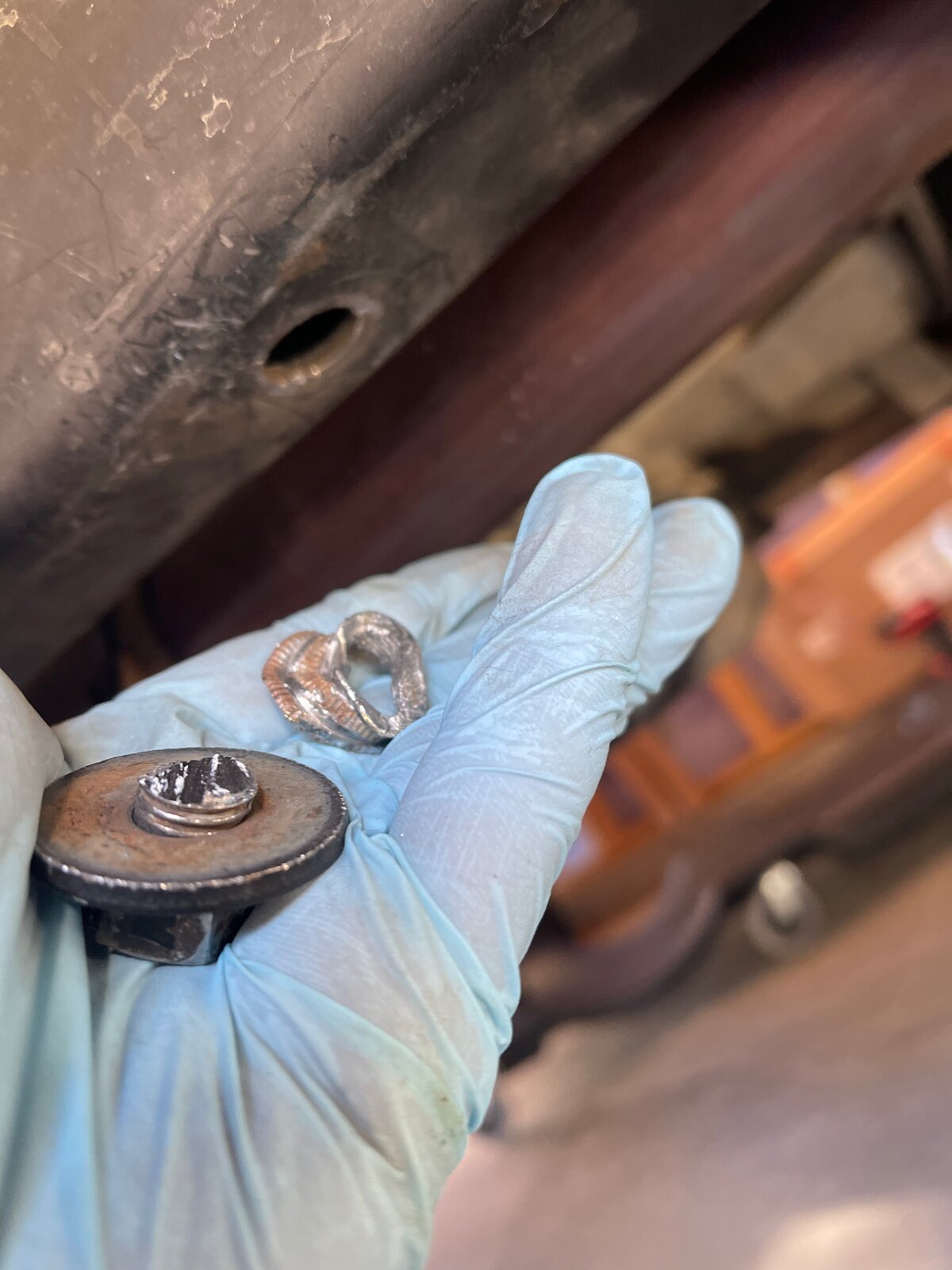

  • Nutserts - Had a stripped nutsert on the cross member by transmission. Was a PITA to get out, but I did.

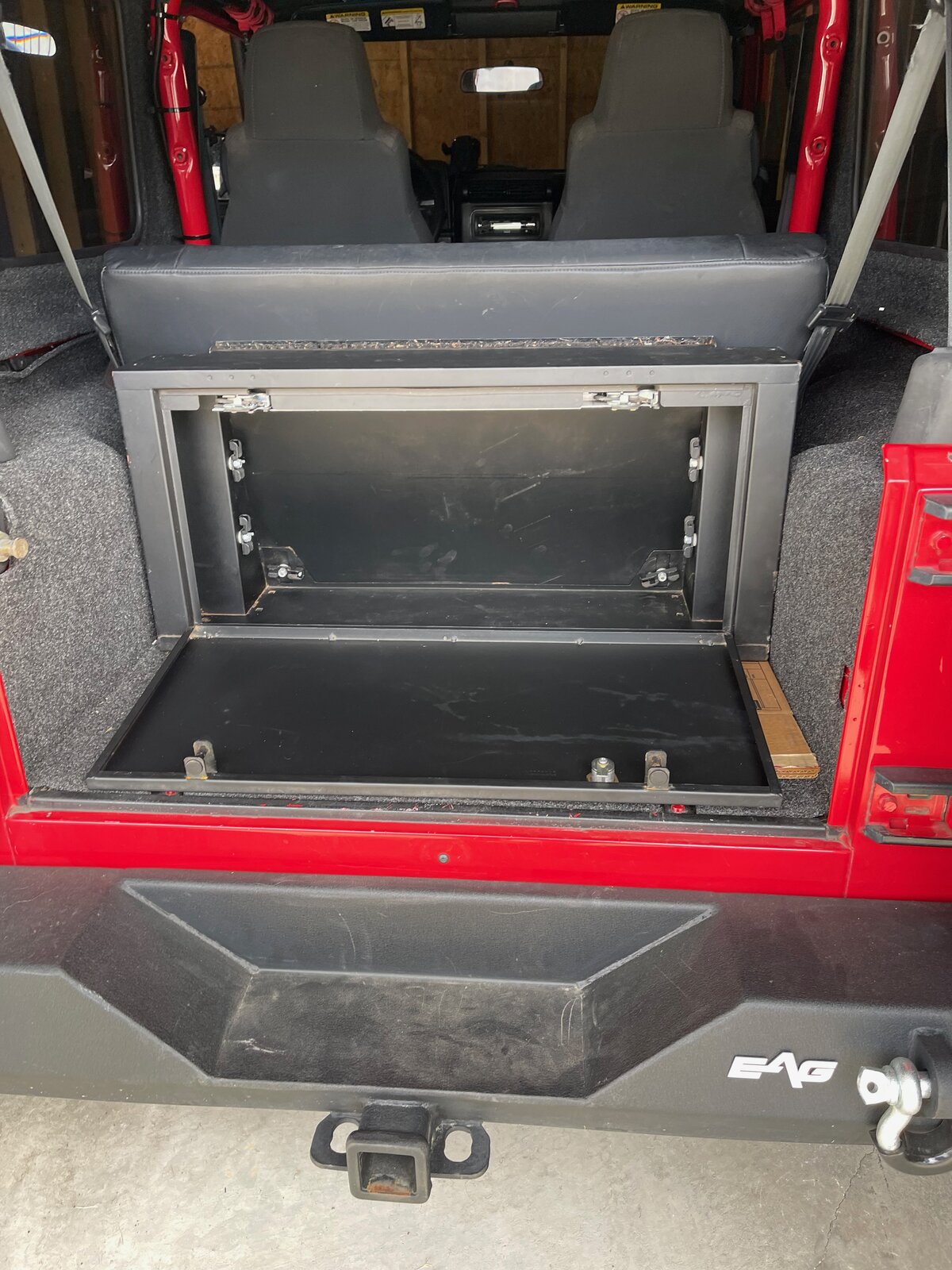

  • Unknown tuffy box - Its stuck closed so I need to cut the bottom out (its getting bolted to frame so this wont matter) to see if I can get it open.

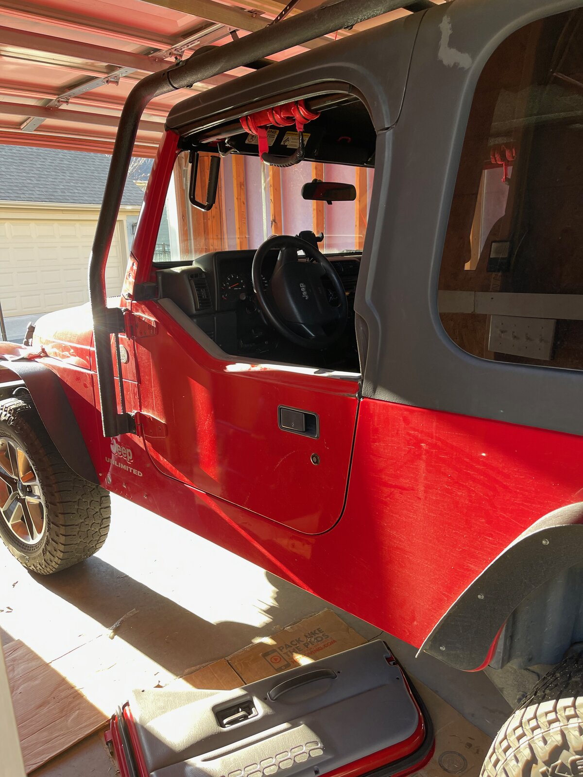

  • Half doors - decent condition half doors for a steal of a deal, some interior paint and the wafer set from ebay. Fast forward a month and I completed re-keying and coloring matching interior!
  • Steering stabilizer - came with LJ from previous owner. I didn't really need a new one, and wouldn't have purchased myself, but wanted it off the shelf in my garage. Took 30 min.

I picked up all the necessary tools to do a regear over the last few months. Sticking with my theme of learning myself before buying an expensive vehicle, the LJ will be my test dummy.

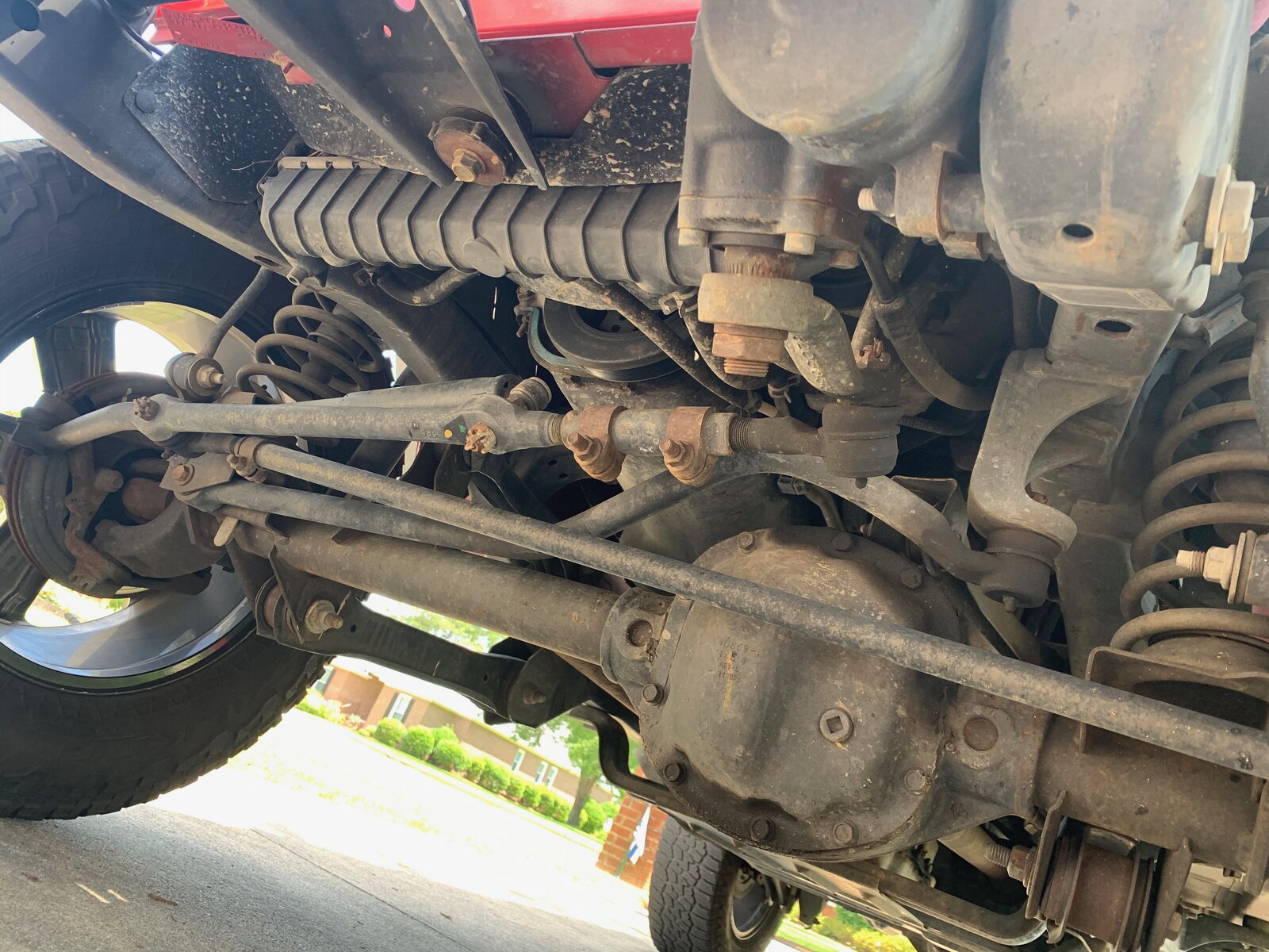

Phase 1 of build:
  • 15” Big brake kit
  • Savvy double adjustable aluminum arms
  • Cooling system refresh - also doing transmission cooler as well.
I posted a few days ago about a slight leak on the transmission cooling line from radiator to transmission. I intend on replacing that entirely with this refresh.
I need recommendations for track bars front and rear.
The final build goal is 35s with the standard 4ish springs + 1” body lift.
Ideally adjustable so plans could change and still be usable.
