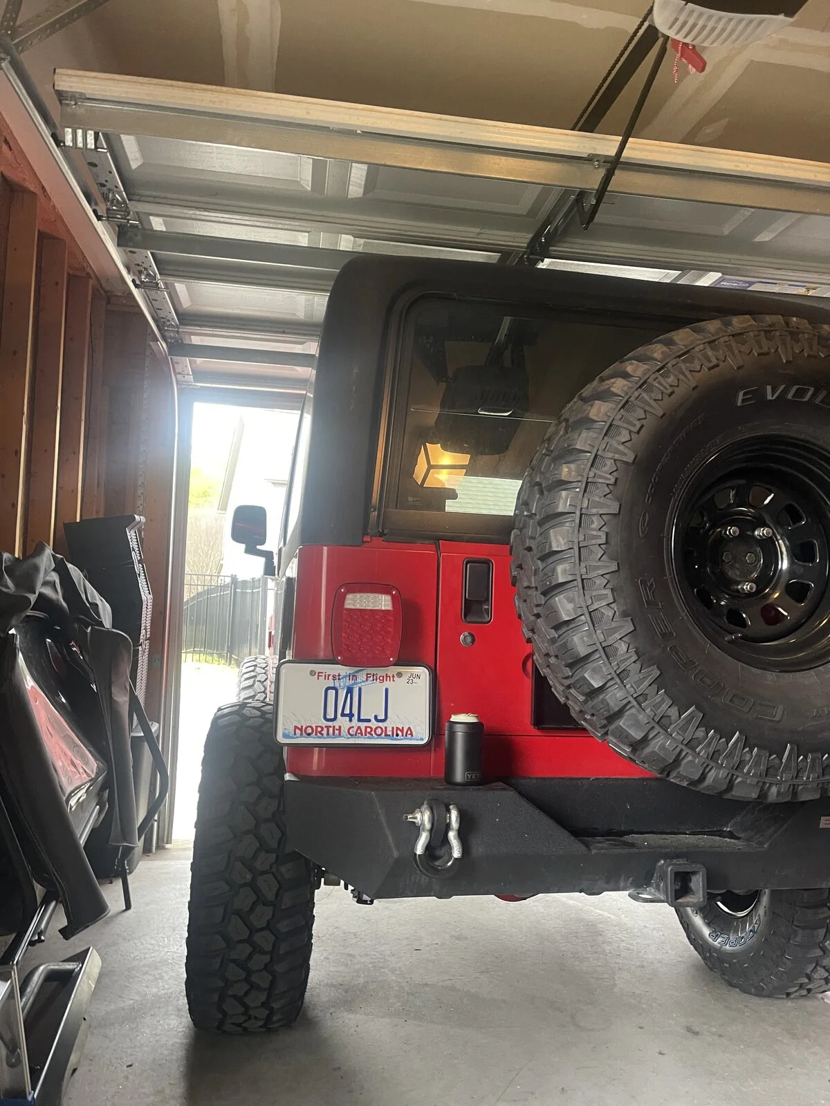

Built the exogate this weekend to hold the 35" spare. Went on super easy.
Really frustrated with Savvy. Ive contacted them multiple times about my missing body lift puck and no response at all. Luckily Rasband is sending me another one (since the first replacement he sent got lost in the mail) but Ive ordered 3 things from Savvy and 2 of the 3 had issues.
Hopefully get jeep drivable again this weekend once the new puck arrives.

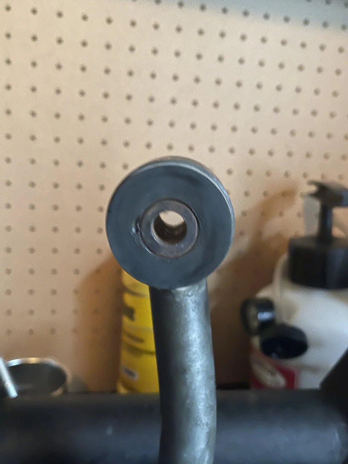

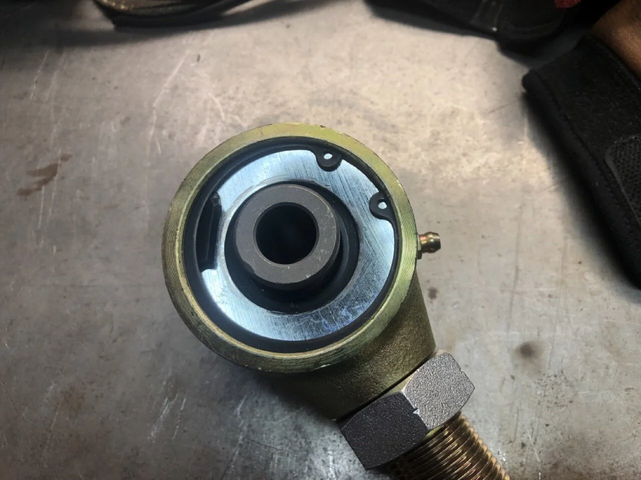

how do I rebuild this? It’s the diff side of Currie front trac bar. Do I just pull the black rubber off and then press out with Johnny joint tool?
I was able to press the rubber and center sleeve out with a ball joint press. The outer sleeve was still in there, so I used a small hack saw to cut a groove and then bent the sleeve and pushed it out. There's probably a better way but this worked for me.

After a talk with Currie, I learned the diff side of the trac bar I have is not a Johnny joint, its the old style poly bushing.
If anyone else runs into, you have two options. Either replace the rod end for the new johnny joint end (most people have this by default) or replace with this rebuild kit https://www.rockjock4x4.com/CE-9120TJJ-BK
I just ordered replacement rod end so both of my front/rear trac bars are like new.
