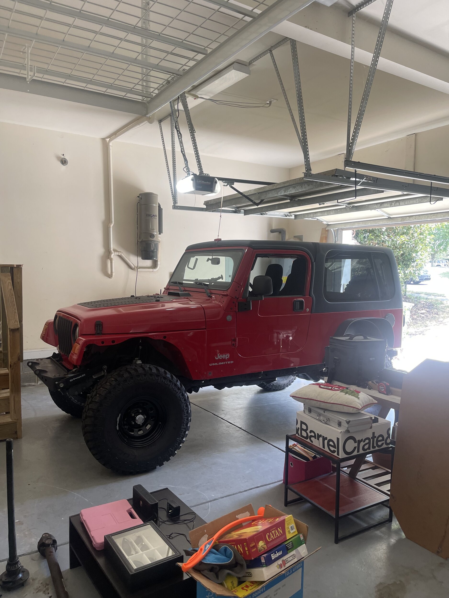

I’ve been quiet on the forum for the last few weeks. Mainly because we were moving.
Finally got to break in my Mac’s tie downs and test out the tow rig.
Truck did great and now I have a lot more space to do projects!

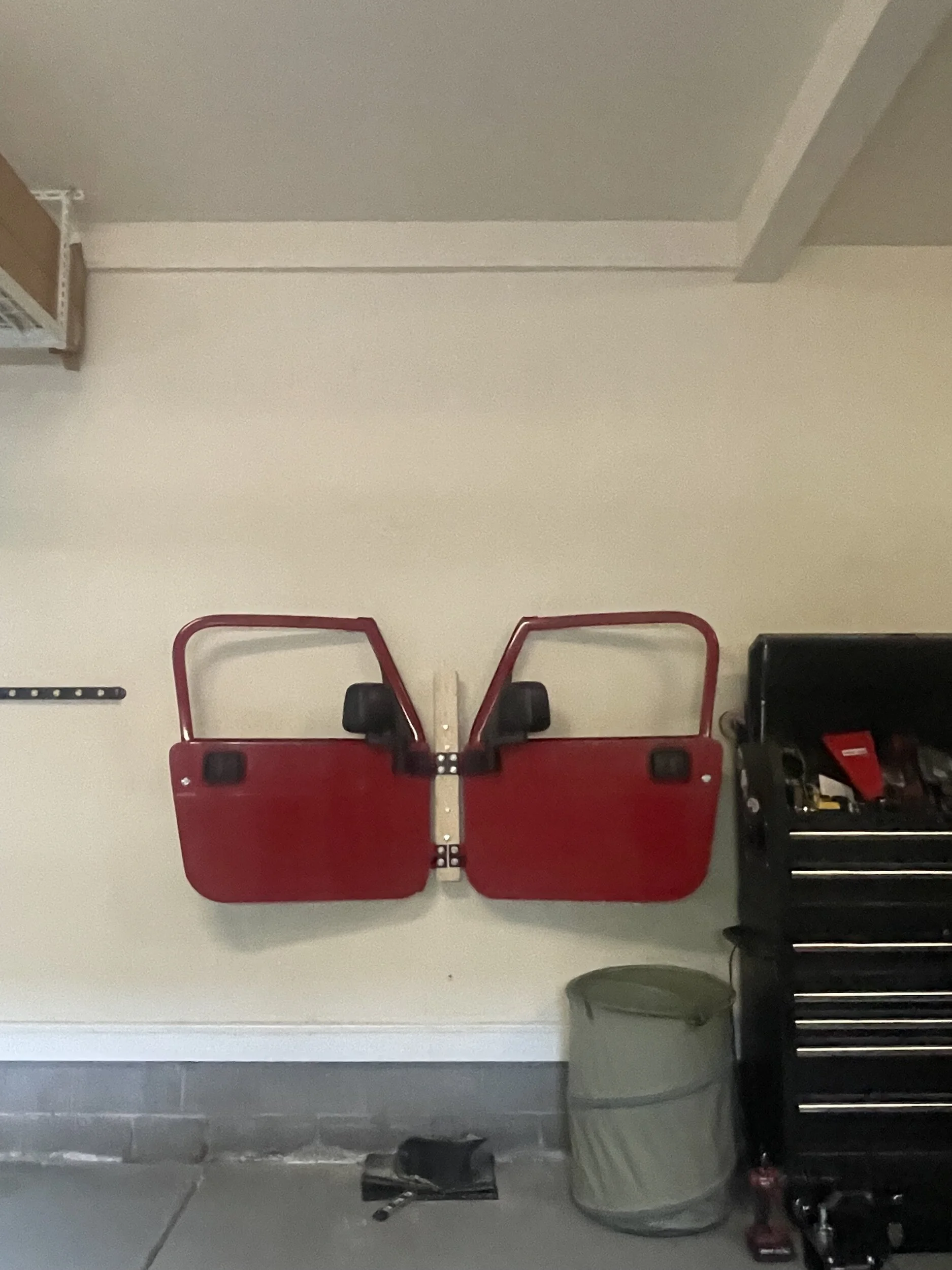

Last nights project was building this door mount for my garage. I had same design in my old garage. Very simple, 2x sets of door hinges, some 2x4s (scrap from work bench I built) and lag bolts.
The top of the 2x4 is left open because I’m building a hoist for my hardtop. Winch is being mounted there.
I mounted higher off ground this time because I rarely take these doors off the wall and wanted to retain floor space under the doors. Doors are right at height where I can drop them into hinges.

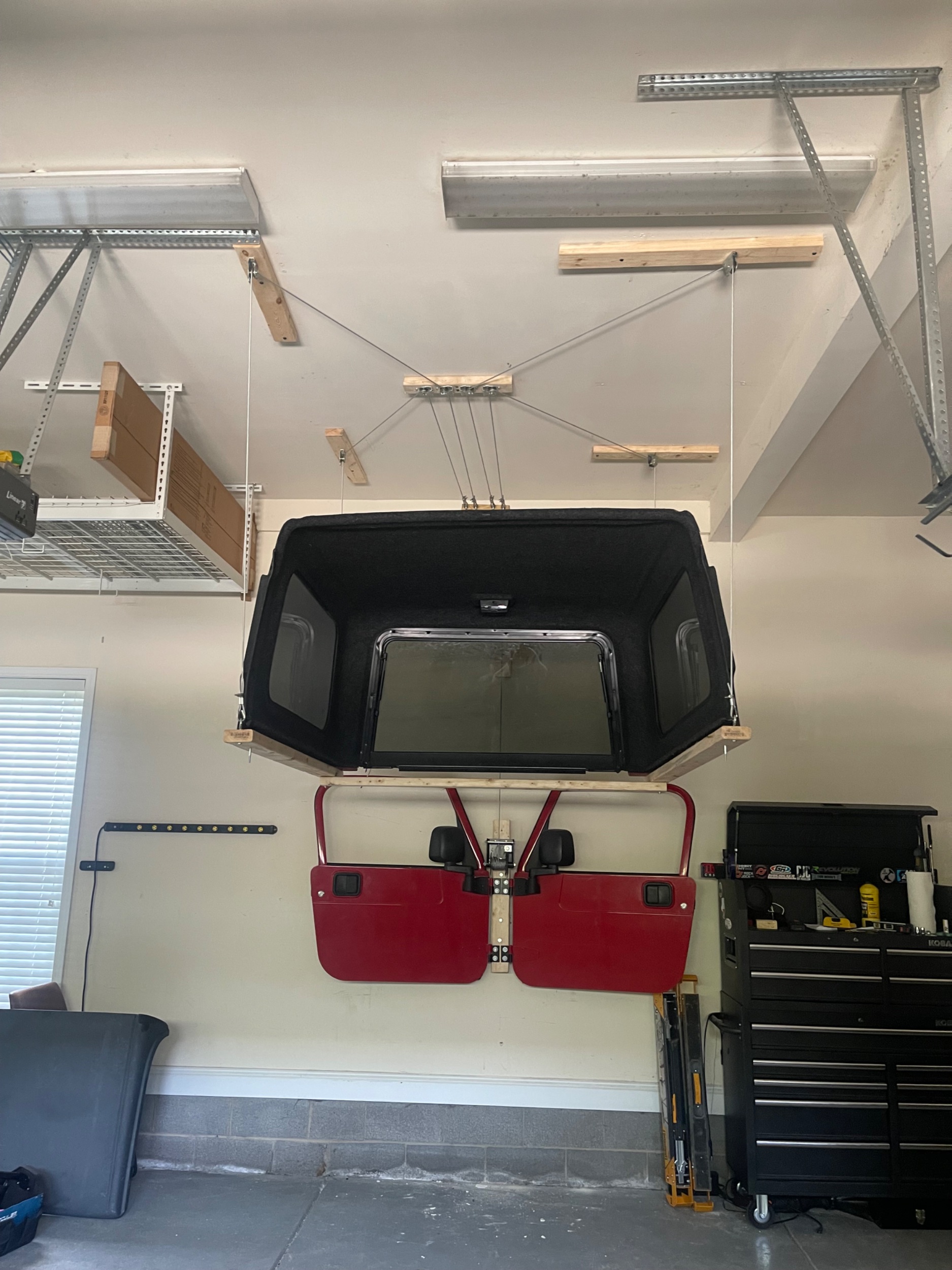

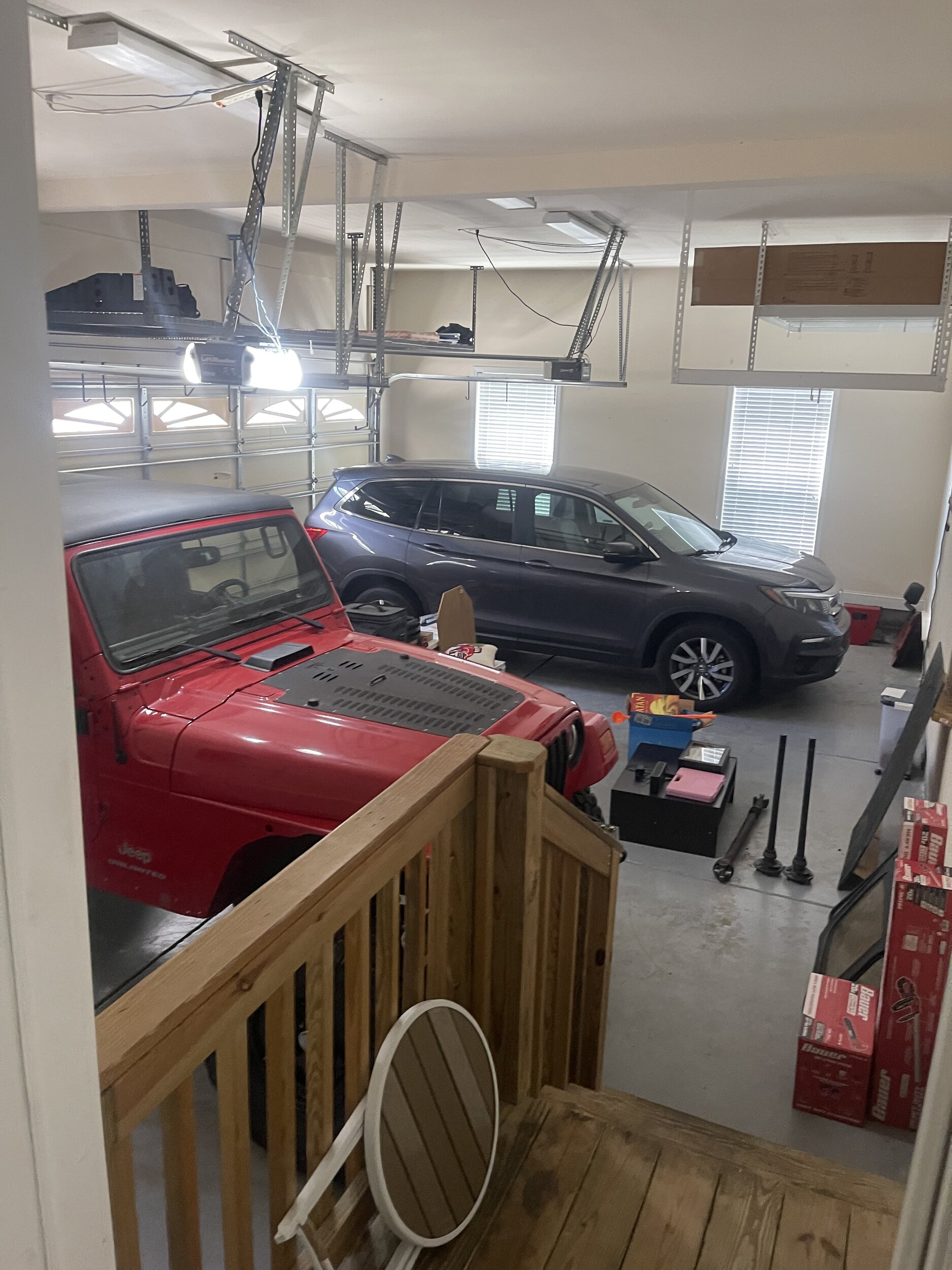

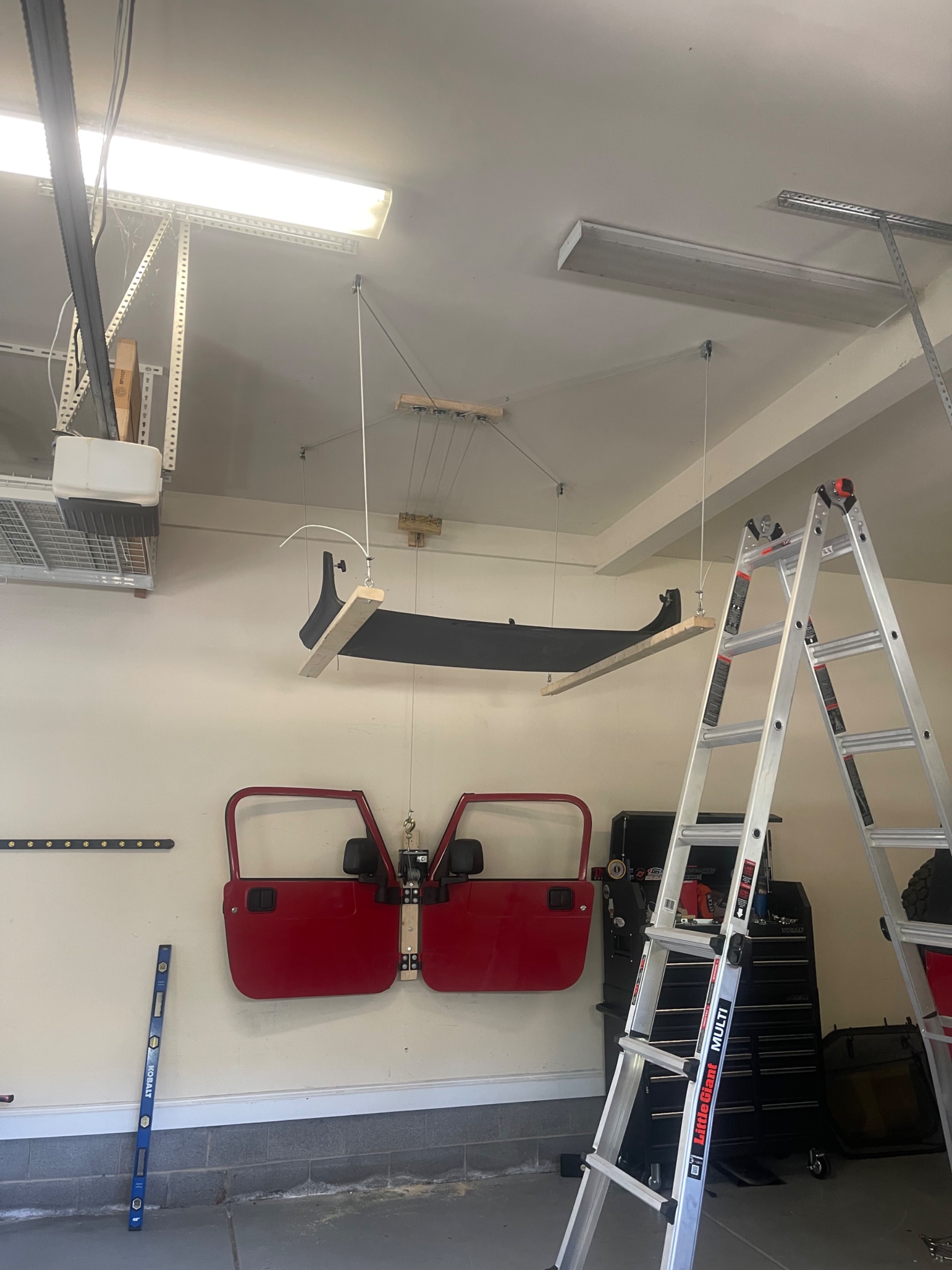

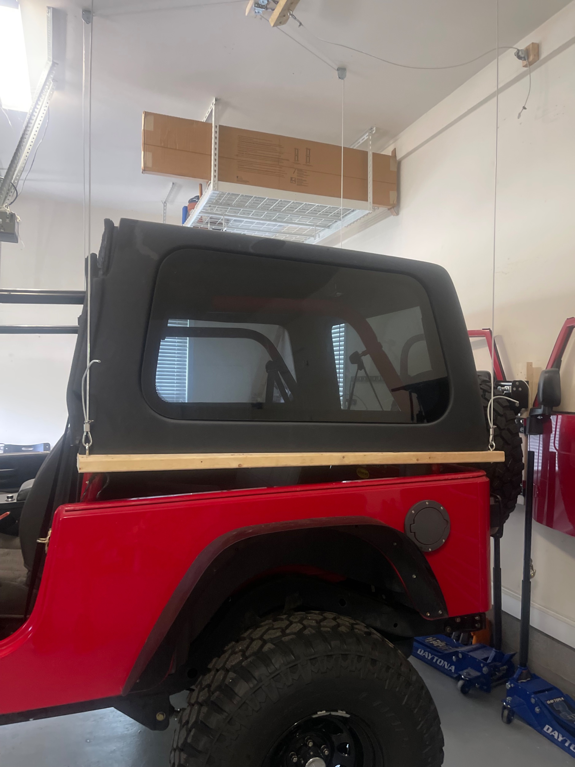

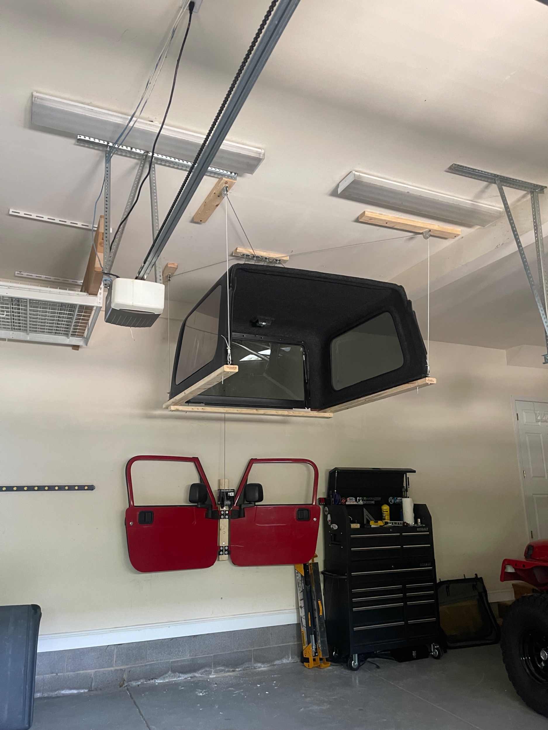

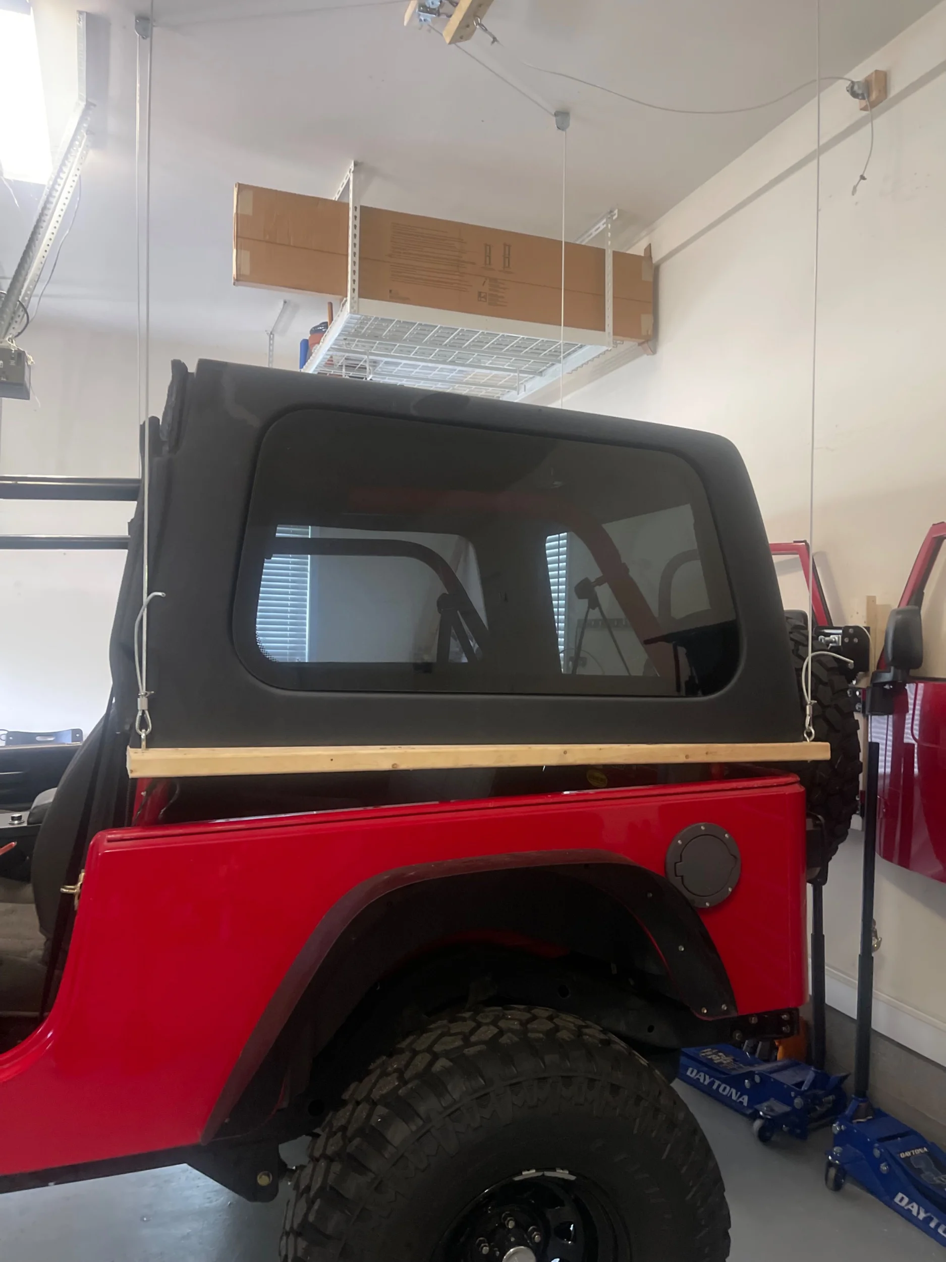

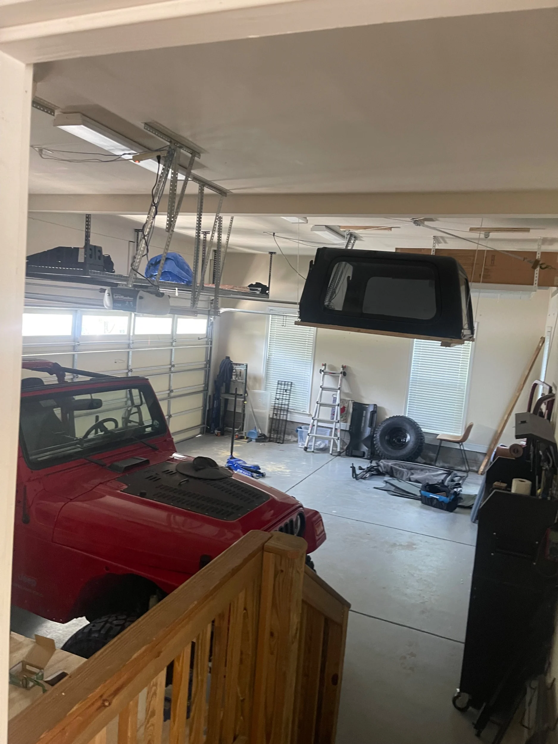

My most recent project has been building a hard top hoist. I don’t intend on using my hard top much at all and didn’t want to tie up floor space. My wife has back issues and we’ve taken the hard top off 1 time in 3 years of ownership. I needed to build something to let me take it on and off without phoning a friend.
Here’s what I ended up with. These pictures show a few different “versions” as I worked out the kinks.
I have a rally tops 2 piece hard top for an LJ. it’s somewhere in the 1-120 pound range.
I used a hand crank harbor freight winch (driven by a drill). Takes about 30 seconds to go all the way up. I just bought a house and went cheap route vs the electric hoist. Needed to use the funds for other things.
I used 2x4s cut to length with eye bolts. 2x4s are around 63” inches. My hard top is a little over 60”. That lets me sit the hard top right inside the eye bolts.
The wire is Amazon special. It’s steel braided wrapped in some plastic coating. Says rated for 1000 pounds but I seriously doubt that. At the <150 it seems fine. I wouldn’t put much more on it.
Pulleys are Amazon as well. I used 9 total. 4 on each corner. 4 at the center “distribution block” I guess you could call it, and 1 on the wall. I thought about incorporating double pulleys to reduce power needed to raise the top but decided against it bc 150 pounds is not a lot and I didn’t want to have double the distance to travel.
I wanted the top to be suspended the same way it sits on the Jeep. I didn’t want to have the rear glass open either. So my design ended up being 2 “arms” the length of the mounting surface to the tub.
The top sits on these rails like the top sits on the Jeep. I back in to garage, unbolt hard top and lift up a corner to slide the 2x4 under. Takes all of 20 seconds.
I have 2 pieces of wood (you can see the back piece pictured here) that screw in to make a square platform. This probably isn’t needed but it does provide a lot of stability and allow me to store my freedom panel on the hoist as well.
I intend on gluing pool noodle to the 2x4s where they might contact the side of the Jeep as a layer of protection.
All in around $100ish bucks. Maybe $150 if you count some mistakes I made. Solves my problem.
These pictures make it seem like there’s a slight angle while suspended. That isn’t accurate. It’s probably the angle I took the picture. I stood over with a level to ensure it was perfect.
I played with the height fully raised quite a bit and settled on what is pictured here. It’s probably 6’ above my head. I wanted to keep the top away from the actual wires but suspended enough to not be in the way.
This seems to work.

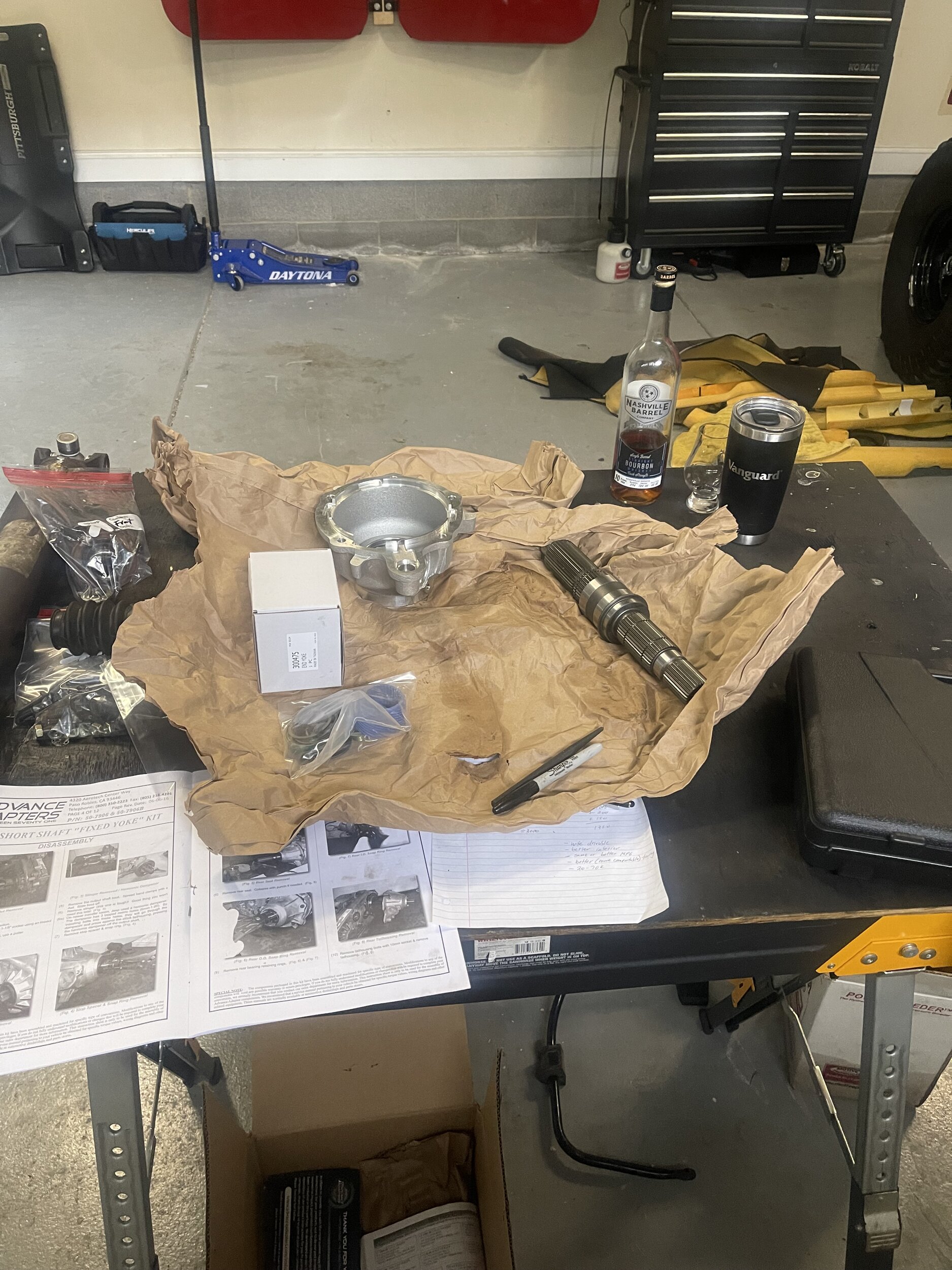

Hour into SYE install. Both driveshafts are out, TC is draining and only one broken bolt. Bourbon came out after bolt broke in half
Hoping to have SYE wrapped up today. New driveshaft is out for delivery.
Hour 2. It’s clear someone has been in here before. Snap rings and retaining rings are out of “order” based on what factory says, lots of RTV everywhere.
