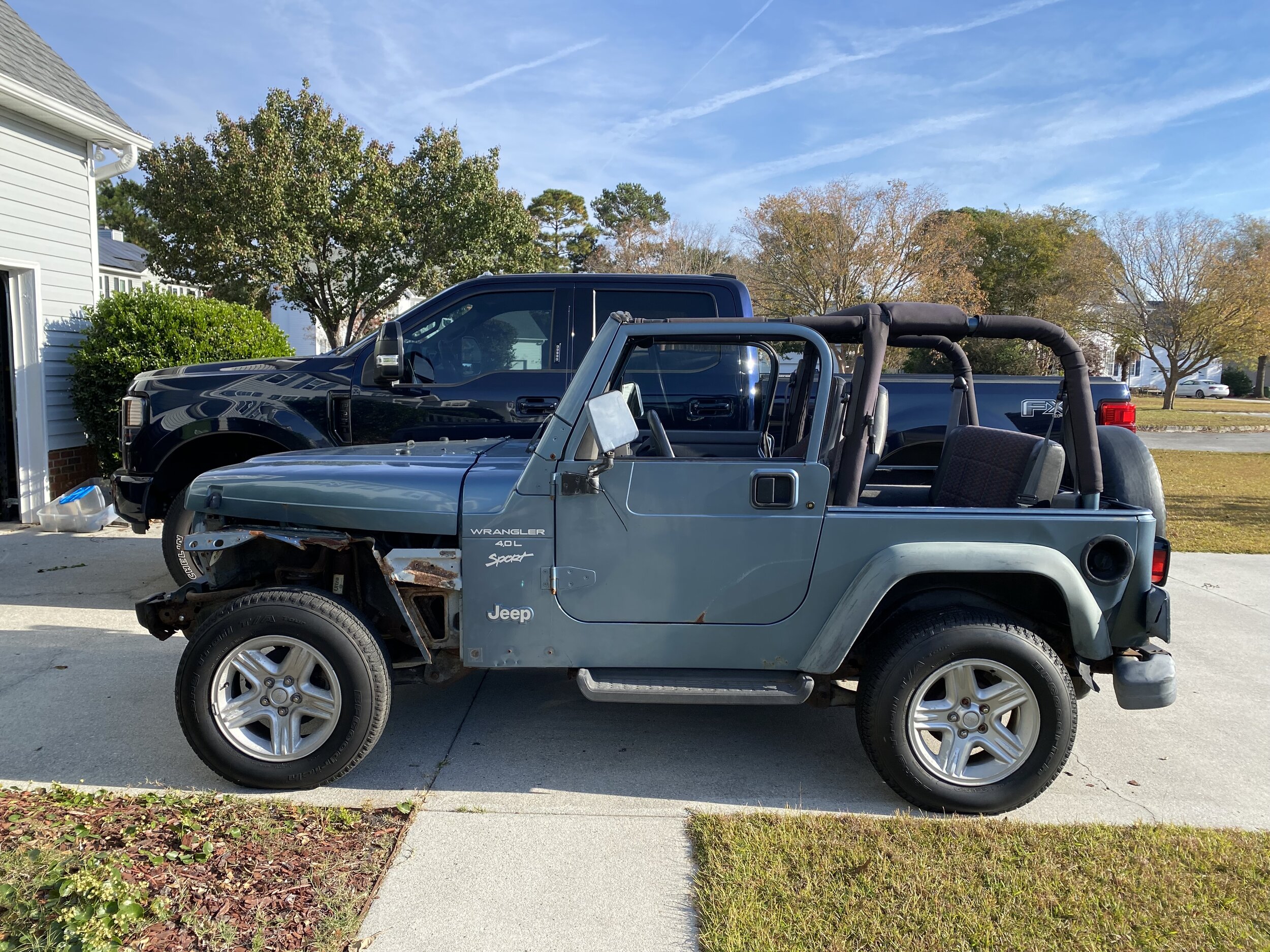

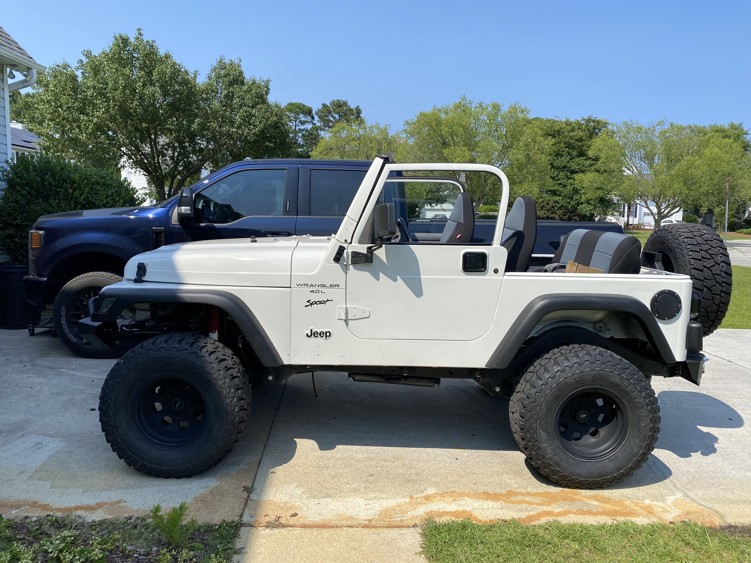

Current picture versus what I started with. It has been a full, from-scratch, build. New frame, body, paint, lift, axles, all suspension and steering, clutch, pressure plate and bearings, engine tune up, all fluids, bumpers, everything! I just want to start taking it to the beach and I’m stuck chasing these issues.
