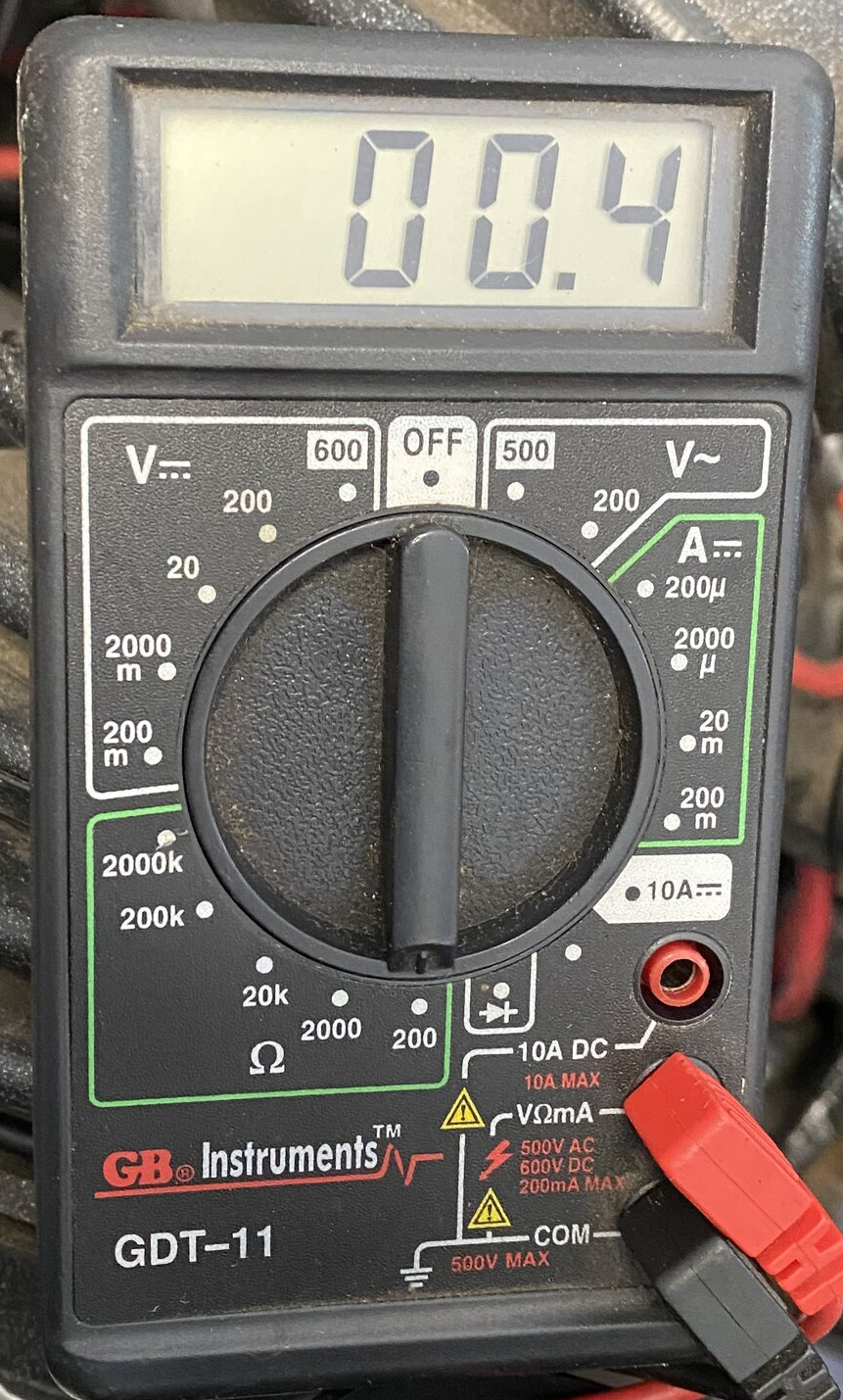

I want to get to the question I asked, but first, I want to make sure you're interpreting your multimeter correctly. One of your last posts makes me think that you are not. At the 200 setting, with 0.4 on the screen, how many ohms are you reading that as:
That's 0.4 ohms on most meters. In fact, all digital meters I've ever used. I'm not saying you're wrong because I've never used your meter. However, I downloaded the instructions for it, and there's no mention that the reading needs to be multiplied by a scale factor depending on the dial setting. The reason meters have different scales is due to how they work. They are digital devices used to measure an analog signal. Inside, there is a chip called an analog-to-digital converter. Due to limitations in that chip, they put a scale selector on their to make it useful for measure a 2 ohm resistor and a 2,000,000 ohm resistor (the upper limit of that meter's range). If there was no selector, and it was still capable of measuring 2,000,000 ohms, it wouldn't be able to measure anything even close to 1 ohm. In fact, on the 2000k setting, it can only detect at about 1,000 ohm increments.
We first need to figure out how to read your meter, and then we need to reconsider whether the numbers you've been sharing are the number on the meter, or the number you calculated.

Well that would be my inexperience and not fully understanding how to read it. I thought I had read online that there was still a multiplication needed for2 200, but I likely read that wrong. I'm sorry for causing us extra work.
How you read it on the screen is how it is when it is hooked up. Take my mistake out, and from your reply, that means this is 0.4 ohms?

I also need to clarify then that the 0.07 ohms of resistance that I was reporting earlier is wrong. If I put it on the 200 ohm setting, it reads as 74 ohms.
Ok, it's been a busy day, so I haven't had much free time. I called Gardner Bender and talked to tech support. The very nice rep confirmed my suspicions - whatever the display reads is the resistance value. Do not scale it manually. So, with that behind us, we'll have to trudge forward. Unfortunately, the busy day will continue, so my responses will be sporadic for a bit.
If the display reads, "0.4" that means 0.4 ohms, no matter the dial setting.
When the wire was broken at C154, and I had to have it on the 20k setting, what was it reading when it was at 0.76?
Now this confuses me again. On the 20k setting, it shouldn't have a decimal point. Are you sure you're getting a reading of "0.76" when on 20k?
What is the reading with the probes not touching anything (or each other)?
I'm really sorry for steering us wrong.
No worries - it's part of the learning process!

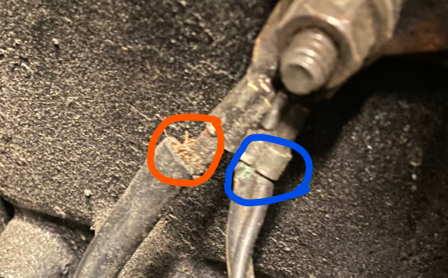

I've reread through the thread again this morning, along with my first cup of coffee. I noticed something in one of your pictures. You took a pretty nice close up of the ground location on the block (and G105). I circled them in the pic below:
In the blue circle, I see corrosion (the green stuff). That is G105. Please take a resistance measurement between that ring terminal and G154, pin 1. I would guess that to be relatively high resistance.
In the orange circle, I see some frayed wires. I don't think that is causing an issue, but it IS the main engine ground back to the battery, so Its carrying the load from the starter. I'd probably get some new battery cables, once you get this figured out.
I've reread through the thread again this morning, along with my first cup of coffee. I noticed something in one of your pictures. You took a pretty nice close up of the ground location on the block (and G105). I circled them in the pic below:View attachment 536513
In the blue circle, I see corrosion. That is G105. Please take a resistance measurement between that ring terminal and G154, pin 1. I would guess that to be relatively high resistance.
That's a good catch, Mike_H. Exactly the type of thing that can cause a bad ground.
Thanks for pointing this out. I will plan to replace these wires as part of this process.
So if the ohms across the entire path are 0.4 ohms, that's not a bad ground, correct? You mentioned it should be at 0 or close to it, but that wires do have some resistance in them. So through several feet of wiring, is that resistance okay?
Correct. I went back and looked at my picture. At the 20k reading it was 0.76. There was a decimal.
It says 1. or just 1 I think, the "infinite resistance" default it goes to.
No, I wouldn't necessarily say 0.4 ohms is okay. See point 2 in Post #83. Unless that entire path is 40' of wire, that's too much resistance, and with the small amount of current from the meter, compared to the higher current when the relay coil energizes, that may be enough to indicate a problem. A test light on that circuit might provide more information. If it won't light, or is dim, it would show that the ground circuit isn't working.
Well, that's a head-scratcher. Usually, on 20k, there wouldn't be any decimals, and certainly, it shouldn't be more precise at 20k than 200, which only displays one decimal place. I'll explain a little more about the analog-to-digital (A2D) converter chip, and how it works, but be prepared, you're about to travel down a geeked-out engineering rabbit hole. Buckle up.
Your meter is a "GDT-11." I think the 11 means that it has an 11 bit A2D chip in it due to the scale breakdown on the dial, and based on a tenths decimal place when in 200 ohm mode. Here's how I jumped to that conclusion. The number of bits of an analog-to-digital chip tells you how big the measurement interval is. Each bit is a unit of measure. On the 200 setting, since you have tenths of an ohm capability, that means in absolute value terms, that the minimum value is 0.1 ohms and the max is 200.0 ohms, in 0.1 ohm increments. Bits are powers of 2. Two raised to the 11th power is 2048. If you go from 0.1 to 200.0 by 0.1 increments, there are 2000 possibilities (not counting zero). That's very close to 2048.
What the 11 bit A2D chip does, is whatever dial setting you use, it divides that number by 2049 (because zero counts, so you add 1 to the 2048), and that's your increment of measurement. As you change the dial, the minimum increment changes. This is called the resolution. There may be some other circuitry that does other conditioning and display values in between these increments, but that would just be manipulation of the numbers, not actual measurement. I'm not an electrical engineer, so my understanding is incomplete. So, here is the increment of measurement for each dial setting:
200 ohm is 0.1 ohms (slightly less, actually, but the display won't show hundreths of an ohm)
2000 ohms is 1 ohm
20k ohms is 10 ohms
200k ohms is 98 ohms
2000k ohms is 977 ohms
So, to see "0.76 ohms" on the display for the 20k setting is odd. It should jump from 0 ohms to 10 ohms, and display nothing between them because the 11 bit A2D chip can't discern a difference smaller than 10 ohms on the 20k setting. Weird!
