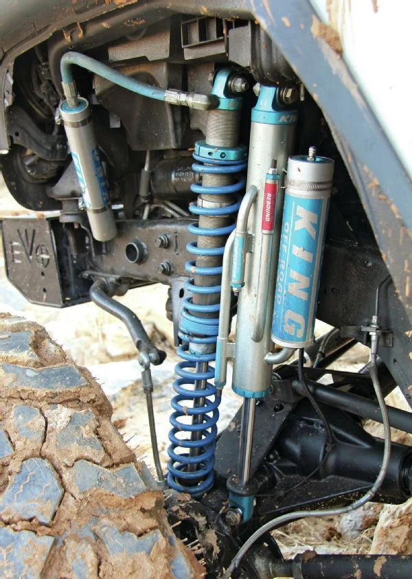

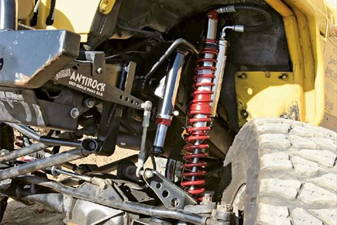

I think you would be ok. Just from looking at a picture or 20
2nd picture is a JK.
A 12" Fox 2.0 is 19.6" long compressed, 31.75" extended. That has to fit somewhere. How does a 12" travel coilover compare?
Axle width is a big consideration. Full bump might work, but I see the tires rubbing hard at flex. What about the rear? It is difficult to go beyond 12" of travel with the short driveshaft.
Yes, you're right. But with those coilovers, the way those things mount to the frame are a lot different than the way the stock shocks are mounted. They go up through the inner fender, almost to the point of touching the hood. I'm not sure if the stock fenders can still be utilized at that point, that's the big question.
