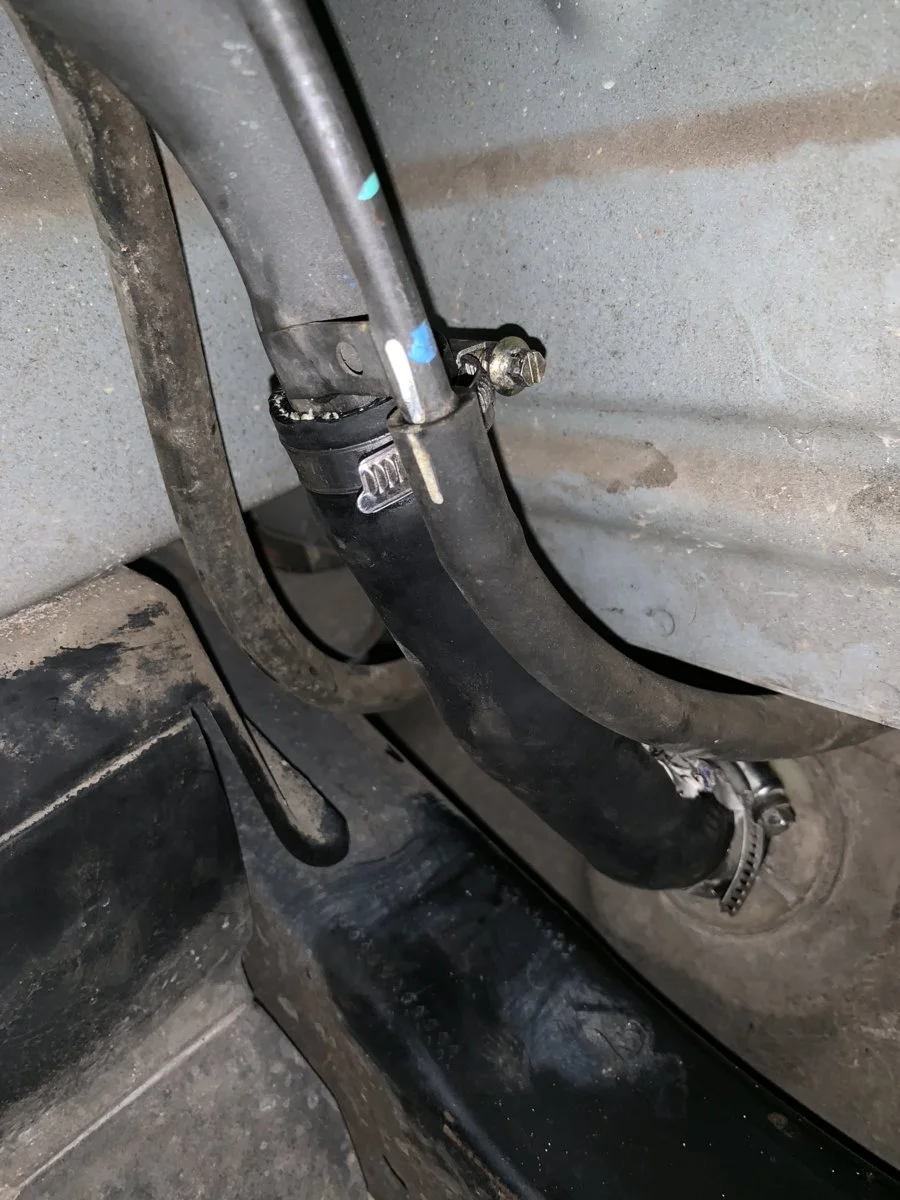

Added the GM hose this afternoon and then went and filled it up with gas... no more overflow issues. Awesome
View attachment 98449Thanks Chris and everyone else for all the information

Hey guys thanks for the ideas on this thread. I had to drop the tank for a bumper swap and did the GM part "band aid" fix while I had everything down. I didn't want to reach into the tank and pull parts out. I went to gas station and "let her rip" until click-of with no splash back. Great little mod in my opinion.
I would suggest maybe modifying the original post to note marking the GM clamp/hose orientation before discussing cutting off the ends. Just a suggestion.
