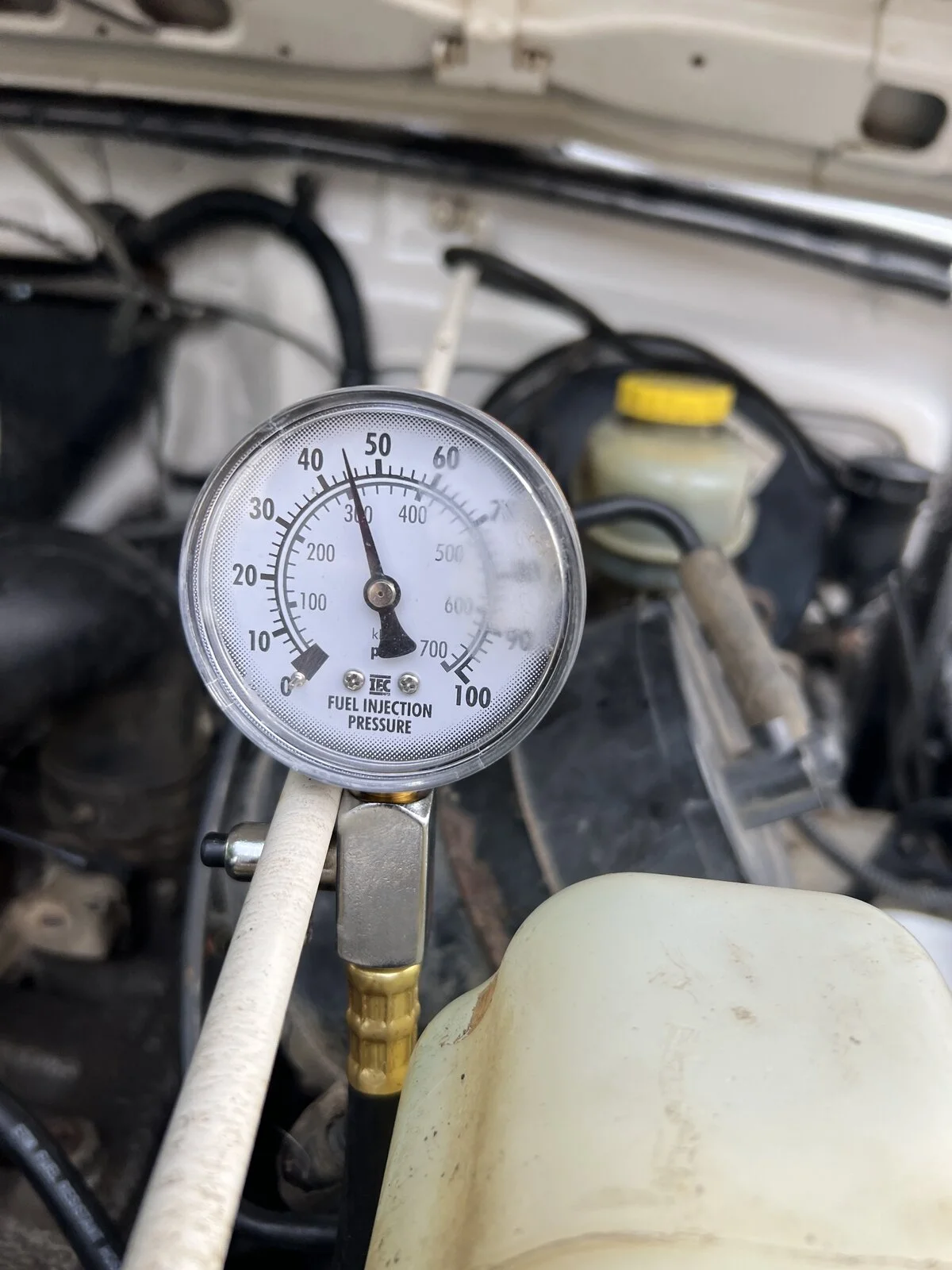

I’m running around 45psi steady and have an issue when I’m running under load. It sputters and runs rough. 5th gear is a complete no go until this issue gets resolved.
Any thoughts on where to start?
I’ve replaced both O2 sensors NGK. TPS is new. CPS is new. IAC is clean. No codes no lights.

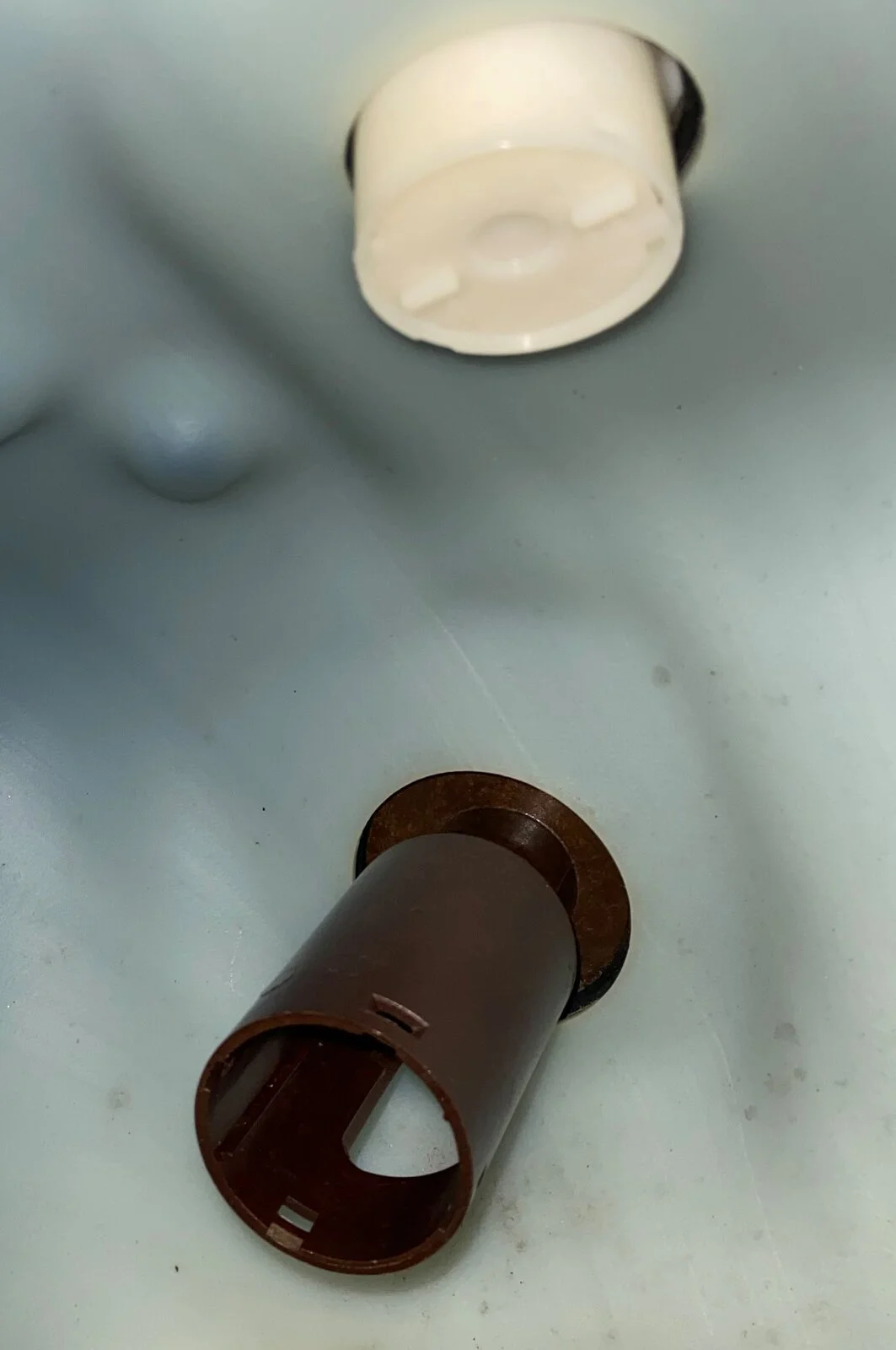

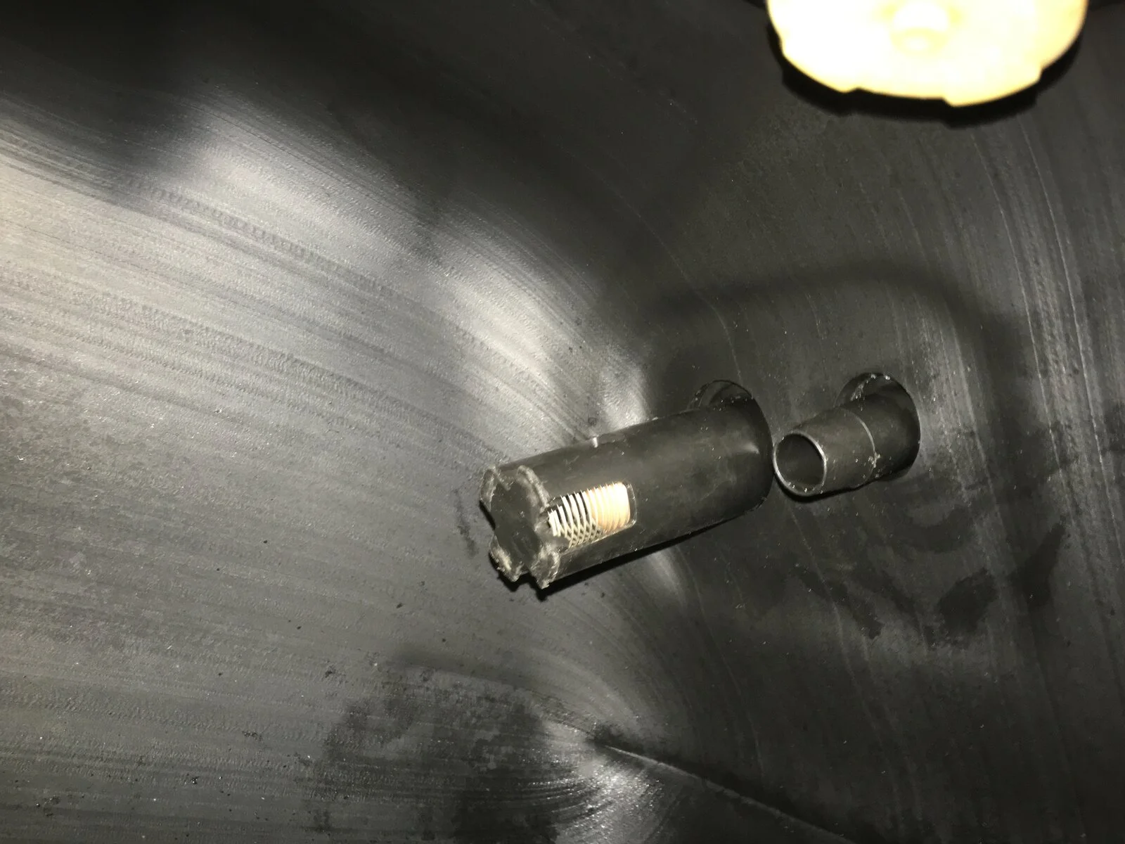

SSTJ, or any one else here - have you guys ever seen a plunger like the one in the photos I attached below? My '04 TJR has been having both the fuel overflow and slow fuel fill problems, ever since I installed a 2" OME lift in April. My mechanic had a tank from an '03 TJ in his shop so I pulled the plunger out and as you can see in the pics, it doesn't look like the plunger or ball set up that others have posted about in this thread. Any thoughts on if it'd be worth my sanding down the plastic guides which (in this case) are on the walls of the cylinder that extends into the tank, that the plunger rides up and down in? The part number on the (Mopar) tank indicates that it is from a '03 TJ.
Thanks in advance for any thoughts/suggestions, this problem has been a PITA for the past 5 months. Was very glad to find this long and detailed thread.
I’ve not seen one like that. Could the tank have been from something beside a TJ?
I have never seen one like that, but then again my only experience has been with my 97.

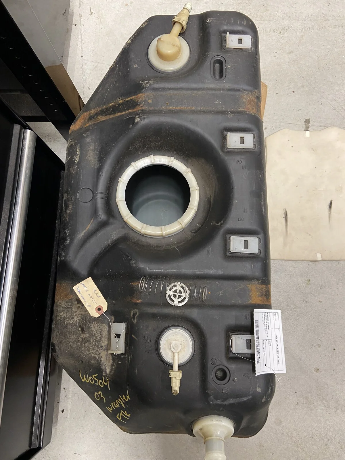

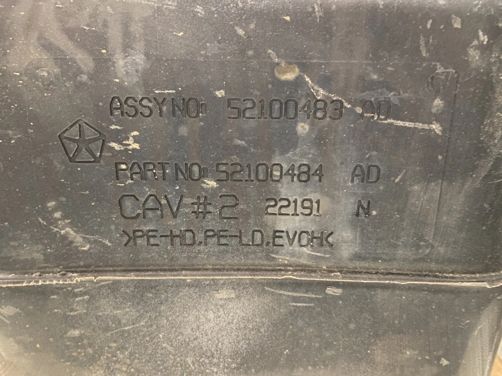

Thanks Fellas, yeah I was wondering the same thing myself. Here's a pic of the tank, and the part number on the side of it. I Googled the part number and it seems to line up with tanks for '03-'04 TJs.
I haven't dropped my own tank yet ('04) but I assume it has either the ball or plunger set up that most people have talked about on this thread so far.
The plunger set up on this tank in the photo seemed to have smooth sliding action, fwiw. I'm wondering if I should just install as-is and see what happens? Guess I can't make things any worse?
Also, not sure if it's related but I have been throwing EVAP error codes for small and large leaks over the same time frame as the fuel fill issues, starting after the lift install. I had my local shop smoke the EVAP system, replace the charcoal canister and solenoid - none of which solved the error codes or fuel fill issues. I am wondering if it's related to the plunger being stuck in the 'open' or 'half open' position?
Had a guy tell me that the way you know your TJ is running is if the check engine light is on. I'm starting to think he's right...

I thought the '03's/'04's had the metal ring to hold the fuel pumps in.

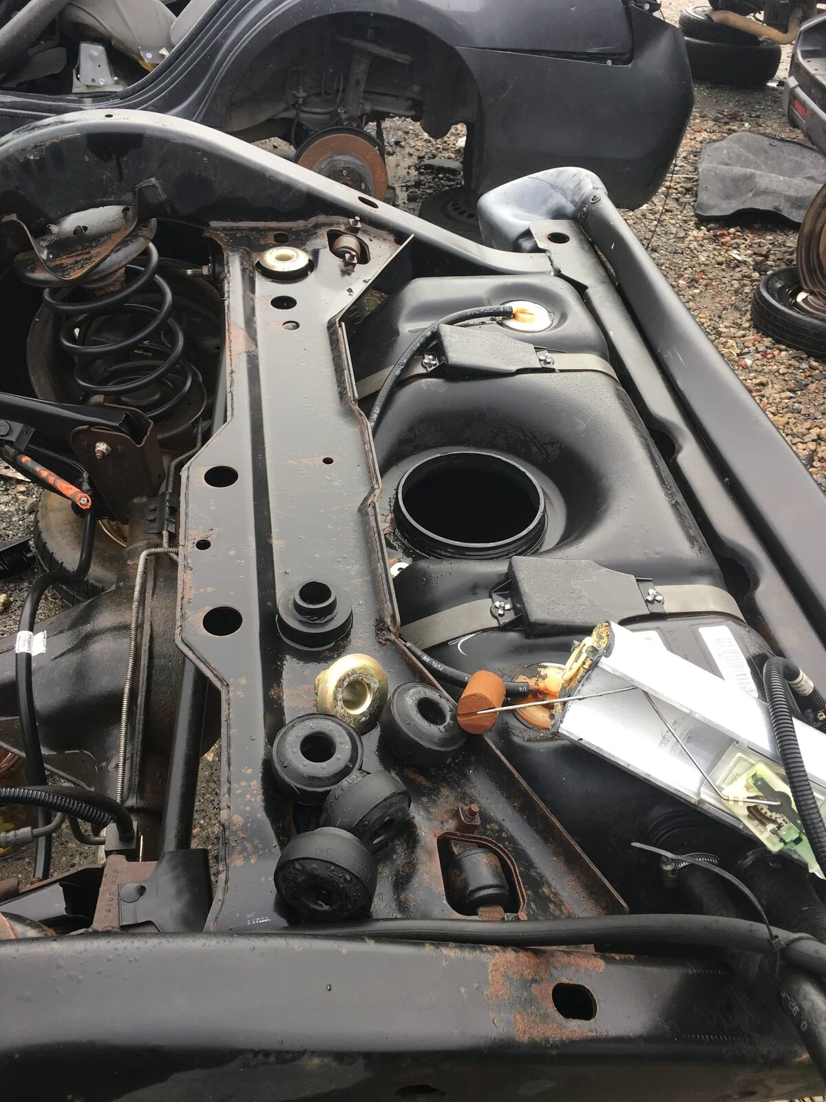

Thats interesting. The only two kinds I've seen are the later models that people file down and the early models that don't appear to be removable. I found this in a junk yard in Georgia and was going to pull the plunger until I found out it was the early model type.
Just did my 30k '06 last week. It has the steel ring.

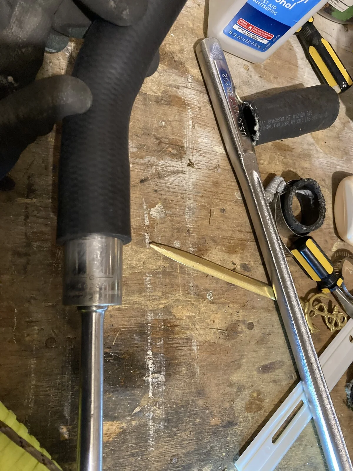

Irritated. I thought I could buy myself some time but no. Just did my first fill up after the "temporary fix" and it sprayed gas all over...as if I didn't go through the hassle (the thing was damn near glued on) to change out the filler hose at all. I am glad this resolved the issue for some. It did not provide value in my case.
Bottom Line. In case you have read through the thread this far and are still contemplating the filler hose change (thinking it might be solved with less time output)...my opinion is spend your time learning how to drop the tank

Ugh. Super irritated. I just did my first fill up after the "temporary fix" and it sprayed gas all over...as if I didn't go through the hassle (the thing was damn near glued on) to change out the filler hose at all. Sigh. I can't win with this machine.

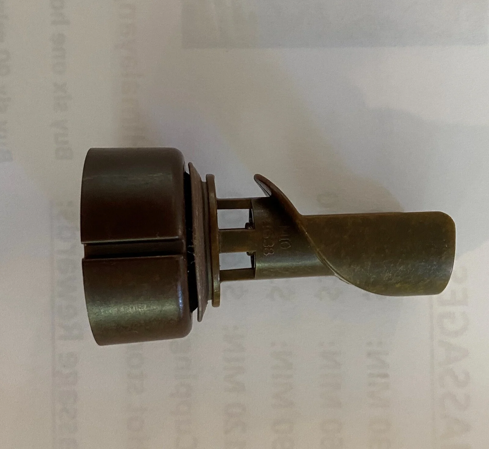

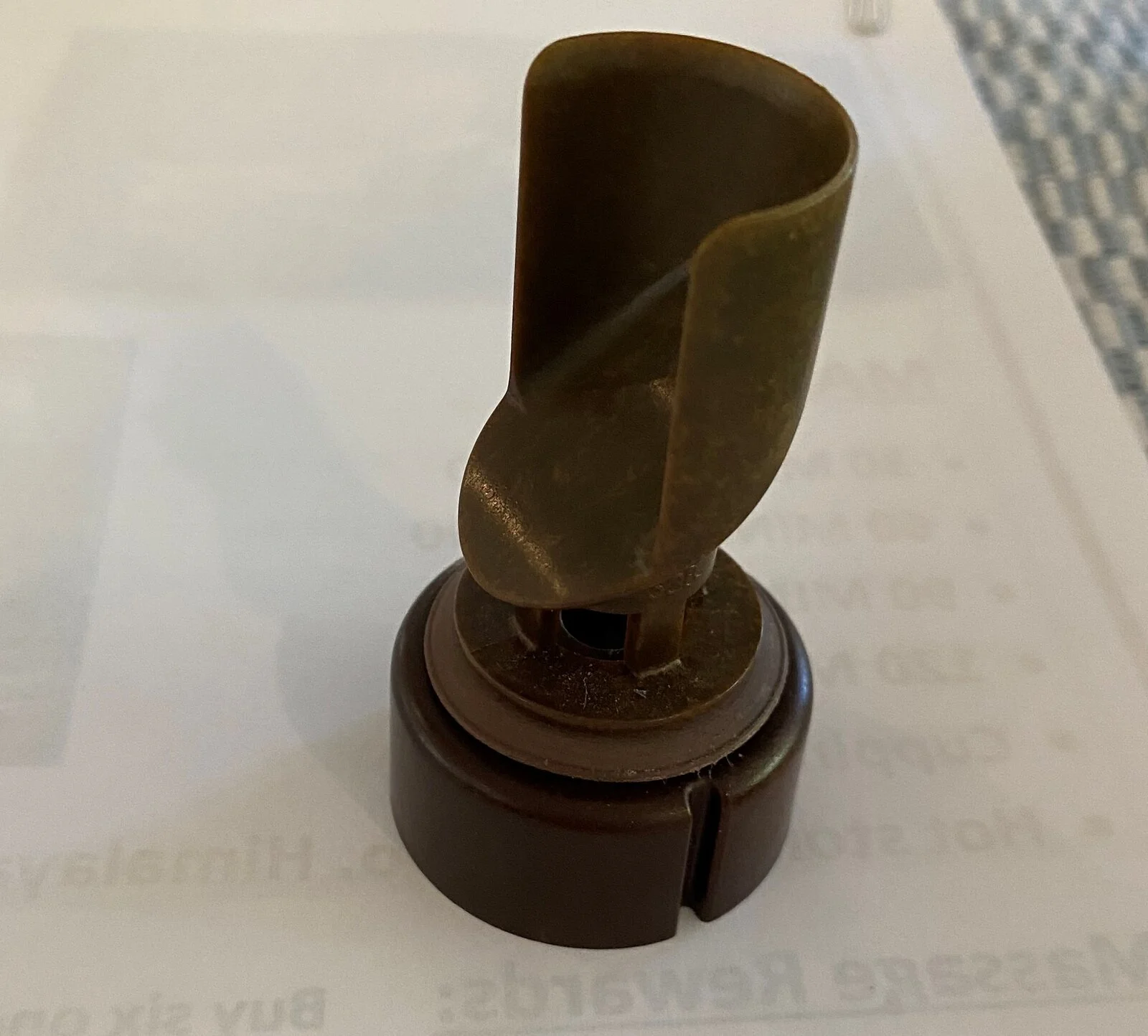

I cut the GM Hose and took the flipper thing and put it in my Jeep hose. Works much better now
