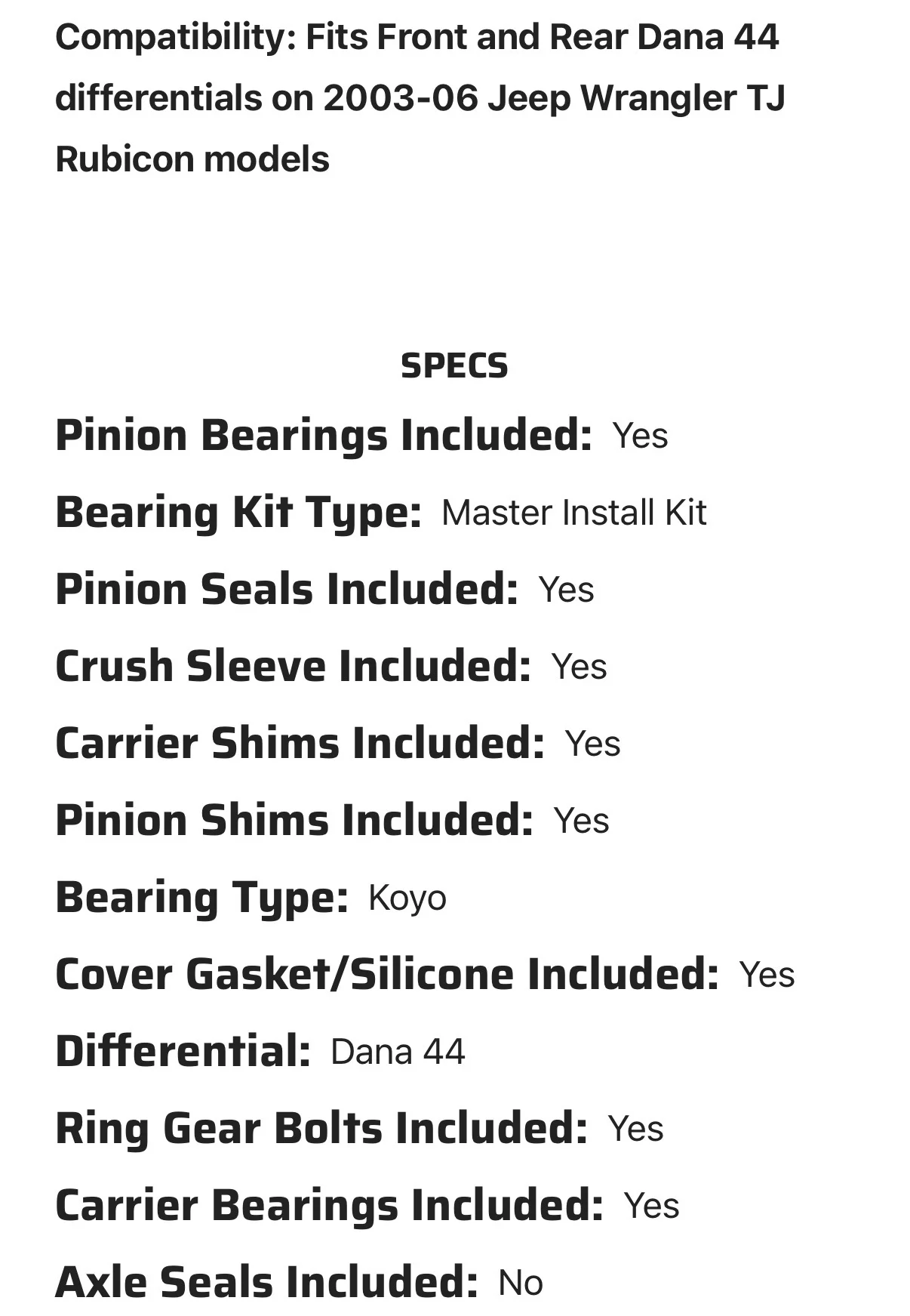

So Yukon master overhaul kits are quite expensive but look like a good assortment of shims over motive gear brand. What brand over haul kits do you all recommend ? Both kits seem to have timken bearings with is good. Same goes with gears what brand is a good quality brand or should I stick with dana spicer on gears? Pretty much no gears are made in the USA I am learning.
