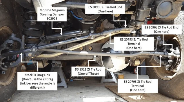

Can anyone confirm this pic is correct for ZJ upgrade on a TJ:
Sorry if this has been covered a thousand times, but haven't found a post that shows all part numbers and my searches have also shown conflicting info...
Yes, those would be the correct Moog part numbers and are the parts I used, minus the steering damper. I would recommend adding the TJ drag link part number as well (DS1430).

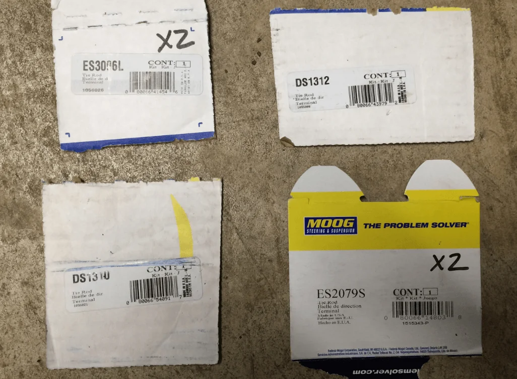

Here what I do use(on the attached picture). Pretty similar part numbers to the ones on your post. I do went with and OME steering damper i get on a barter deal but the Monroe is more than what the TJ's need. I do respect the opinion on the drag link angle but, I went with the ZJ drag link or passenger side tie rod end , no issues at all plus no contact with my Barnett diff cover.
Note:
I have done this mod on two TJ's plus my current LJ.

Yes, those would be the correct Moog part numbers and are the parts I used, minus the steering damper. I would recommend adding the TJ drag link part number as well (DS1312).

I have this note on my archives;
The DS1312 is the drag link or passenger side tie rod end Moog part number for the ZJ (Grand Cherokee).
DS1430 is the drag link or passenger side tie rod end Moog part number for Wrangler (TJ).
I does not wants to start anything here, just correct my info if that is the case. Can you please check your notes and let me know what I do have wrong?

Thanks, Chris That seems to go along with the picture with the exception of your list possibly being short (1) ES2079S in your list of parts required to change everything.
(2) ES3096L End
(2) ES2079S Sleeve
(1) DS1312 Tie Rod (ZJ?)
(1) DS1430 Drag Link (TJ)
Correct?
Reactions: red02tj
(2) ES3096L End
(2) ES2079S Sleeve
Correct?

Looking at the picture in the first post it looks like the zj drag link is angled differently.
Reactions: JMT
@ac_ is right, the ZJ drag link is angled slightly differently. Either will work, I THINK, and I’d say go with the cheaper one, as there is no advantage strength-wise of one over the other. But to be safe, go with the TJ drag link.
EDIT: I am correct. The ZJ and TJ drag link are angled slightly different. However, the only thing that changes is a slight angle on installation of the steering stabilizer. Everything else is the same. YOu can use the ZJ one and save some big bucks. If I recall, it was about half the price of the TJ one. I used the ZJ and saved. Also, you may not neeed a new drag link, just the tie rod ends, so that saves even more
