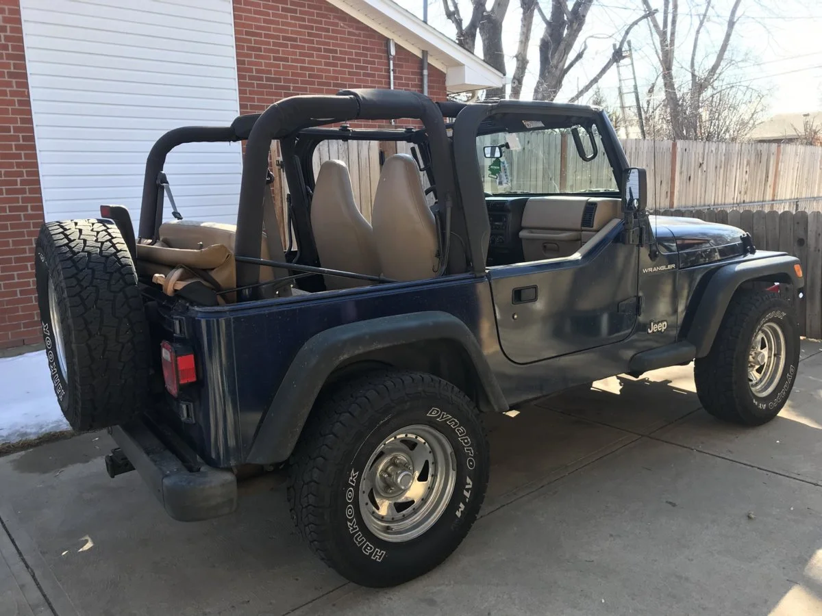

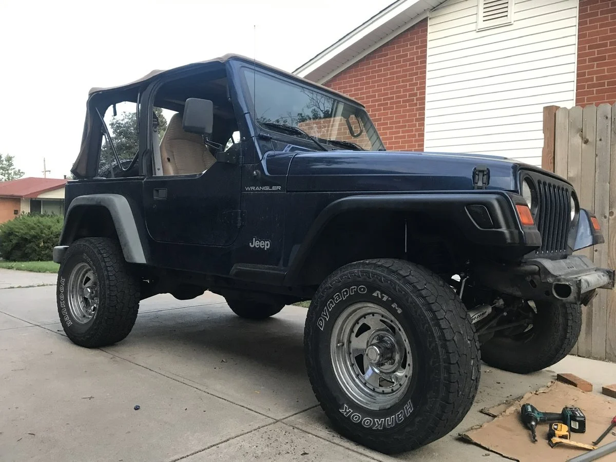

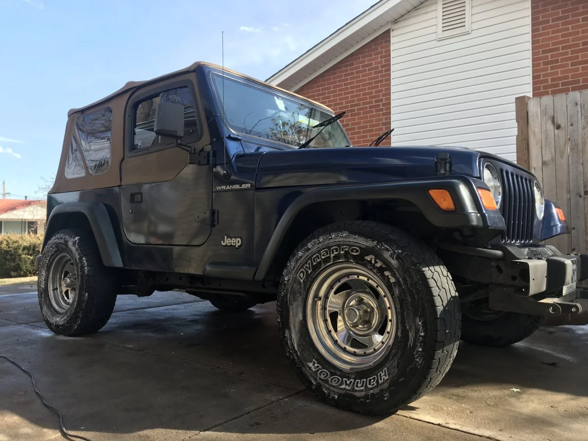

Hi everyone! this is my first post here and I posted this question on Reddit, but looks like this is a friendlier and more knowledgeable crowd. I have a few questions before I start working on installing the zone 3” lift kit on my TJ this weekend.
  1. This kit seems pretty complete, has anyone installed this kit and what parts I should get before I start taking everything apart?
  2. Any gotchas you experienced installing this kit or similar 3” lift kits?
  3. I'm also upgrading from 31x10.5r15 to 33x10.5r15, should I get the alignment done before or after the tires to 33”s?
  4. Should I bite the bullet and get new wheels while I'm at it and upgrade the 33x10.5 to 33x12.5?

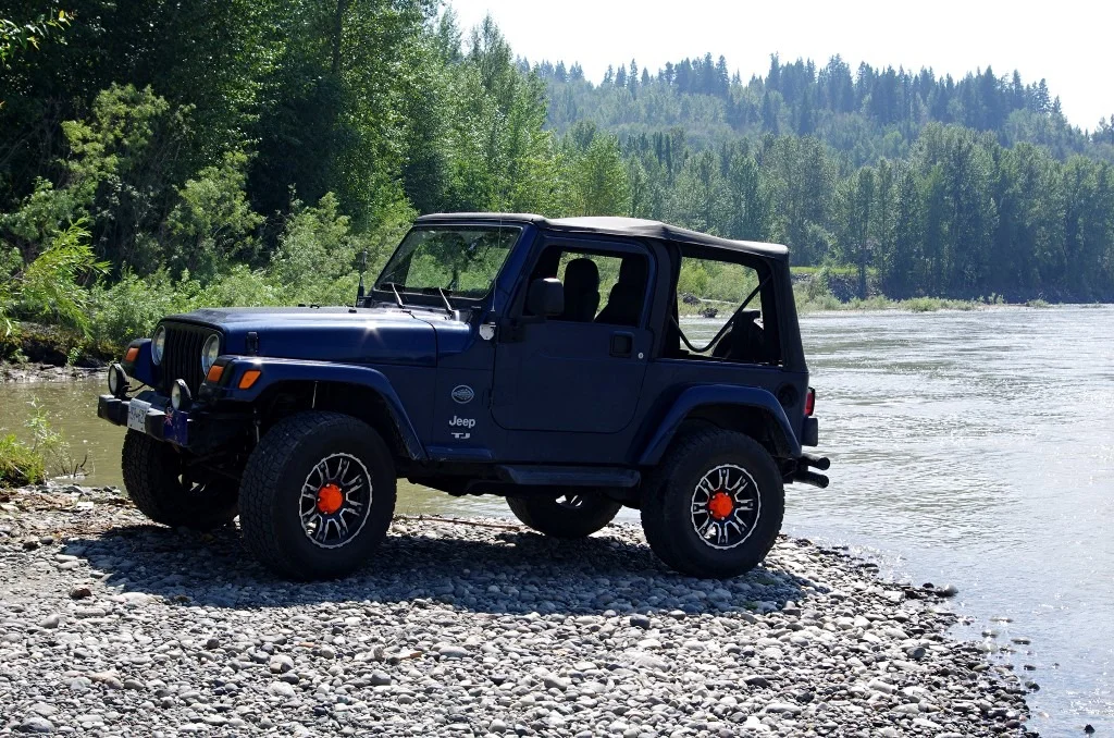

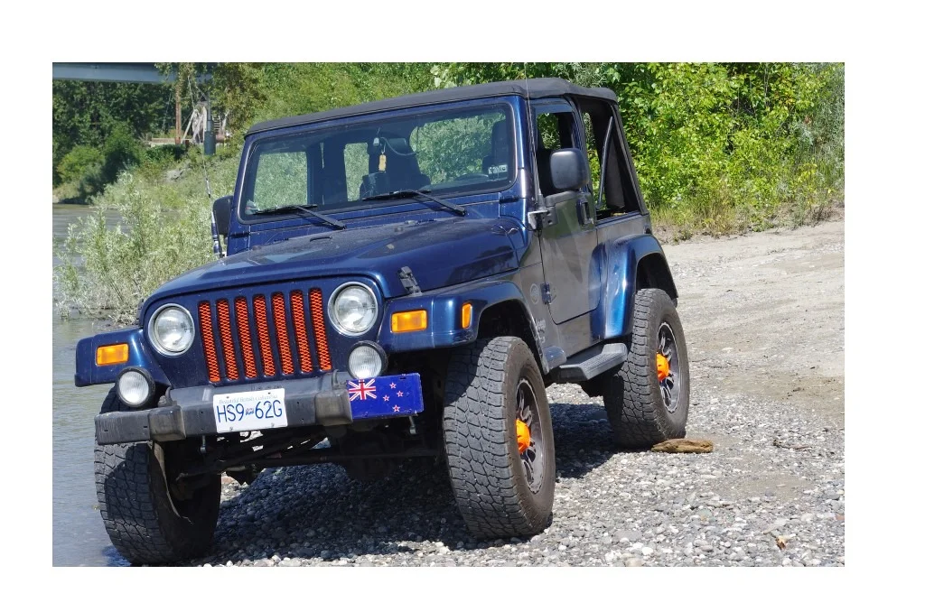

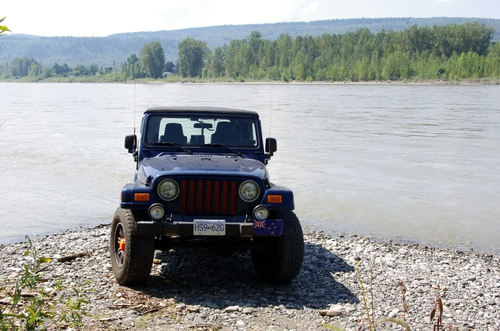

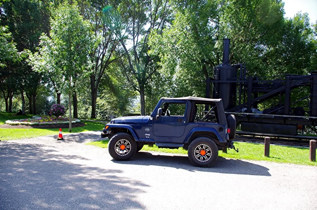

Hey Miguel, finally got a few min to go grab a few photos...
This is exactly the same as you were thinking.
Zone 3" suspension lift
JKS adjustable track bar
Zone caster adjust kit ( 2 degrees)
1" wide 5-4.5" to 5-5.5" spacer adapter
17" Black Iron (Kal Tire) aluminium wheels
285/70/17R Nitto Terrain Grabber 33" LT 10 ply tyres (off my dodge ram)
