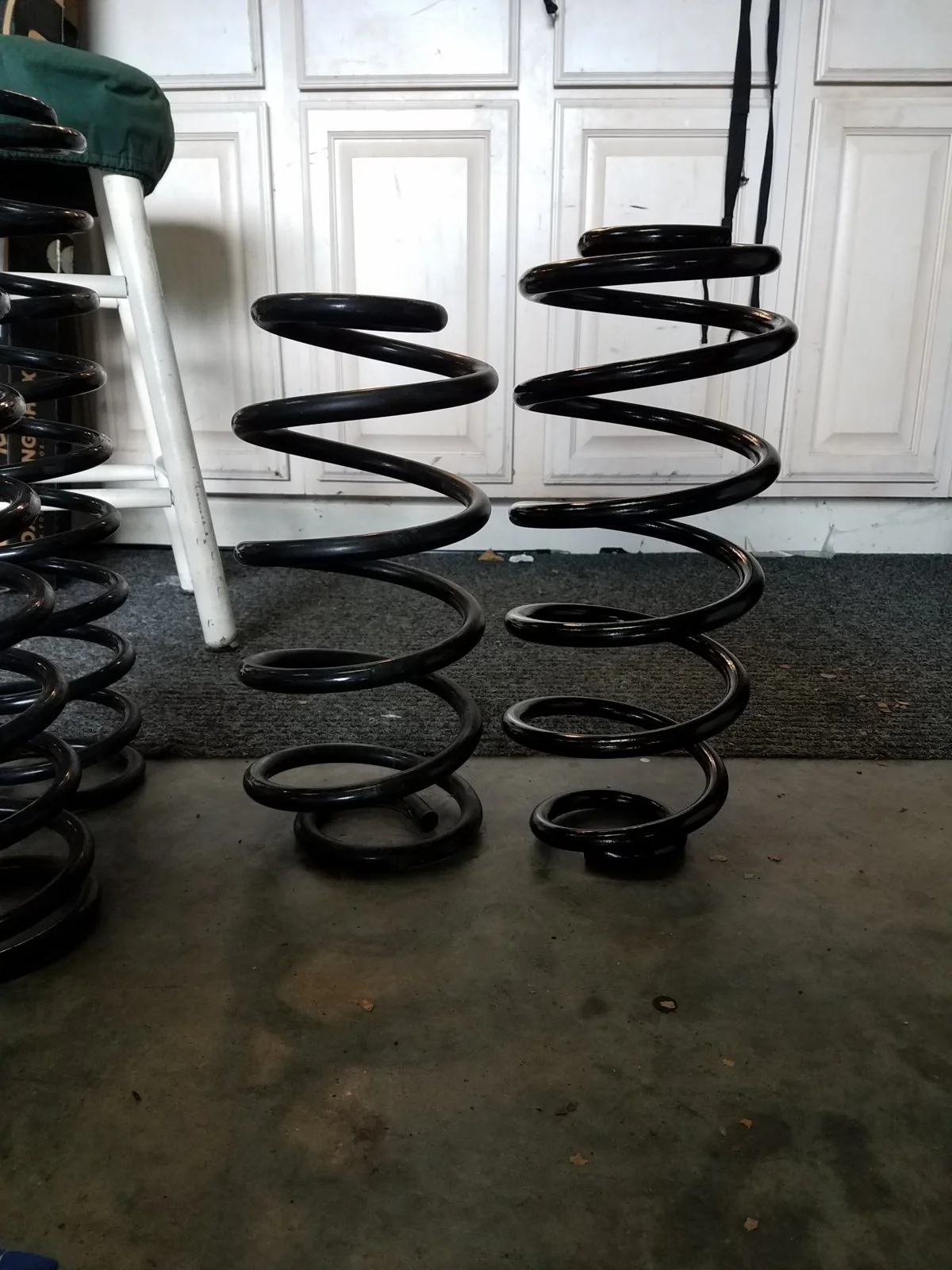

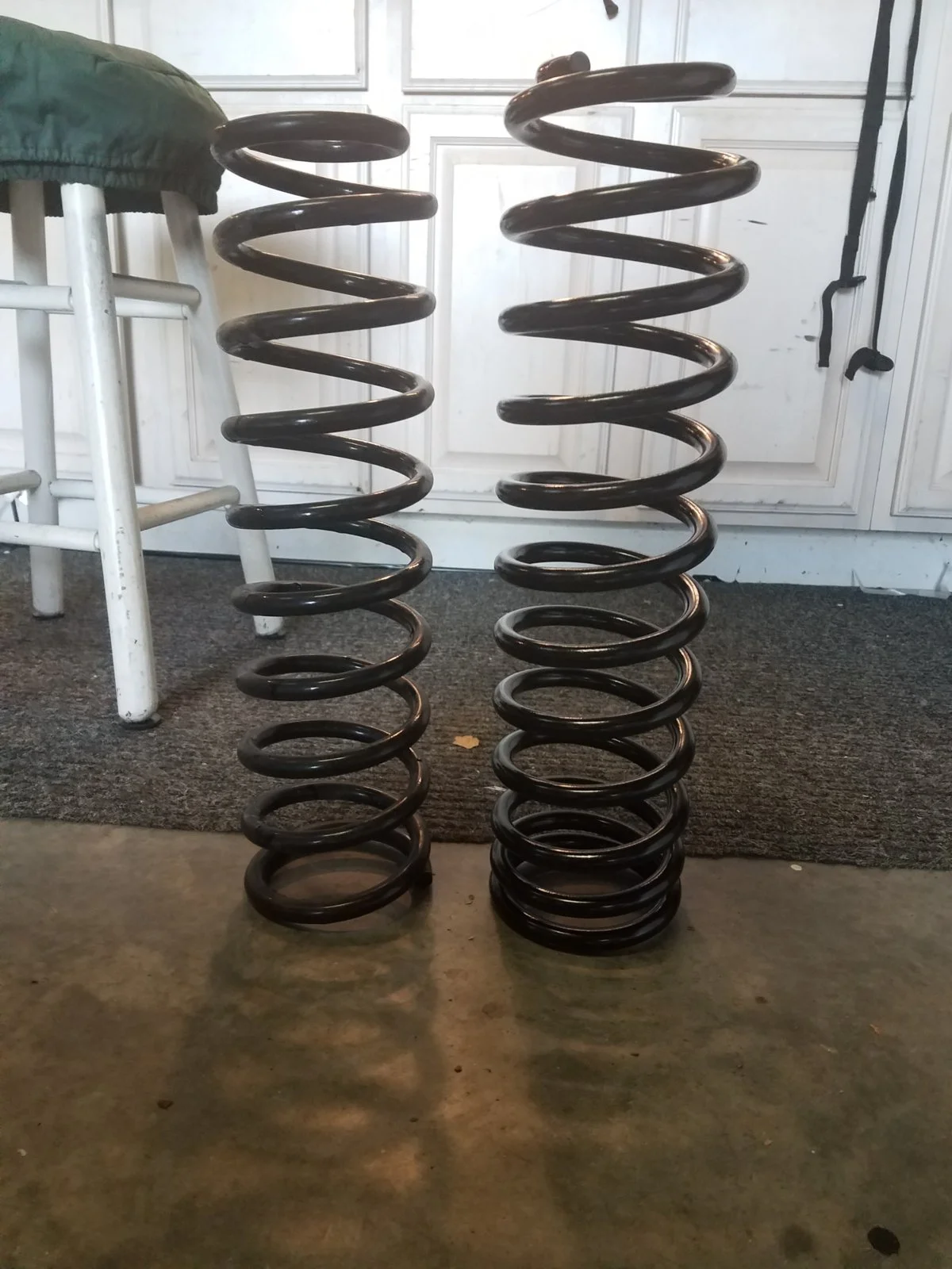

Pictured below are the differences between a 18 month old ZONE life 3" spring, and a Currie 3" spring. Notice how the Zone springs have settled and arched
This is tremendously helpful. I've never used the Zone kit, but along with OME, it's my other recommendation for people who don't want to break the bank with something like Currie.
So basically what I take from this is it's similar to a Rough Country lift, in that it will do just fine for the lifted look, but if you wheel the piss out of it, it won't last long.
Of course I have to assume it rides better than Rough Country on-road (anything has to).
This pretty much sums up why a kit like Currie is so expensive. People gawk at the price, but if you see the Currie components in person (I have a Currie kit on my TJ) it's instantly obvious why it costs so much. Everything is exceptionally well built, and the Johnny Joints are second to none.
