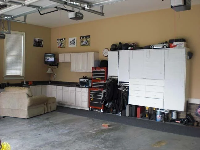

I have all my numbers SOMEWHERE in the garage, but had a failure in one of my wall units
Sending ALL my junk into the floor.....:rolleyes: I'm in the middle of rebuilding now. If I find them I'll post them, but before I put in the new springs and shocks I cycled everything with and without the bumpstops and wrote everything down for future reference (now I can't find that notebook)
