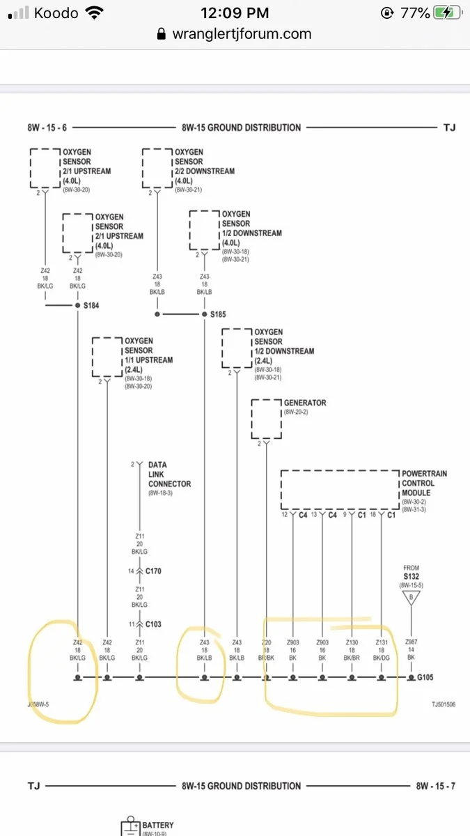

G105 ground location?
Yes 😂 Here is post 81 - you can see the post number across from the time
Oh. Ya. That’s g105 darling. Have cleaned it and sprayed it and sanded it and reinstalled yesterday.
z131/18 BKLG ETC ETC ....are all those points grounded to G105??
Physically? No. Electrically yes. That’s why we’re checking the easy things first. Once we are satisfied with our connections we can move into meter using territory to check for continuity, short to power or ground.
Yep! Any chance the connection between them and the ground you cleaned is broken? I’ve had wires break in the sheathing with no outside signs.
I see those 4 wires crimped are probably all associated with the pcm yes. And then z43 or z42 is the other negative gauge connected with it at g105. That other ground though I wonder where it is. It must be behind the engine block
So you’re satisfied that g105 is clean & tight. You’ve cleaned all the o2 sensor connectors. Cleaned all the PCM connectors? If so, clear the codes and see if they come back.

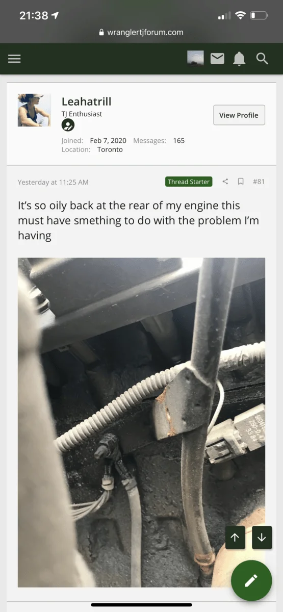

I’ve been asking around about the ground that’s connected to the back of your engine block? It goes from around your cowl drain to the back of your block ....I’m wondering if this ground is associated with the 02 circuits ....it’s some oily though at the back of my block —- horrible. I need to clean this area and any wires

I haven’t cleaned the connectors no. One of them closest to the back of the block what is it —bank 2 sensor 2? Full of oil inside the connector when I replaced it? Should I unplug all of them and spray and crap load of electrical cleaner in there?
