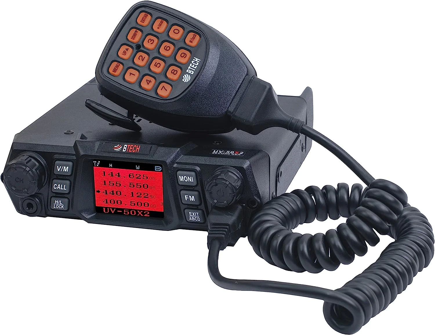

This radio will transmit GMRS frequencies out of the box. I mounted one in my Sprinter because I didn't want multiple radios. Works fine.
BTECH UV-50X2

I am using a Nagoya NMO-72 19.25" Antenna NMO Mount Dual Band VHF, UHF (145/440Mhz) antenna with my B-Tech UV-50X2 2m/70cm/GMRS radio that I use in my Sprinter van. It works just fine for 2m and 70cm, also the GMRS frequencies. The match for the GMRS frequencies isn't perfect, but more than acceptable.
