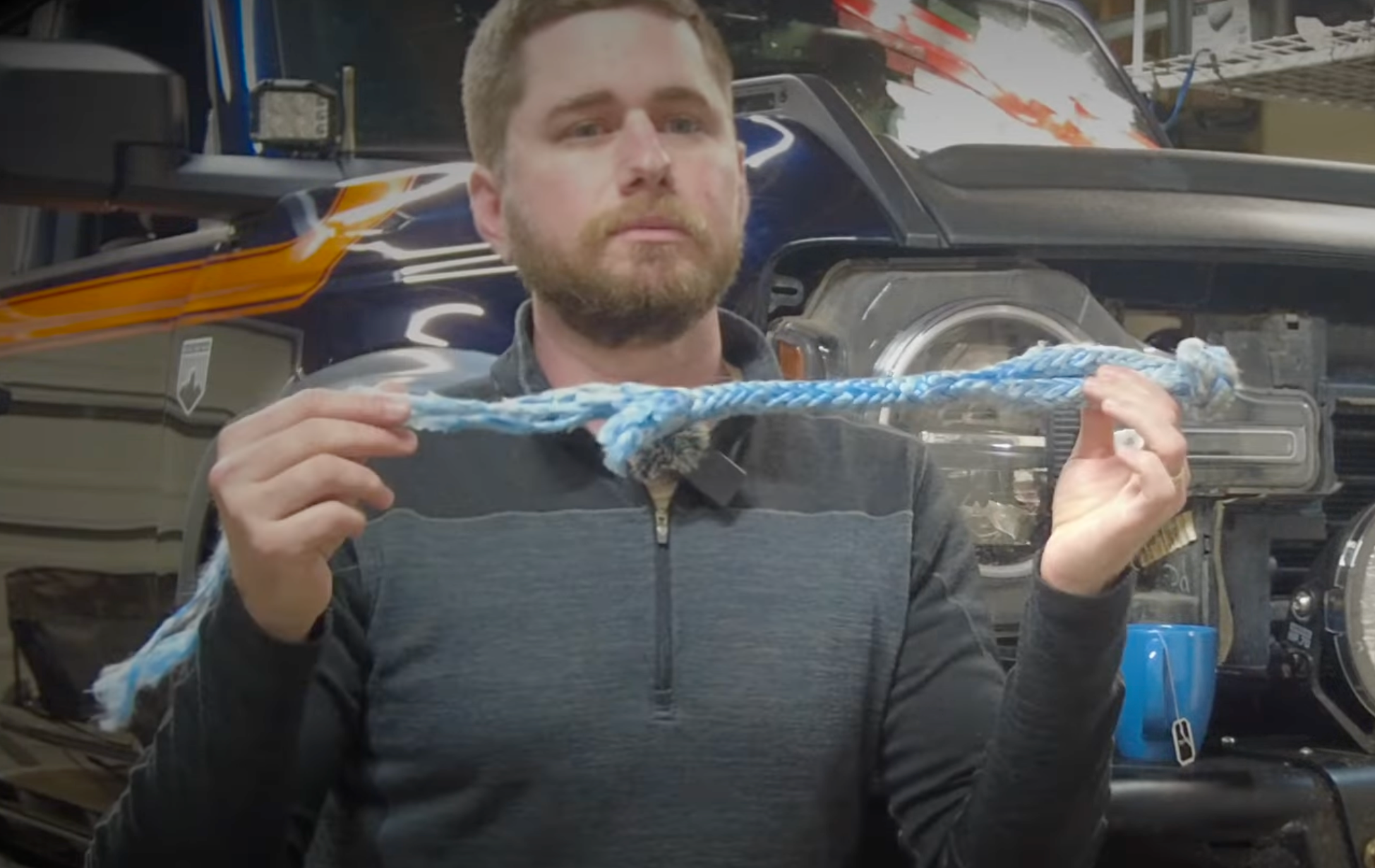

Failure @ 12:00 mark in the video:

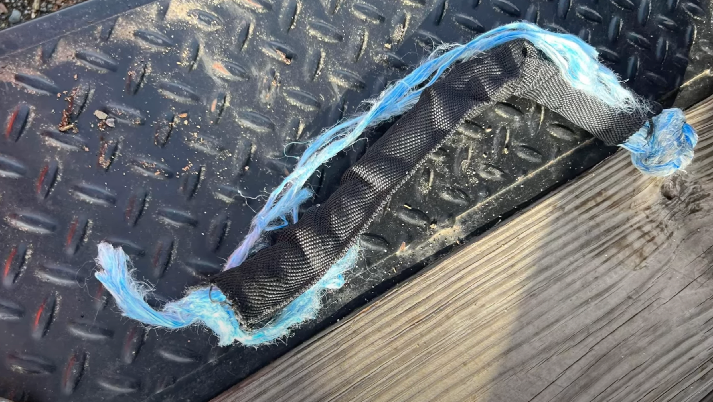

One problem with those sheaths is you can't see any damage underneath.
What caused the soft shackle failure? Was the soft shackle itself an inappropriate choice for vehicle recoveries, as in having too small of a diameter, or was it damaged before and waiting to snap?

He did not use a bow ring shackle on the Jeep bumper. He looped the soft shackle directly through the ring mount point, which has sharp edges. My opinion is that this was not merely equipment failure, but poor hookup technique. I think they cut through the soft shackle, not that it simply broke.

I haven’t watched it but the picture looks like it was against something sharp and not ideal.

Root cause is they used the wrong tools for the job in the wrong way and the Bronco owner never mentions any of that in the video. Having a broken this, a bent that, and an Amazon other is all just distracting noise because the pull was so hard and so violent that it bent the Bronco's frame horns and the Bronco never even moved. IMO they should have started with a shovel to reduce resistance. Then if they wanted to try a kinetic rope use a properly sized 7/8" (3/4" ?) rope instead of the 1" and use a bow shackle on the Jeep's sharp recovery point. Unless it was properly radiused it wasn't designed for soft shackles. Then pull a time or two with a lot less momentum. If that didn't work then its back to the shovel before another try or go to the winch.
