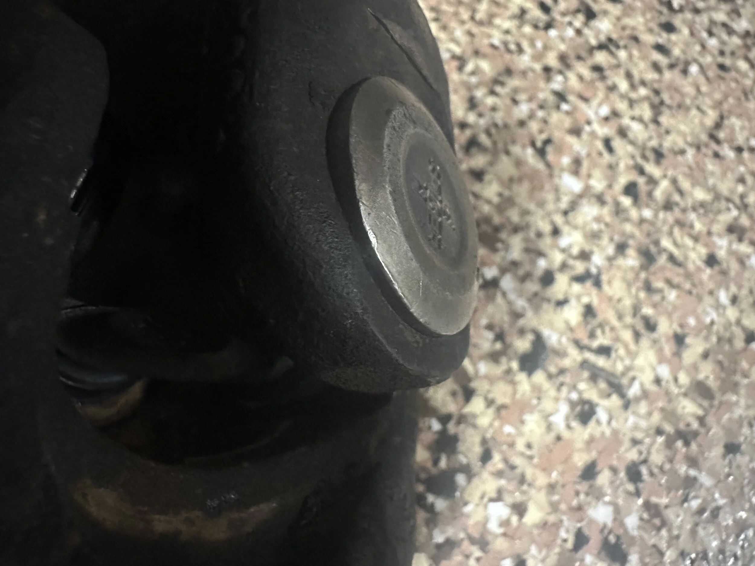

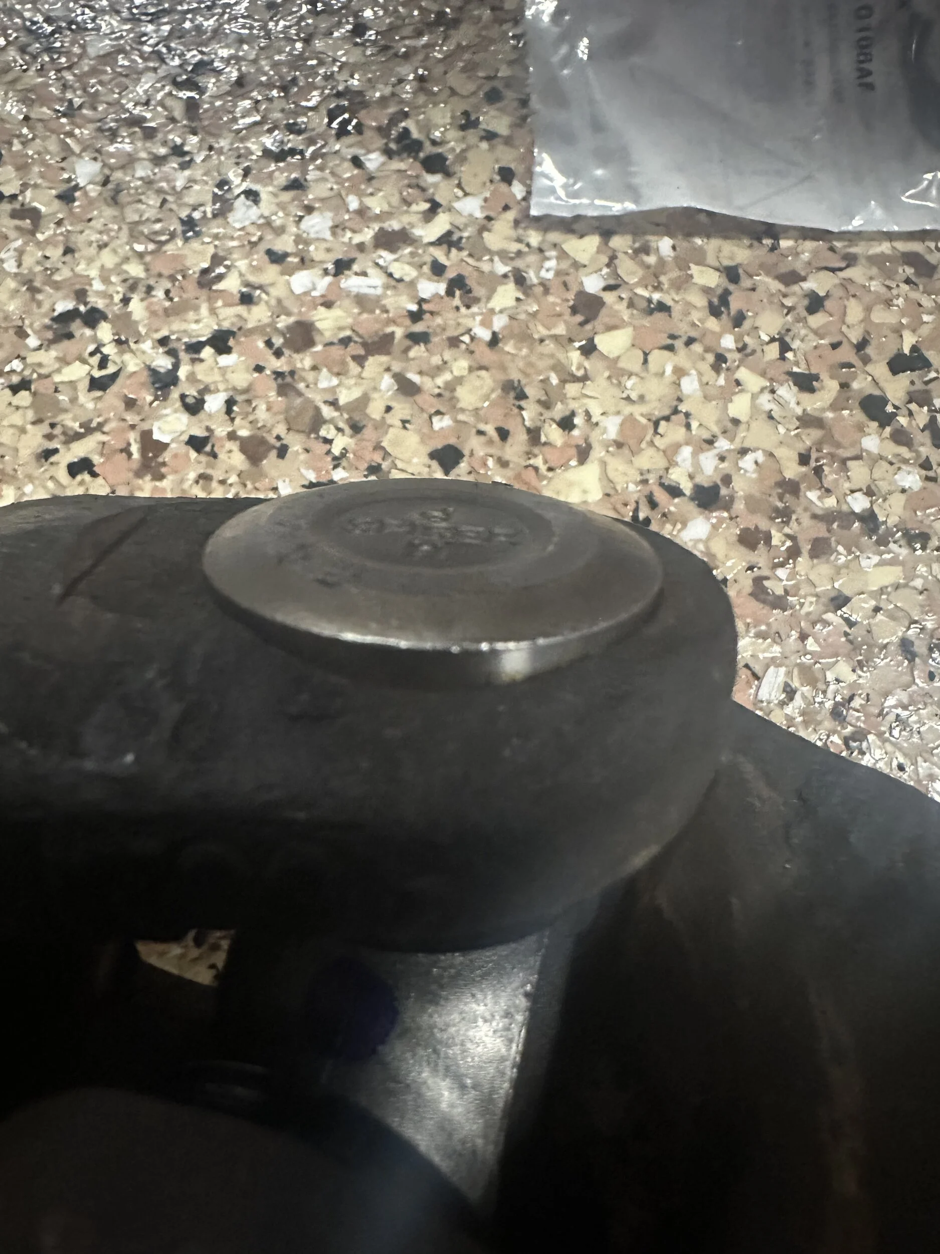

Make sure a needle bearing didn't dislodge and fall to the bottom of the cup. That keeps the cup from seating fully against the cross
That’s exactly what I was thinking happened so I took the joint out and the needles are everywhere. Going to see if I can’t exchange it, if not I’ll buy a new one.
I also found out that I require knurled ball joints. Have to return the spicer ones and get knurled now. Nothing is ever easy. Time for whiskey 🥃
Dimple the spicer balljoints with a pointed punch all over to make up the space.
