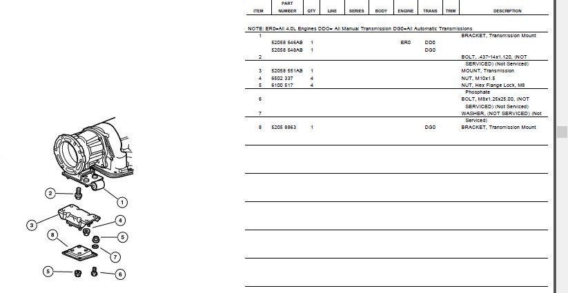

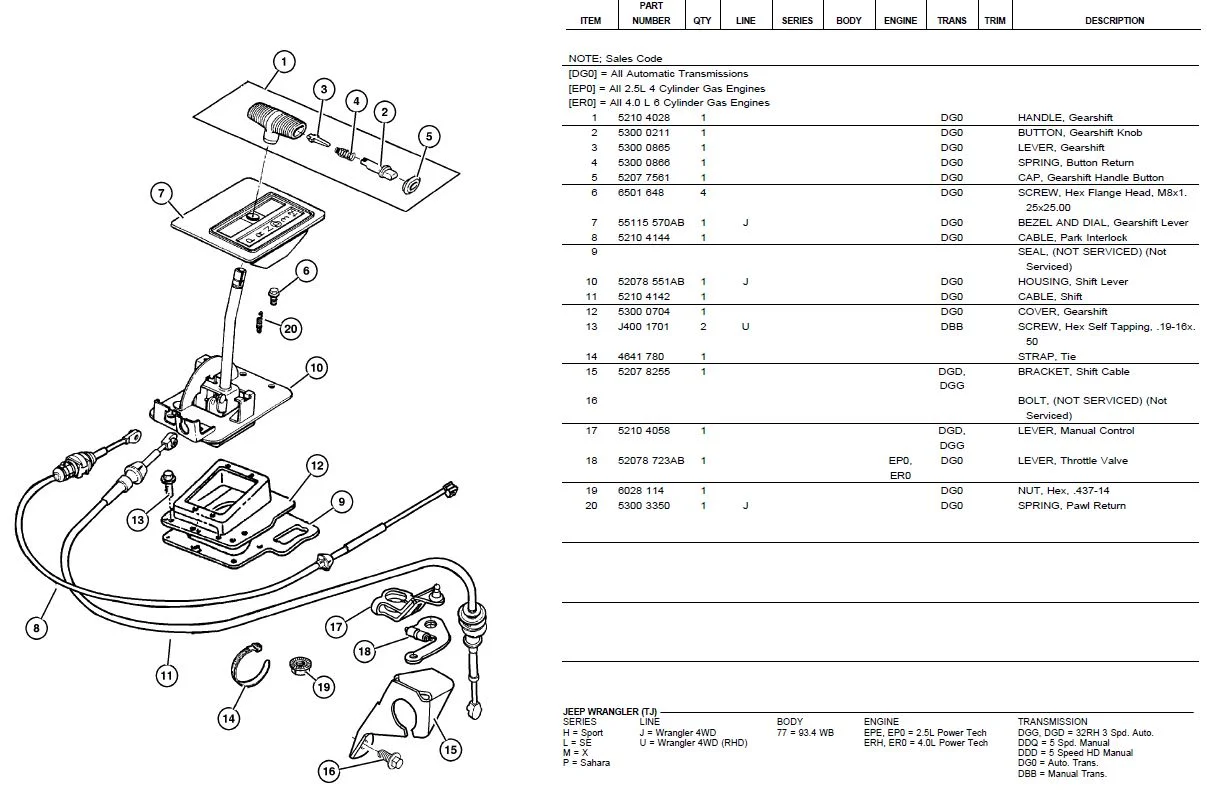

I definitely appreciate the info! Would there be any way to get pics of moat of what you are talking about. I only have a transmission with nothing on it. So I'm not sure what brackets are used to even to the linkages on the side of the transmission.
This should help. Item #1 is the part that supports the exhaust system above the transmission.

This shows pretty much everything else. This also reminds me I did not bother installing the 'Cable, Park Interlock'. It's not really needed.
