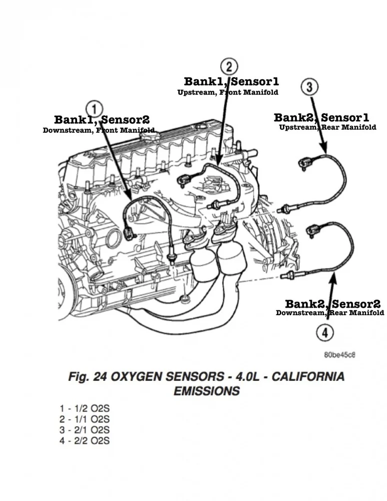

What are Bank 1, Bank 2, etc.?
Since this question pops up from time-to-time, here's an easy to follow diagram that illustrates what they mean when your OBDII code scanner (or manual) tells you something like "O2 sensor, Bank 1, Sensor 2":
