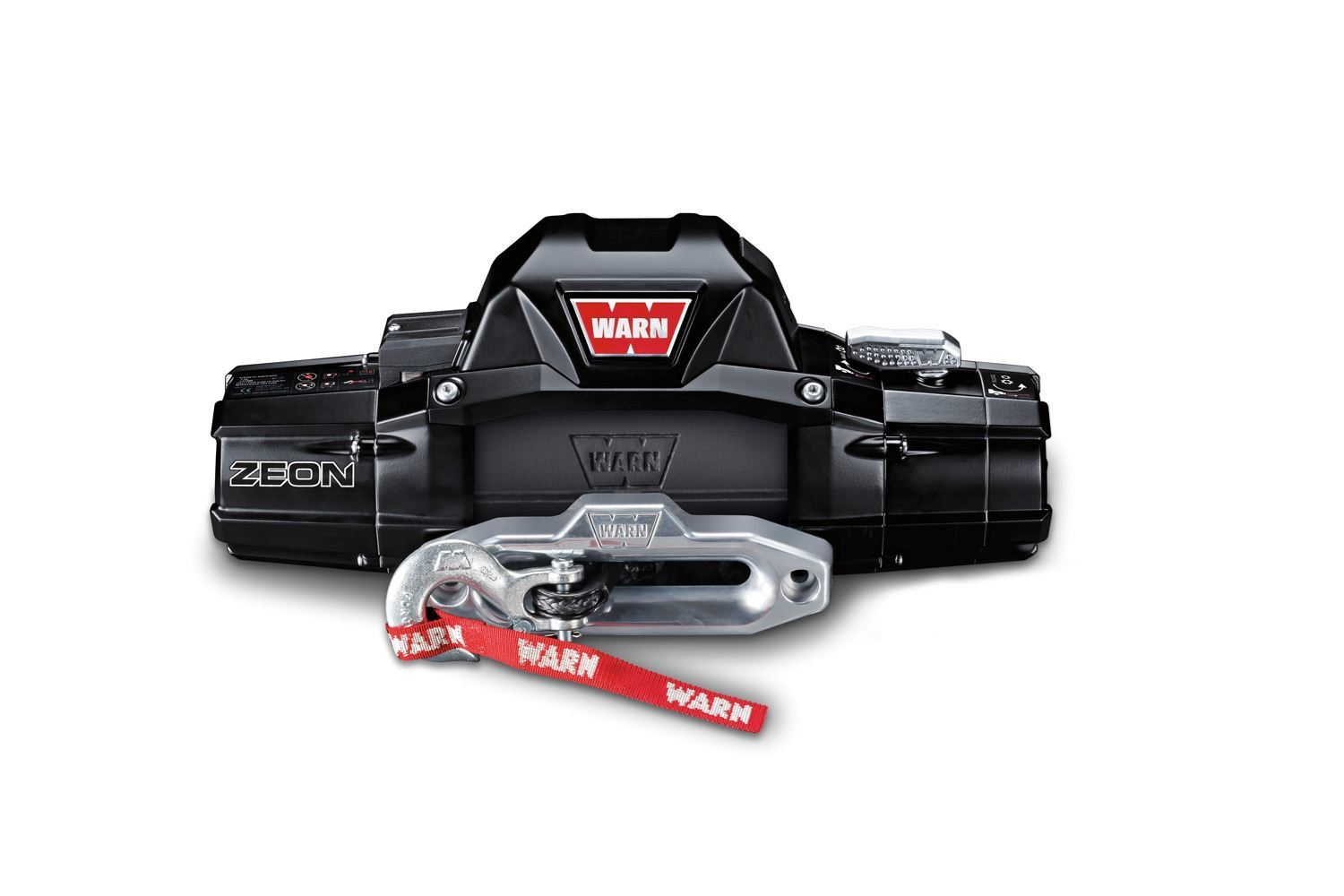

I do wish they offered a rope cover like the one for the Zeon, on some of the less expensive winches. I'm not a fan of bulky winch covers but it seems like keeping all the grit from the road out of the rope wouldn't be a bad thing.
And why do I not have this cover on my Zeon 😯

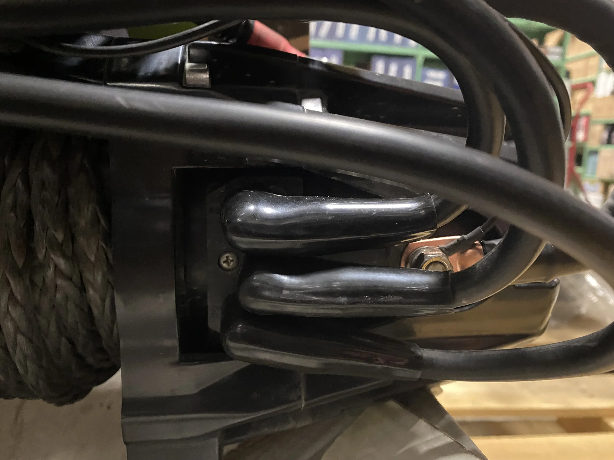

Have the vr evo 10s on my jeep for almost exactly 2 years now. The remote got recalled so now I only have a wired remote which isn’t the end of the world but it was nice to have. This past week I went to just tighten the line on it and it’s not working as of now. I’ll get a click on both in and out settings then after a few clicks nothing. Called warn and they send me a a random home made video off YouTube to test the contactors and then come back to him to further diagnose the issue. A little upset that 2 years in with not a lot of use and when I did use it I was always trying my best to not over use it or burn the motor but having the remote and now the whole winch go down and then just get told figure it out upset me. If I didn’t have this issue this past week I would have recommended it as it did work in -15 degrees in snow or summer when I did need it to get unstuck.

Covers have a bad habit of trapping moisture. I would inspect all the connections on the back of the motor.
