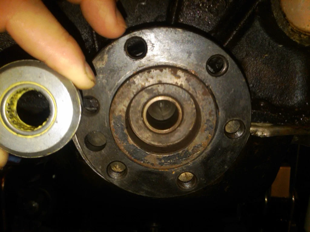

It's pretty straight forward. Just look at the pic above and compare to what you get from the shop. If it's not there, tap over in and bolt up your flywheel.

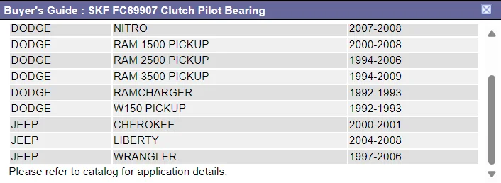

Would it be the same pilot bushing any 4.0 manual would use, or something custom to make a 4.0 automatic motor work in a manual jeep.
(I'm doing this in an '88 Comanche that is already manual, but the replacement engine is from an automatic)
Thanks
It should be the same, but don't forget about the large bushing that holds the pilot bearing too.
I've never seen a difference in any of them that work in the TJ 4.0 crank. Which ones are different because I'm missing something?
Older ax15s use a different size pilot bearing.i don't know much about the peugot transmissions except to avoid them.It is an 88 commanche,not a tj.
As a side note the 258/4.2l has a different size recess in the back of the crank so the spacer must come from an amc v8 to adapt to a newer ax15 if i remember right. I should have been much better about recording part numbers with my stroker
