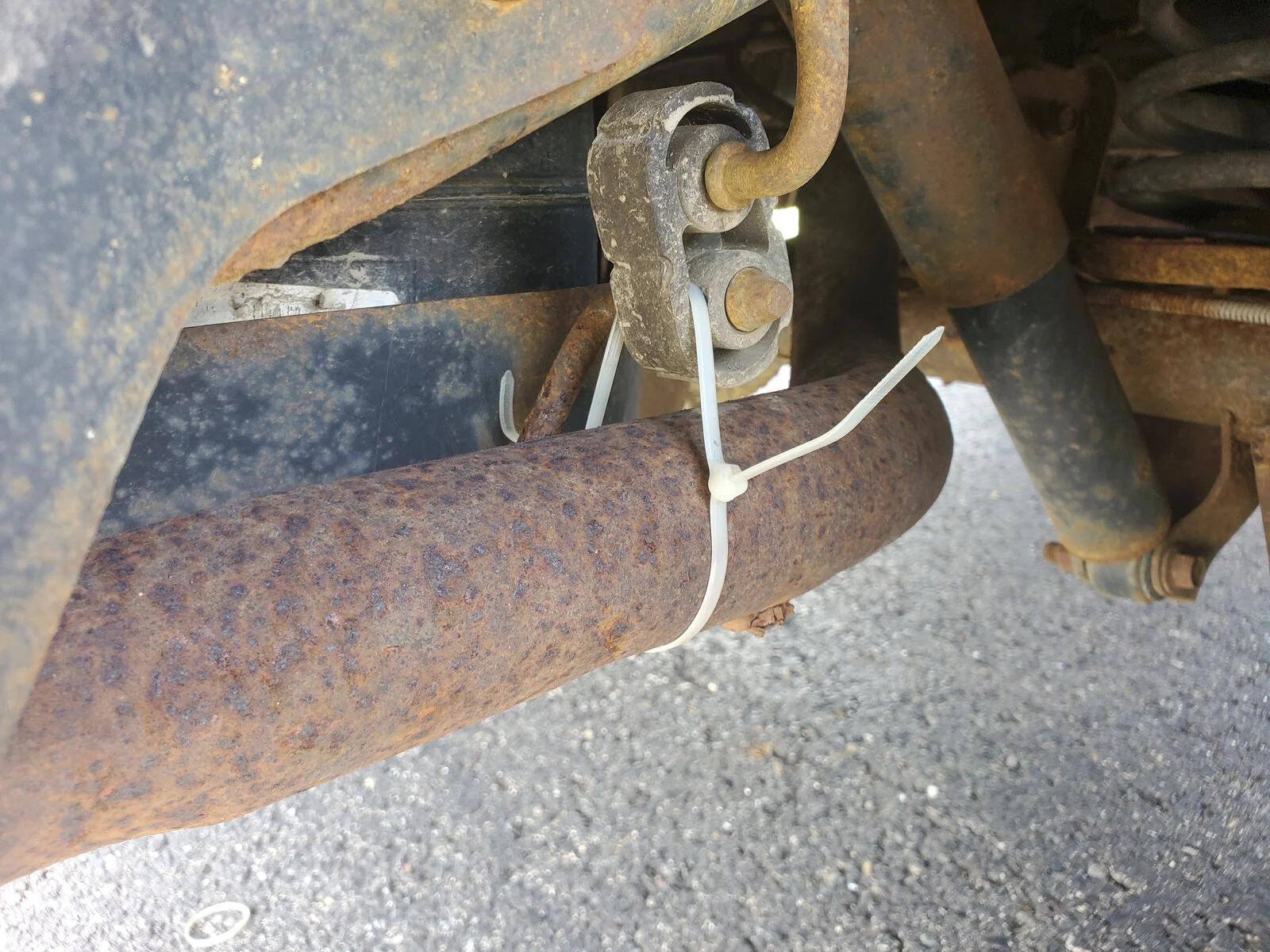

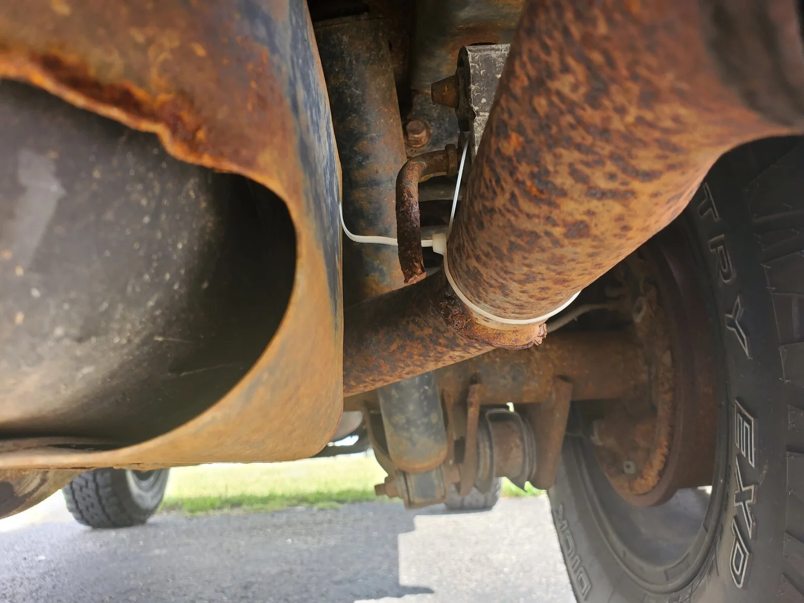

Turned out to be the exhaust. Rear bracket weld broke and the exhaust body was bouncing around on the skid plate. Welded the new bracket in today and sound/vibration is gone. Thanks everyone for the responses! Rust is a bitch lmao

It turned out to be the exhaust rear mounting brackets. I responded to the original post with more detail. Thank you very much for the suggestions!

U-joints looked great! Much better than I expected. I pumped new grease in just to be safe. It turned out to be the exhaust rear mounting bracket. I responded to the original post with more detail. I have updated my profile too, I am new to the site and didn't think to look at my profile before making a post. If you do happen to take another look, let me know if you think there is any info I should add to better assist. Thank you very much for the suggestions and respose!

This is exactly what it was! I responded to the original post with more detail. I gotta admit I was pretty skeptical about that being an issue but you shoulda seen my face when the whole thing started bouncing around lmao Thank you very much for the suggestion!
