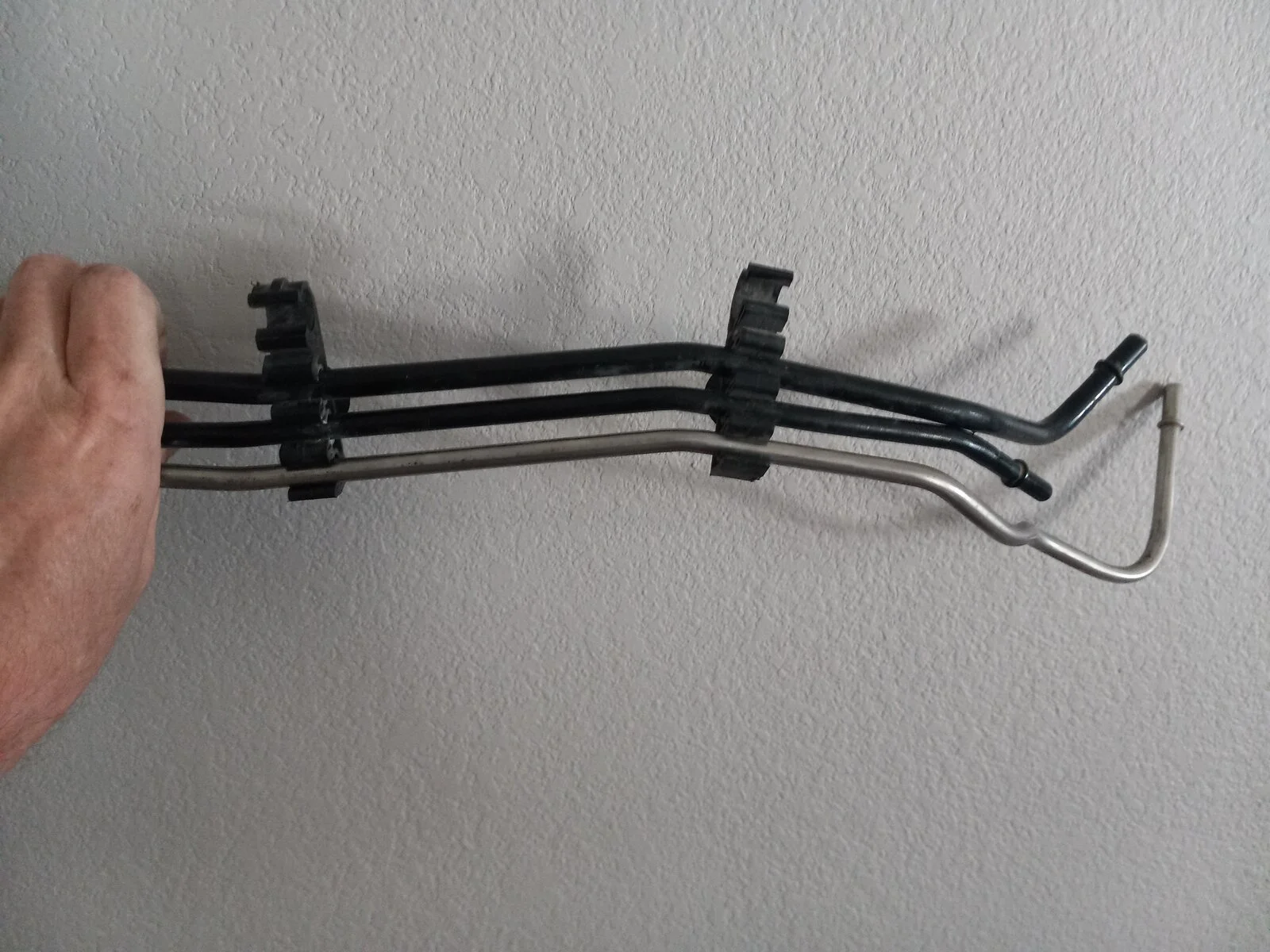

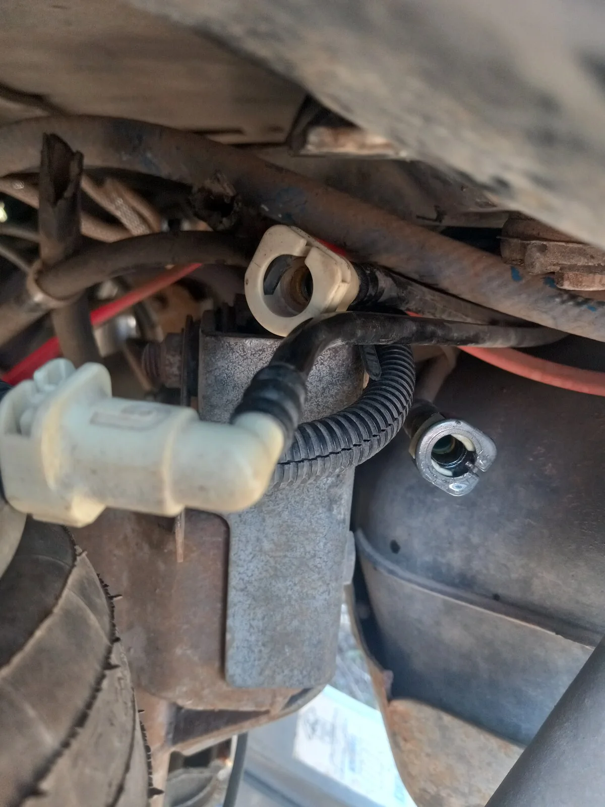

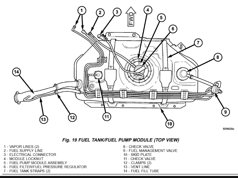

I need help with the 2 vapor lines on frame and the fuel line on the frame. I have a 3/8 vapor line and a 5/16 vapor line with a 5/16 fuel line. I can not find the correct parts. Every where I look I can only find a 2 piece set. Either 3/8 feed with 5/16 return or 5/16 feed with a 3/16 return. The proper parts I need are 5/16 feed with 3/8 and 5/16 return with the correct bends.
You can see on the gas tank illustration and the picture of my gas tank the three lines. The second illustration shows (OE Mopar part)from fuel rail to frame. There are the three lines. I have called numerous places that are telling me "must be custom or your special" There are places claiming to sell "complete" fuel line sets that only contain 2 pieces. I need 3 frame lines to be "complete"

Thank you Chris. I sent Daveys a message. I just can not comprehend how companies are selling 2 piece aftermarket fuel lines claiming they fit 97-06 Tj and are "complete". Why don't they sell true complete 3 piece lines. I can find on youtube other jeeps with the 3 quick clips on the fuel tank with 3 lines running up the frame to the 3 lines in the engine bay just like the diagrams stating i am supposed to have . ( "how to remove jeep fuel line clips" ) is one of them.
