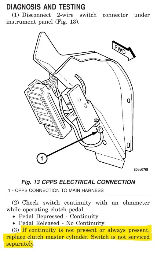

1) Clutch Safety Switch. This weekend I was able to get in some more time troubleshooting. I separated a connector leading to the clutch pedal position switch and checked for continuity with the pedal pressed down. As the pedal cycles from 'released' to 'depressed' I should have seen a transition from 'no-continuity' to 'continuity'. Instead I read intermittent continuity with the pedal depressed, despite repetitive cycling of the pedal. In order to remove the clutch pedal position switch from the circuit, I installed a fuse into the position #20 in the fuse box to “simulate” an automatic transmission and bypass the safety—the Jeep started right up. Given that it started i'm caling the ignition switch good.
Is there anything else you recommend I check prior to replacing the clutch master cylinder?
Reactions: JGuevaSkye
For anyone considering replacing the clutch master cylinder to remedy a failed clutch pedal position switch, here's some info you need to know before going to the store. The Service Manual for an '04 TJ says that for a failed clutch pedal position switch you have to replace the entire master cylinder (screenshot of passage from the manual below)
89772
However, reading this post in this forum pointed me to Dustin's YouTube video. In the video, Dustin clarifies that the clutch pedal position switch can be serviced separately. Following Dustin's guidance I pulled and tested my clutch pedal position switch--it's broken. I'm going to order a new one, get it installed, and *hopefully* I'll be able to post that everything is fixed. 🤞🤞🤞
