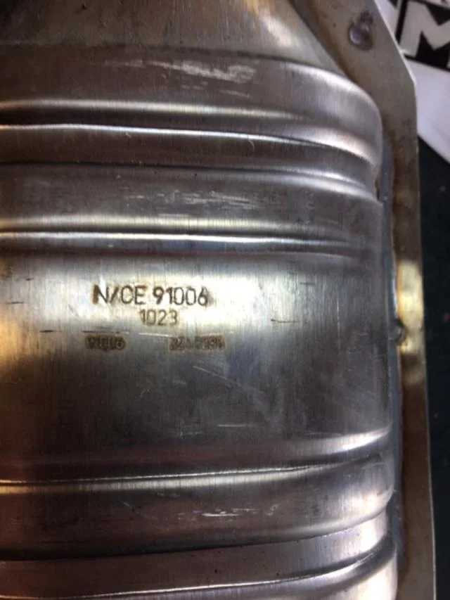

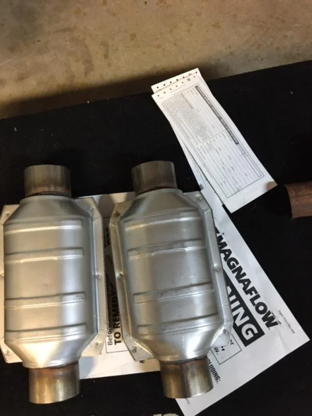

With the new muffler being shorter I have a bit of room between the back of the skid plate and the new muffler. I really don't like the location of the third cat sitting right next to my auto tranny. I picked these Magnaflow universal cats off of Marketplace for $130 for the pair. One is going on the Jeep later this week. I'm going to put it as far back as I can. I cut the two bolt studded flange off the old muffler and I am going to put it just forward of the skid plate to make the exhaust easy to remove.
