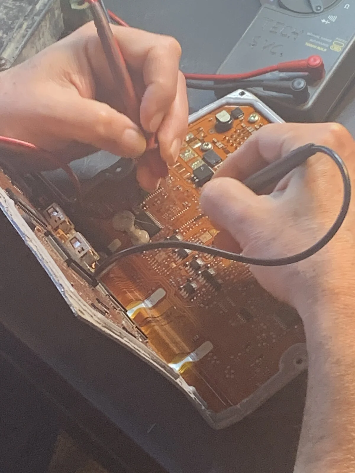

Where does voltage drop when disconnected altogether? The 5 volt pcm repair is quick and common.
I used to have to repair PCBs like that in a former life. I miss the smell of rosin-core solder but I definitely don't miss having to replace IC's (some up to 18 pins) without fawking up the circuit paths going to them lol.
Reactions: Wranglerfix

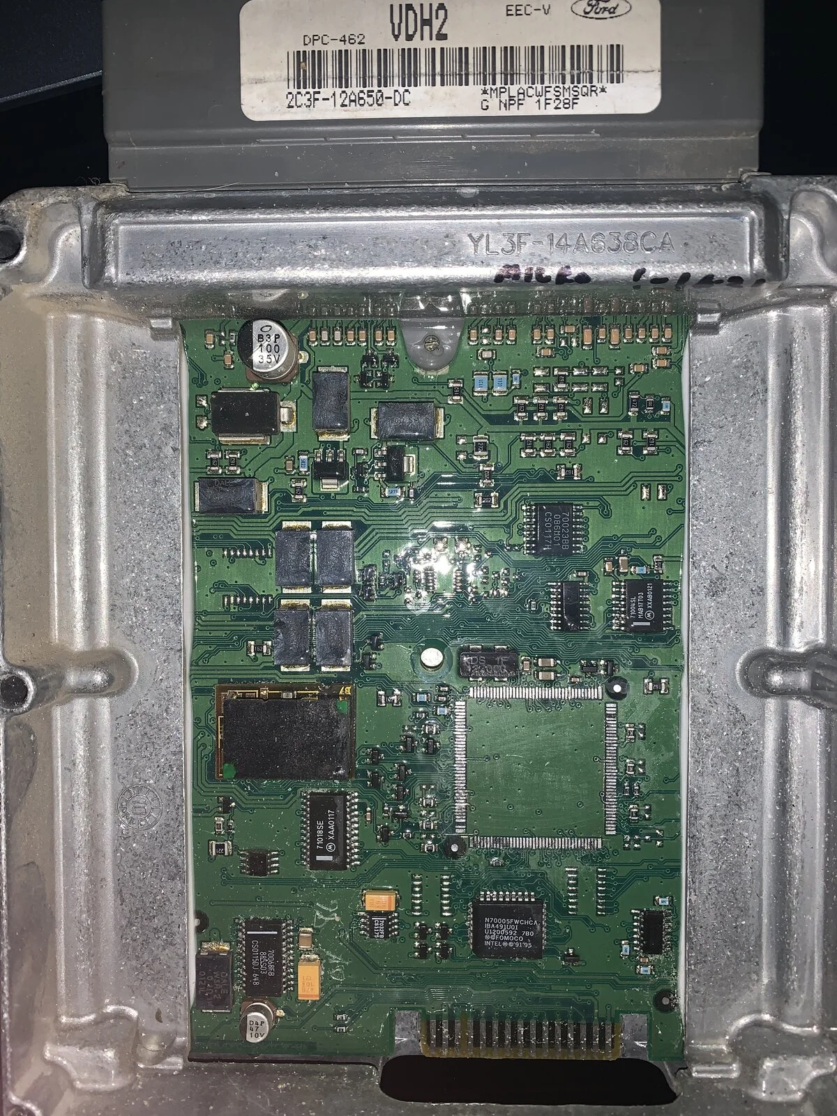

@Jerry Bransford I love the smell of rosin in the morning! 😛
The pcm below is out of a 7.3 Powerstroke with a bad microprocessor. A 45 minute repair for an expert and a core for a neophyte. I’m climbing the ladder but still the latter! 🤪
