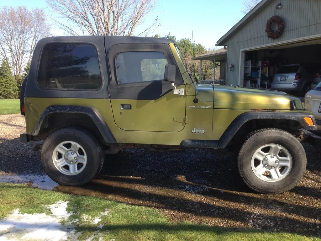

Same here . . . '97 TJ & wanted it to look better. Since it needed tires and the OEM 15" Jeep alloys looked lousy, I picked up a set of stock JK 16" rims and wrapped them in LT245 tires. I just finished adding 2" budget lift pucks.
In retrospect, I should have gone with only a 1" lift in the back.
