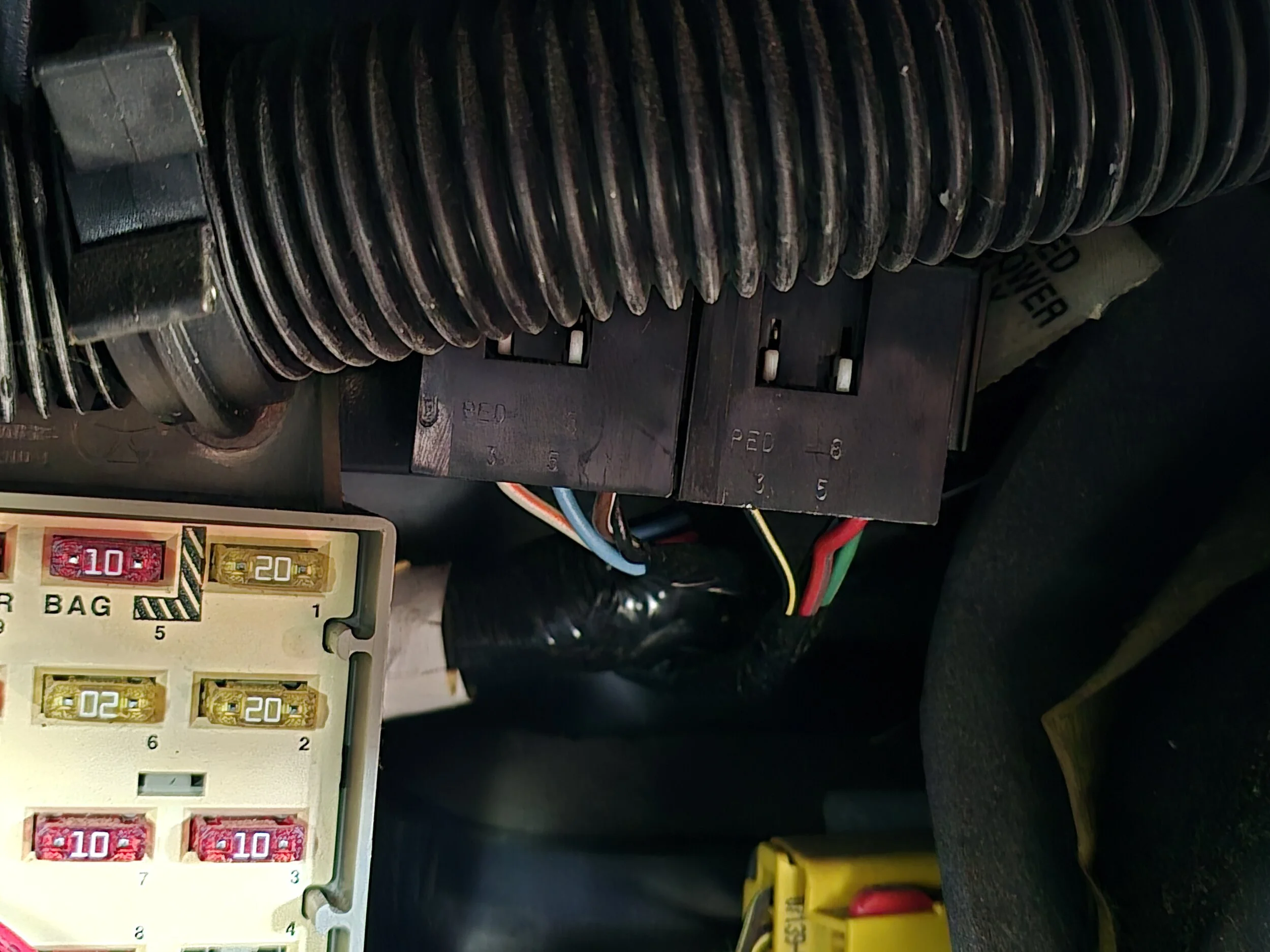

I got a pair of OEM fog light switches and pig taigs for my 2000 to use with auxiliary lights. I'm trying to figure out the wiring colors. I've looked at a couple wirong diagrams but the colors aren't the same as listed. Anyone know what each color is for?

Black is ground for the switch lights.
Orange is for dash/panel lights.
Blue & purple are your circuit wires.

That's what I was thinking. Does it matter which wire power comes in and out on the blue and purple wires?
Aren't these relays the factory fog light relays? If so, where would I find the wiring harness under the hood? There is nothing in the fender wells.
