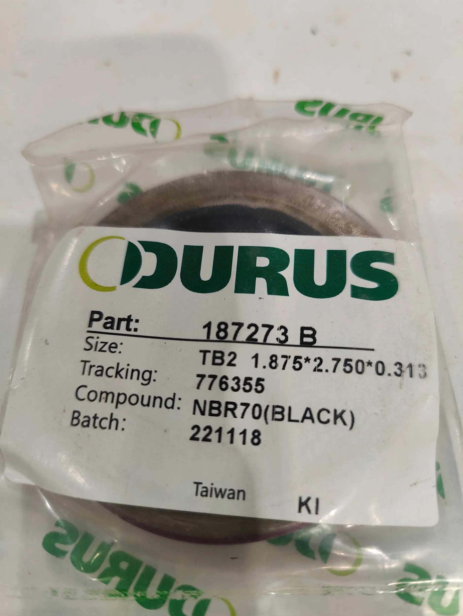

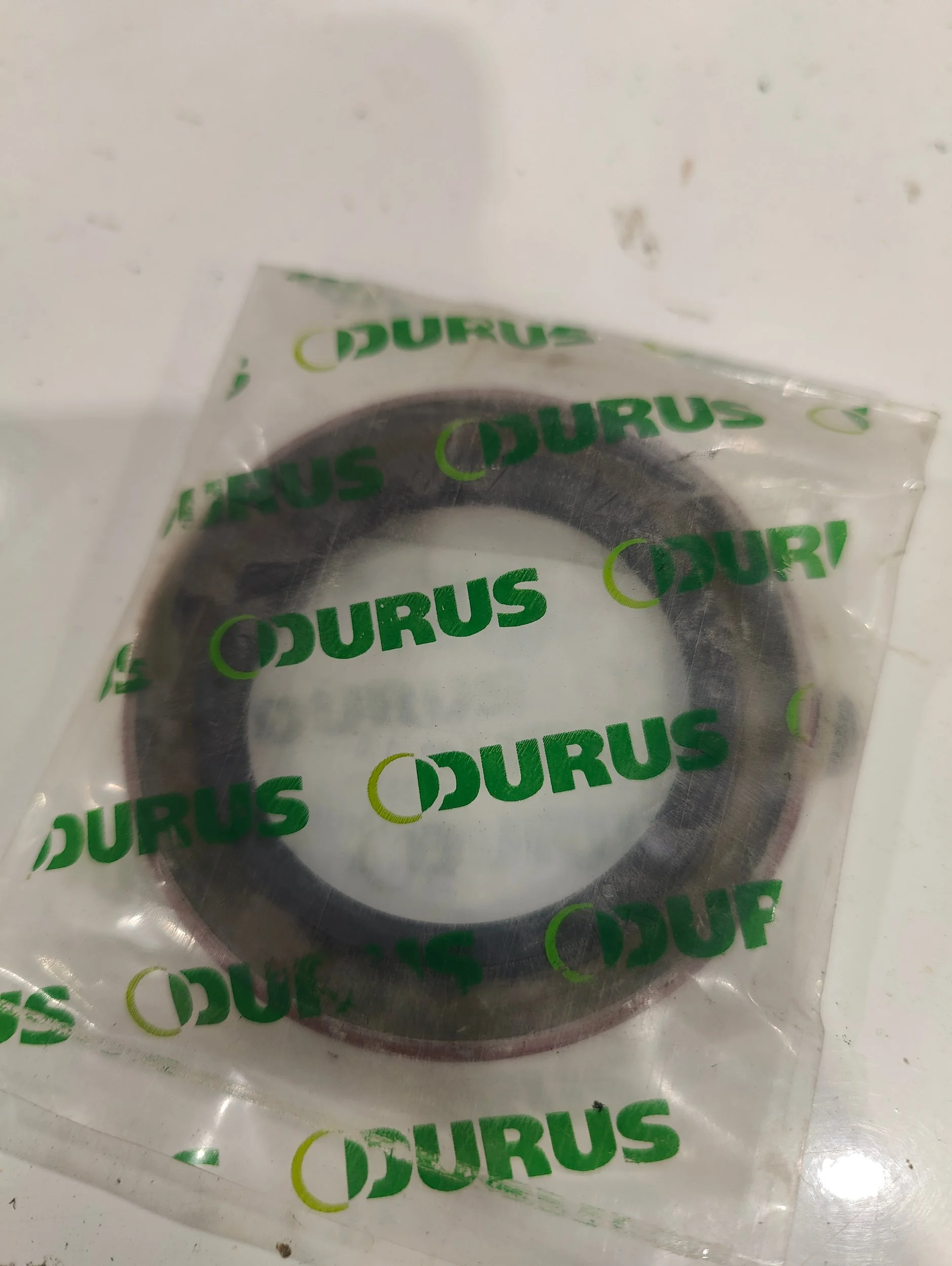

This is what my local bearing shop gave me. Haven't installed it yet because I might just replace the transfer case...but if I did that I'd be moving over the SYE...
