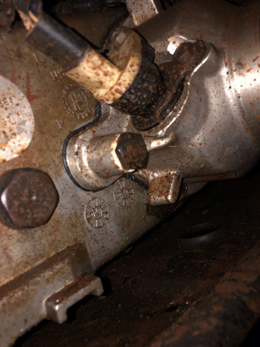

HI everyone,
Let me start off by saying that I have searched up and down for some kind of definitive answer for this but only ended up with conflicting answers.
So I have a transfer case leak that I am pretty certain is coming from the rear output shaft seal. One of the prior owners installed a SYE kit that I believe is a rugged ridge kit (mainly because of the green seal) pics below. I’d like to avoid buying another RR seal because it appears everyone believes they are terrible.
So my first question is if anyone can help me identify which SYE kit I have for sure, or does that even matter when it comes to getting the correct seal?
My second question is what is the preferred/ best seal for my application? I have came across several different suggestions, with some oddly looking very different than others.
The one on my JB Conversions super short SYE is also green. There are multiple manufacturers. Just pick up any output shaft seal you can find for a 231. With that said, your output shaft doesnt appear to be leaking? I would clean up the transfercase best you can and then look for where the leak is coming from
Yea I know it doesn’t look like it right now... I had to let her sit for a little bit while I delt with some other (more important) financial endeavors. When I noticed it though the whole rear axle and gas tank skid plate were covered in fluid. Also fluid was slung around all over onto the muffler etc; exactly where the output shaft comes out/seal is. I really can’t think of what else it could be.

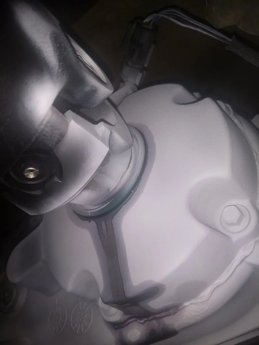

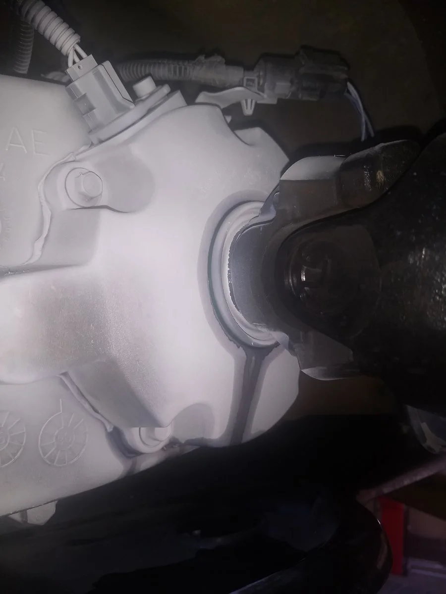

I am dealing with the same issue on my JB Conversion SSSYE. To find the actual leak, Clean the transfer case with brake cleaner, blow the area dry with an air hose, then take a can of spray body powder (Goldbond) and spray the area around the output shaft and anywhere you think it may be leaking. Drive it around at highway speeds and it will show where the leak is. Mine is leaking around the outside of the seal around the output shaft. The seal they use is a green seal also.
Very good info and idea with the spray body powder! Never thought of that one before! You may or may not be able to solve your leak by re-cleaning it with brake cleaner then “mushing” a bit of high temp RTV in between where the housing and seal meet. If you do install a new seal, be sure to add a very thin coat of rtv on the outer edge of the new seal before installing. Also liberally (but not overly so) the shaft and yolk splines and put rtv under the rubber star washer.
I have already pulled it apart and put the new seal in. Yes I did put the RTV around the outside of the seal. Hopefully it will work.
