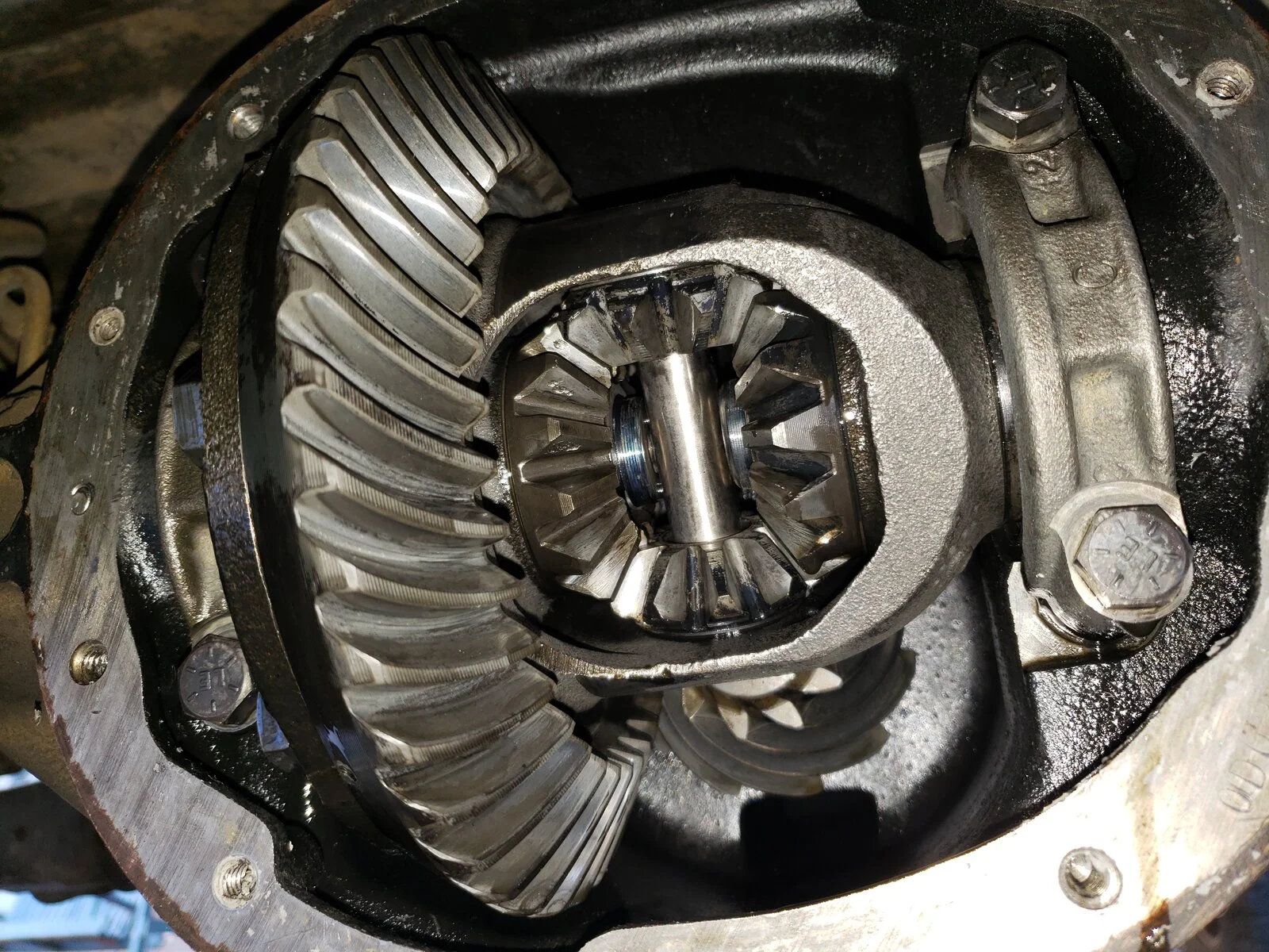

Ok good news! Got the rear wheels up off the ground & started rotating & the sounds seems to be the right rear drum brake dragging or something. Dropped the rear differential cover & looks fine to my eyes. So good opportunity to switch to conventional 80w-90.

Its not perfect by any means but for 20 years old & 127k miles I think its ok. No big chips or pieces in the gear oil, just fine particles. But this is my first Jeep so I'm not really sure? Have changed the gear oil several times since I've had it. (@ 71k miles)
