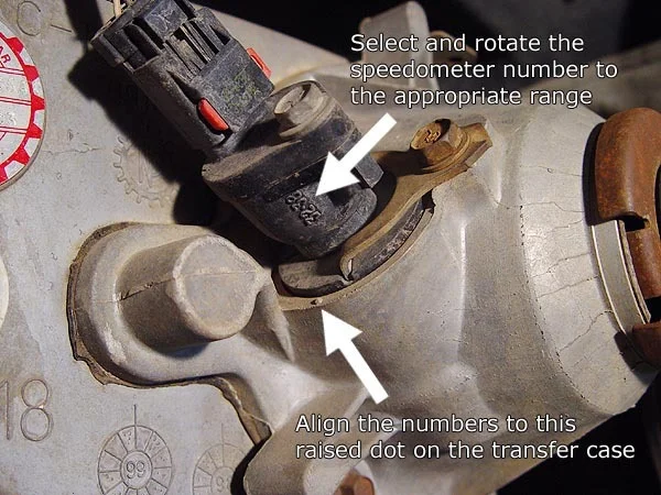

Question. I need to change my speedo gear due to my 33" tires. I have 2005 tj sport with 3.73 gears. I bought a 31 tooth speedo gear. I've installed it and I don't get anything. I lined the correct numbers up with the bolt hole like I seen on YouTube. I've seen on YouTube 2 videos one says line the numbers up to the bolt hole and the other says point the numbers down to the 6 o'clock position. I returned the first 31 tooth gear thinking it was bad. If I put the old gear back in it works but my speed is off. Now my question is which is correct?

Align the numbers that match your new gear with the raised dot on the housing.
The gear you bought wasn't bad, you just didn't rotate the speedometer gear housing quite enough for the new size gear to be able to engage its pinion gear down inside the transfer case. Aligning it like that video showed just got it close, not close enough. The speedometer gear housing is on a concentric so as you rotate it, it moves the speedometer gear in/out as needed for it to engage the speedometer gear.
A 31 tooth gear is the correct choice for 33" tires and 3.73.

Turning the housing has nothing to do with adjusting the speed reading, it only controls engagement of a particular sized gear within the marked range.
Ok so I bought the right gear for the size tires and gear ratio. What would you suggest to do?
There is no options for adjustment other than the number of teeth on the speedometer gear. I'm not sure which direction (up or down a tooth) would get your speedometer reading faster.
When I re-geared to 4.10's for my 33" tires almost all of the charts listed a 35 tooth gear. Turns out my speedometer was still off and I ended up swapping that out for a 36 tooth gear to get it right. I just can't remember now if it was reading fast or slow.
