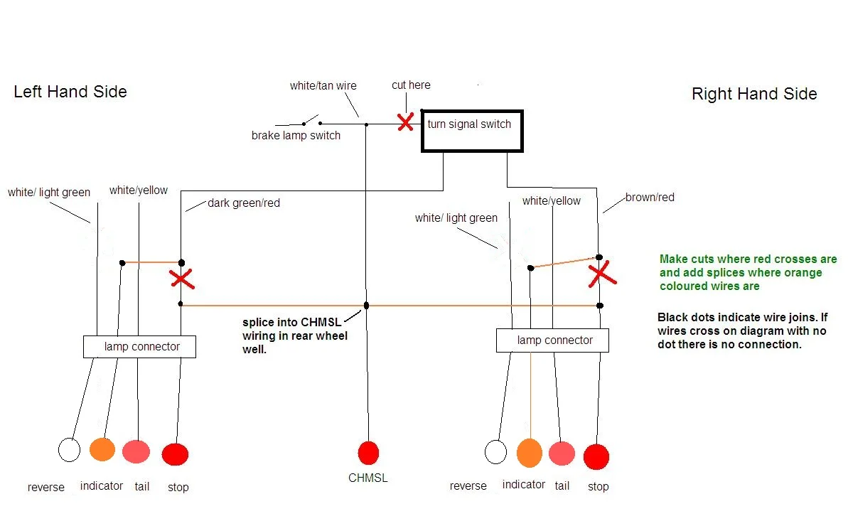

My post near the end of one of those threads shows the connections that need to be cut and spliced.
The brake lights feed through the turn signal switch in the US to make the red turn/stop filament flash.
Cutting the brake lamp switch feed near the turn signal switch Isolates the turn signals.
The center brake lamp wiring then has to be spliced and fed to both sides to feed the new separate brake lamps.
The cuts shown near the rear lamps were due to standard UK/EU lamp units being fitted. you will just have to match the wires to your LED lamps.
If your wiring at the rear doesn't match the colours shown in my diagram, let me know what model year your LJ is and i'll check the colours you should have there.

If you are changing the wiring to fit export lamps with amber turn signals, the wire from the brake lamp switch to the turn signal switch should be cut near the turn signal switch. This means the wire running to the center brake lamp stays intact.
The rest of the cuts and splices are made near the tail lamp connectors in the rear of the Jeep. The center brake lamp wire can be tapped to supply the brake lamp feed to either side wherever you can best access it. The wire drops down in the rear left corner of the tub with all the other tail light wires, and runs acroos the rear to the two center brake lamp buttons in the right wheel well.
