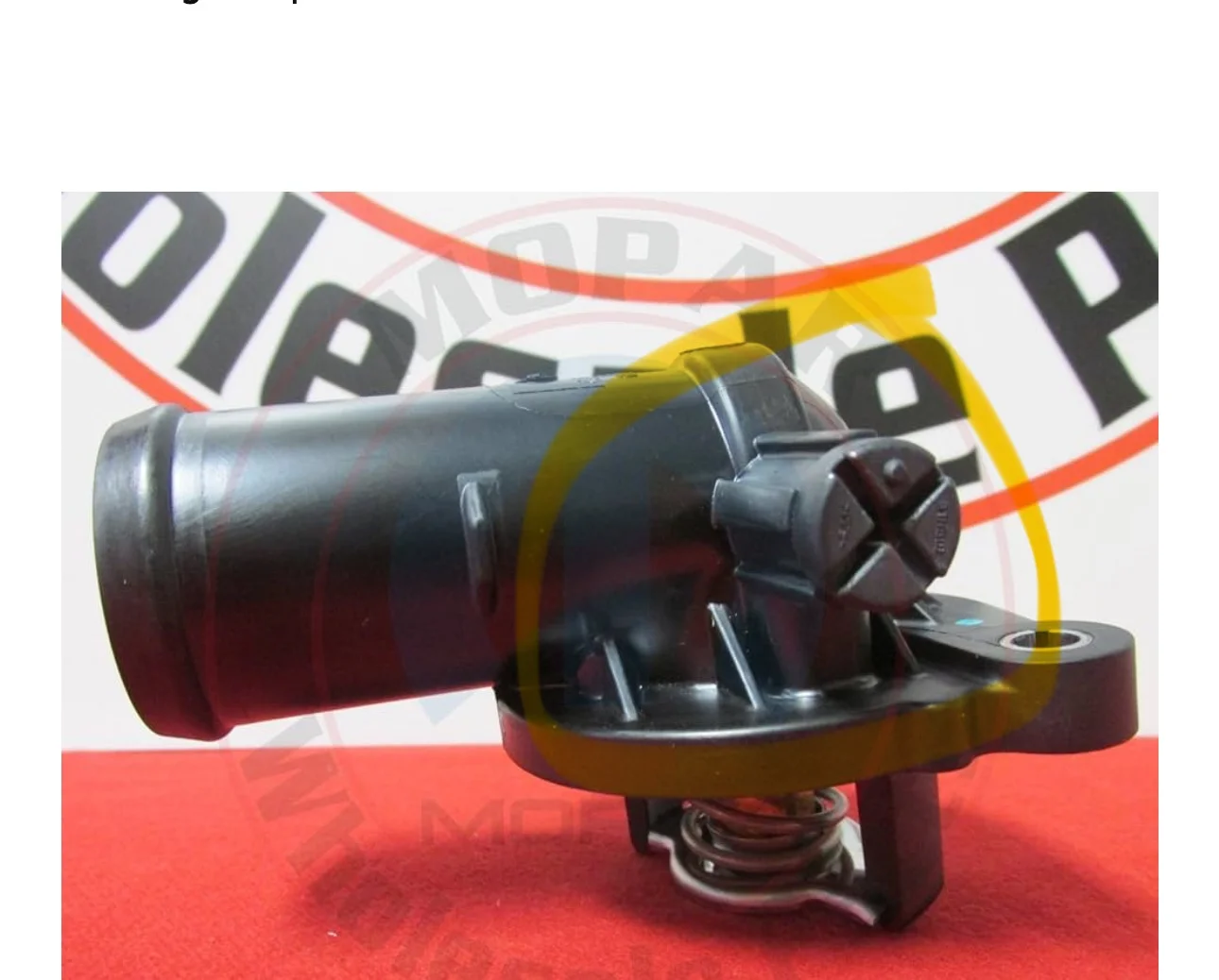

That said we have several JK’s in our family. The 3.6 is difficult to burp (getting all the air out). I recommend by starting with elevating the front end about 8” and loosening the radiator cap and go out a check it every now and see if the level has dropped. You may need to run it a little bit with the heater on a couple of times. Some people use a funnel to assist (which have) but on the JK forum there are mixed opinions about using them. I don’t think it’s absolutely necessary but I do think it makes it a little easier. There is also a screw hole in the t-stat housing that can be unscrewed to let air out, see picture. Check the fan, if memory serves correctly it kicks in at 226 degrees. Then I believe there is a high speed but I don’t recall the temp.
In addition seems like most people have issues with t-stats that are not OEM.
