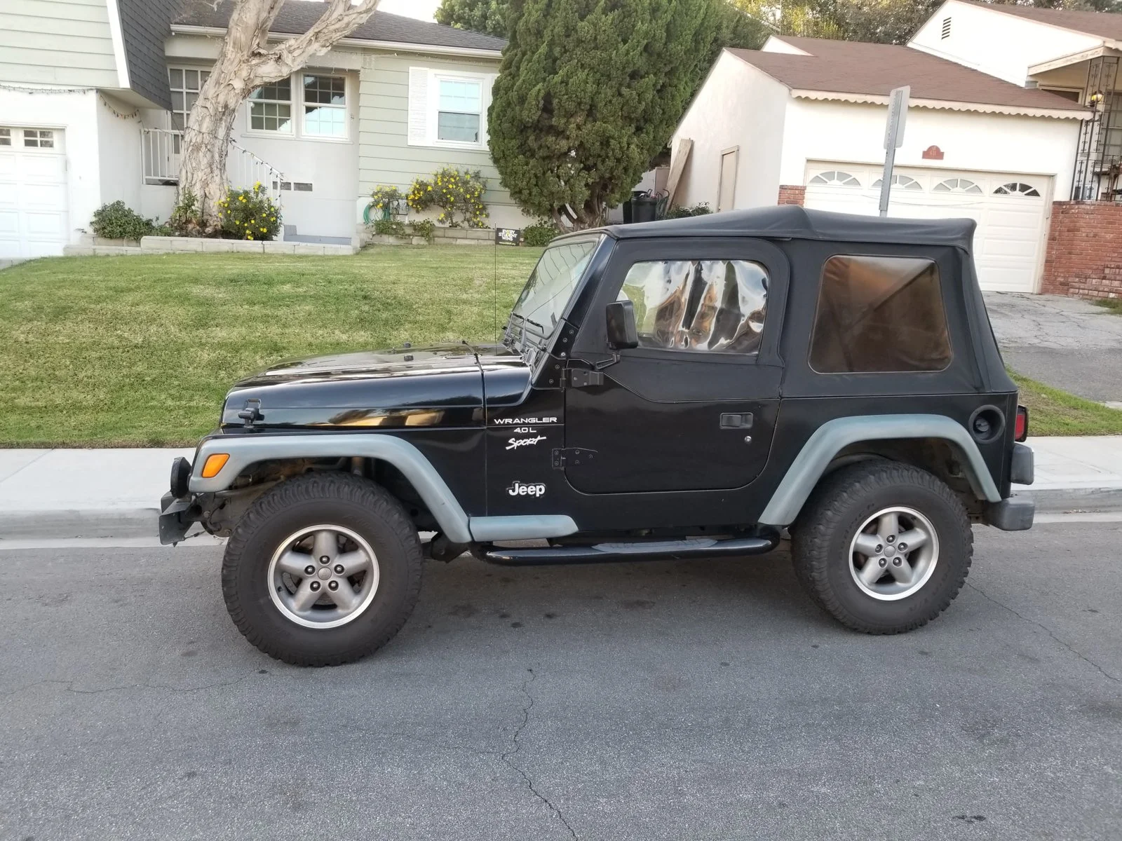

Looking at a set of 265/70R17 tires to put on a set 17" JK rims and I'm going to use 2" spacers on the back. I was going to use stock 255's as all the threads on this say a 2" spacer and 255's won't rub. But I found a deal on a new set of 265's - Goodyear. Just not sure if they will fit without rubbing?
This is on my stock 99' TJ. The old (and I mean cracking old. lol) tires are too big and rub. From the PO. Also anyone know what my rims are off of? They're Jeep rims. But I've never seen them on a TJ before in pics.
And yes, I'm doing bed liner on the disgusting fender flares. I think this is the worst case of sun bleaching on a set of flairs I've ever seen. lol. Should look really nice once it's done.
I think you'll be ok with 2" spacers. I had a slight control arm rub with the 255/70R17 mud-terrains with 1.25" thick adapters and a 2" lift.

Did your's decrease the turning radius with the 1.25 spacers? I wish I could have gone smaller. But at the time I could only find guys running 2" spacers and not having their turning radius limited. Since I've read a couple that used 1.25 and 1.5" that worked without cutting the turning radius. What I mean by that is the tires hit and start rubbing before you turn all the way to the left or right.
