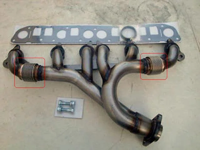

They crack due to the engine flexing the header pipes. You want a replacement header that has flexible joints added at the flex points to prevent them from cracking again. Early TJs had that problem, Jeep fixed it mid-99 with a design like below.
Look for something like this...
I’ve had three sets of aftermarket ones with those flex joints that still cracked. I’m sure the factory ones are much better, but the third party ones will still crack. May take longer...but they eventually will.
Yeah some still will, it always pays to thoroughly read the reviews before making a decision.
