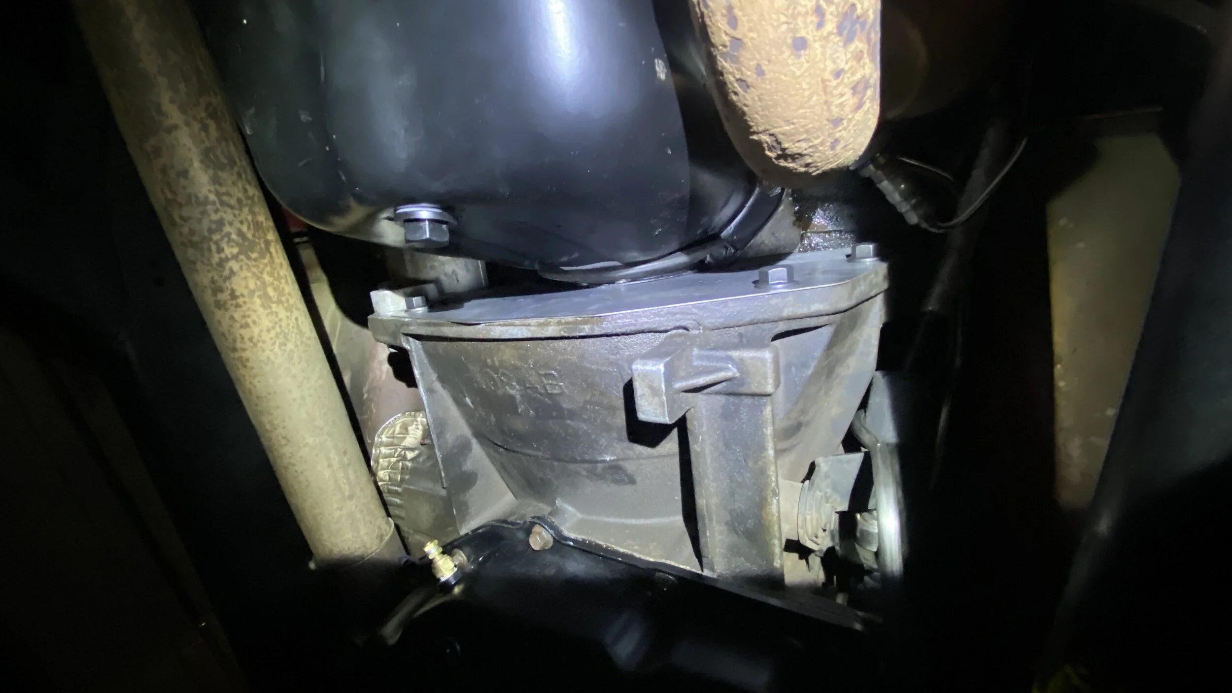

Yes, as JMT stated there's an small access panel between the back of the oil pan and the lower front of transmission bell housing you'll need to remove so you can get to the four bolts. The bolt heads are on the motor side of flex plate and you'll need to rotate the engine to access all of the bolts. Do forget to disconnect the battery!

Pic of the lower access panel. 3 bolts
